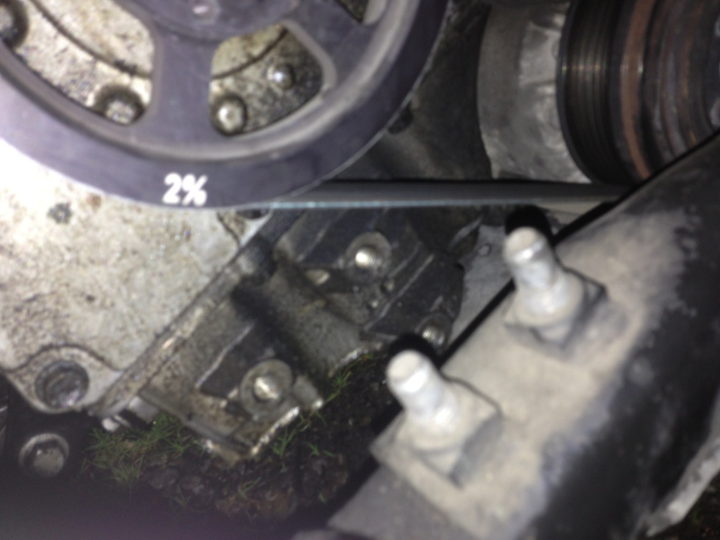

Not all lightweight crank pulleys are oversized....some ARE stock diameter. From how the belt is fitting....it sounds like a stock sized one.
Could be a good thing IMO....19% are OK when driven like a granny...but pushed hard...they tend to have issues...fuel cutoffs...codes..etc...17% has proven to be fairly safe...good for most daily driver cars with occasional redlining.

i do have a 2% increase, the belt i have been running doesnt even show any tensioner holes and heres a pic of my crank pulley which i just took.
i have a friend that is running a 060532 on just a 17% pulley, and he is having no belt problems, he is also using the alta adjustable tensioner and again, no problems. i will be buying a 060535 and installing it tonight. im currently running a 060539 which is what everybody believes is the proper size for 19%
heres the pic of the crank pulley
