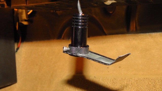

I bought 2 "puddle" lights w/Mini logo. I decided not to mount them as "puddle" light on the door but as front courtesy lights. They light up only when the doors or hatch are open. The lights cost $12/pair on ebay (includes a hole saw). I would recommend Gen4 or 5 versions because the they are smaller in size. I fabricated a mount bracket using a 3" x 1" - 1/16 sheet metal strap with a hole at one end (created with the hole saw). I used double sided tape to mount the bracket under the dash. On the 1st Gen MSC, I tapped into courtesy light power connector that is conveniently located inches from the mount point.

View of the passenger bracket with the mounted puddle lamp. I used 1/16 sheet metal so that it is bendable after the final mount. This allows you to re-position and aim the logo location. The passenger side bracket should have a bend as shown to facilitate the mounting. I used a straight bracket and a bit shorter on the driver side.

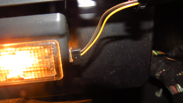

Pic #3
This this courtesy light where you can tap in for the power source. The brown w/black stripe wire is the ground. Connect the black lamp lead to the ground wire.
FYI, I tried to solder the lamp leads to the courtesy bulb holder but the solder would not stick.
Fairly straight and easy installation. It really looks cool when the lamps fade on/off.
Enjoy
