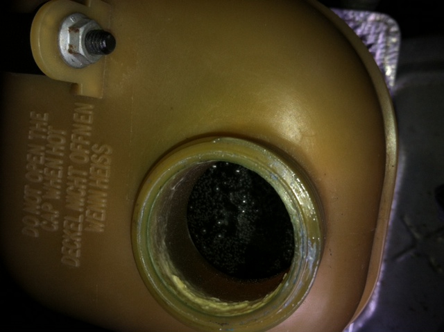

Here's a pic of the coolant reservoir cap. The center of the cap was really caked with it, it's brass color behind the plastic.
I can't believe there's no water in the crank case, but thank goodness. Runs strong, and not using coolant or oil. Oil and water temps remain normal according to stock chrono-gage
After cleaning the cap with a paper towel, a little more of this white residue appeared the next day.
Here's my question, can I / should I flush it with this Zerex Superflush? It says Quickly flushes accumulated sediment and corrosion
Restores cooling system efficiency by removing light rust, scale and oily residues. - Zerex® Super Flush, with its powerful patented cleaning agents, restores cooling system efficiency by removing rust, scale and oily residue in just ten minutes. It can be used on all cooling system metals including aluminum.

Are you sure that's not just dried up coolant? You know coolant becomes chalky white when it gets heated and dries right?
Coolant and oil become chocolate milk colored so I don't think you are dealing with a head gasket at all.
Pics = thousand words what you are showing is dramatically different than described in your post.
At any rate used distilled water to flush..it's the least likely to do harm.

Flush and monitor....thats a pretty small amount of anything.....could just be from weird mix of different coolant brands/types....
Of note, you can also get coolant at the bmw dealer...same as mini...the zerix-g-05 can be hard to find....but pepboys is one chain that does carry it.
As i said, enjoy your car,don't go crazy a flush might be ok, but a good drain and fill is fine most of the time if you are certain of the radiator content. The extra chemical flushes are mostly to dislove minerals from folks having used tap water.....so if not clean out, can be an issue (the chemicals). Since the mini radiator has no drain, or inlet, just hoses, it can be a pain....
I just drop the lower hose, drain, add a new hose clamp, and close back up when done. The bleeding is a bit tricky, but doable...just have spare coolant...you will likly loose a halfgallon or more waiting for bubbles to get out. As said, mix coolant with distilled water or buy premixed 50/50 coolant.
Frankly the acids in a flush mix get me nervous....if you can see tons of minerals, it might be needed, but unless you are careful, you could do more harm than help.

Well, let's hope it's dried coolant. It just looked more like mayonnaise than chalk dust, but maybe it's damp dusty stuff..
Anyhow, thanks to you guys for your replies. I'll skip the chemical flush, I'll just fill and drain distiller water through it a few times.

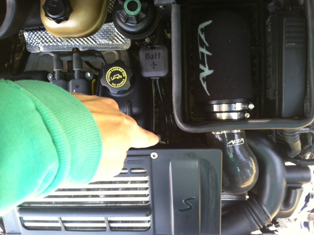

Here's my question for the day: there's a vent/bleed bolt in a fitting for a 1" heater hose that's kinda just above the bell housing beside the head under a bunch of wires. Looks like I'll need to get a longer extension to reach it (at least a foot), and maybe a swivel socket would be good.
Anybody know what size socket I should buy? 6, 7, or 8mm I'm guessing. I can barely see it, let alone reach it to test fit a socket.
Maybe I should removing my CIA would give me slightly better access?

To follow up. The best notes I found (as I still haven't bought a real book) were here https://www.northamericanmotoring.co...00-post47.html And also here. http://www.pelicanparts.com/techarti...ant_Change.htm
Being a MINI noob, I came across the dilemma of where to put the floor jack. Yes I see the four pucks where the jack stands go, but I then need a different place to put the floor jack to lift the car high enough to place the jack stands. I can't seem to find it now, but I found threads on cutting a 2x4 to length between the jack points, put the floor jack in the middle of that. You'll see the seam where the metal folds together under the plastic side skirt. The wood spreads the weight along the length of that. It worked, no broken plastic, and no bent floor boards. I had been thinking lift the front then the back... With MINI I guess it's lift the left side, then the right side.
I'm pleased to say that I find MINI no more difficult than any other car I've worked on (Alfa Romeo, Fiat, VW aircooled, VW watercooled, Honda, Ford) just looks intimidating, because everything is packed so tightly in there. Pelican parts instructions said extend the front bumper out to have easier access to lower radiator hose. I found this unnecessary. There are a handful of screws to remove the two plastic panels on the underside of the bumper and undercarriage of car. Seemed simple and easy. I assume the other is closer to the instructions for putting the car into service mode (as in the sticky on here). Seemed like way too much work, and I had LOTS of room to reach in with pliers and squeeze the hose clamp.
I'm surprised that it didn't say to turn on the heater first, and even more surprised at myself, cause I know better, but I'll get back to that. For me, the most important part was to get ALL the old coolant out. Should be a little over a gallon and a half (6.3 quarts if I remember the exact amount).
Pulling the lower radiator hose alone, gravity gave me about 1/2 a gallon. Using a very old and tired 2.horse wet/dry vac I pulled another 2 quarts out of the engine through the lower radiator hose. Well, I had two thirds of it out, and I also had 6 gallons of distilled water. Gravity can do its work here.
I poured 2 gallons through the coolant reservoir, and also removed the upper hose so that I could pour a couple gallons through the radiator. 4 gallons later, everything coming out was clear water.

Mission accomplished I thought.
My poor old vacuum gave up its ghost, and I wasn't able to turn it on again to get all the water out of the block; though I had not really thought about how much water was in there till all the hoses were reconnected, and I found I could only add 2 quarts and it was full.
I had already mixed my gallon of Zerex G-05 with distilled water 1:1 or 50/50 I decided to let the car warm up, so the thermostat would open, then let it rest for a while, drain it, and repeat this process till I had used all of my remaining 6 qts. of 50/50 mix. It was good practice to bleed it too.
I knew the thermostat is beginning to open when the upper hose got warm, when coolant comes out with no bubbles from that bleeder, close it. Watch the level in the coolant reservoir closely, it will drop a lot, fill it again, but don't over fill it. Let it run some more, and 5 or 10 minutes later, you'll see the coolant level in the reservoir rising, put the cap on. Let it run another 5 minutes. BTW, the heater should be on high, with the fan on low all this time (and probably from the beginning). Once it's good and hot, turning the heater fan on high, and hitting the a/c to run the low speed fan brings the needle down below the 195f mark in only a few minutes. Turn off the car.
I had lunch, and rotated the tires. The outside temp was probably 70f and it was obvious to me that the hour I waited for it to cool was more than enough When I undid the lower radiator hose, more green came out! (the Zerex is not green). Not sure if this was behind the thermostat or in the heater core, but in the end, I think I got all that crap out. (I would have been less worried if it was blue, but I dunno what it was, and it looked wrong, dirty, lots of little bubbles on its surface, and my cap kept getting some kinda residue on it) I also think more came out when I drained it semi warm the second time.
I poured in a total of 7 qts. Of my 50/50 Zerex, (and inadvertently recycled at least 1qt of it). My cap is staying clean, the coolant level stays full, and it appears to be all the right color of the new that went in. I need to check the chemistry I guess, adding some pre mix, mixing it around with other stuff in the engine, draining some out, then adding some more premix is certainly less than ideal. As to the last question I asked you, the bolt is 8mm, but swivel socket is not needed. Also I found much better access (or at least vision) by temporarily moving the big hose that goes from the CAI to the throttle body, so that I could remove the silencer from under the air filter housing. I did my warmups without the silencer, but of course had the air filter reconnected to the throttle body.
Next time, I'll get my real wet vac back from my sister before I begin (4.5 horse). Run the car with the heater on, then let it cool just a little while I jack up the car, get tools ready etc. Drain, vacuume, fill with distilled water, bring car to temp, bleed, cool, drain, vacuume, THEN fill it with 50/50 mixed coolant. Here's a pic of the dirty, filmy on the surface looking green coolant I replaced.
At this point (4 days later) I feel confident it definitely was not a head gasket problem. I don't have the tool to measure the chemistry... Is it the thing I've seen that it like a big bulb syringe with little ***** that float ad different levels??? Is it expensive? Do you think its fine as is now? Should I drain the whole thing and start over? Maybe if its weak, I could remove some from the reservoir with a turkey baster and add a little straight coolant???
