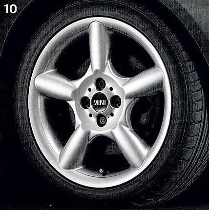

So depending on the end of my auction of BOO...I will be upgrading the wheels and junking my 17 inch black GP/clubman mini wheels..
I have a line on a set of these R110 Silver Pace wheels with run-flats and with TPMS....Will these fit on BOO? She currently doesn't have TPMS in her wheels now, but has the little button on the interior side....According to mini site, the R110's are 17 inch 4 X 100 with a 48 offset.
Or should I just go to a wheel shop and buy a custom set of (non-BLACK) aftermarket wheels for about the same $$$ and just get my new GY Eagle GT's put on them.
Thanks for everyones help

Yes they will fit, but the sensors won't be needed on Boo. As far as buying new custom wheel instead is your choice. I would get a lighter set IMO. You be amazed at how different a lighter set of wheels makes on your MINI.
