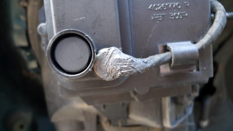

My previous '04 MCS had some insulation worn down to where you could almost see the wires in a few spots, most commonly the headlight wires where they rest against the front hood seal, as well as a couple other places. That car is sold and gone now, but I learned a little from it..
I just picked up an '03 MCS, and noticed a few of the same worn spots. So, I decided to do a little preventative modification..
IMPORTANT:
1.) If there are any ACTUALLY bare wires, please disconnect the positive lead from your battery before touching them.
2.) Wrap completely bare wires in
black electrical tape black electrical tape
before applying RTV silicone
Supplies:
Black Adhesive/Sealant Silicone Black Adhesive/Sealant Silicone
capt_bj pointed out that Liquid Tape is a little less messy, and can be found at Home Depot near the electrical tape
Fingers (or a small spatula)
Paper towels
Working eyes
Steps:
1.) Find bare-looking wires, apply RTV smoothly
2.) Allow to dry til tacky (~30 min)
3.) Apply second or third layers as necessary
Underside of Driver's Headlight
Side of Driver's Headlight
Underside of Passenger's Headlight
Side of Passenger's Headlight
Passenger Hood Latch
And any other areas you suspect may become a problem in the future.
Hope this helps some of you, good luck!

RTV can get a bit messy - I've uses a ton over the years in waterproofing electrical connections on ships. {there is a story that cg helo's acquired so much of this stuff over the years that when one airframe was being rebuilt they made a point to collect all the RTV they removed and it was over 100 pounds!}
there's a product for this specific task - "liquid tape" - by our Plasti-dip friends.
http://www.plastidip.com/home_solutions/Liquid_Tape
At my local home despots this is right near the electrical tape and shrink tubing in the electrical dept.
