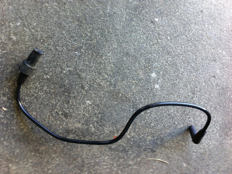

Hopefully somebody can help me with this. I am in the process of reinstalling the head on my '04 Cooper S and I can't remember where a vacuum line went. I have enclosed a couple photos. It is an open tube, semi rigid, female connection each end, about 1/8" O.D. and is about a foot long when straightened out but it has this shape to it.
Any help would be greatly appreciated.

From the bottom of the fuel rail pressure regulator to the intake manifold
Old Jul 4, 2012 | 07:42 AM
ERIK06MCS's Avatar
ERIK06MCS
Joined: Apr 2011
Posts: 272
^ +1. That'd be a vacuum line.

Got it. Thanks for the help.
