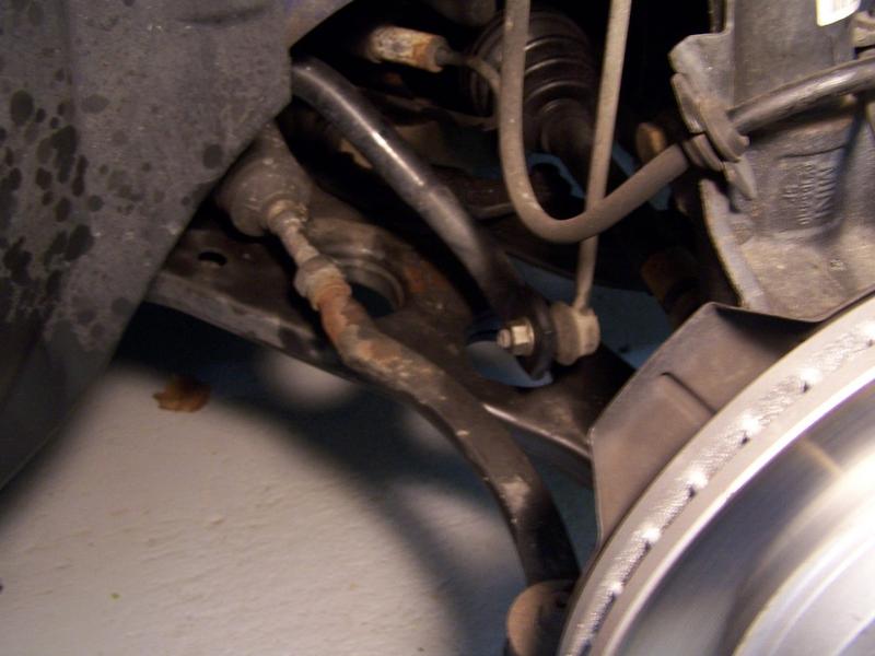

Sunday Morning I noticed a small puddle (about 2" wide and 4" long) under the passenger side of the engine. It was right below where the drive belt is. My first thought was coolant (as the coolant was flushed on Friday) but the liquid was a clear liquid with a very slight yellow/brown tint to it. I had to jack up the car to change my oil and while it was up, I saw that some of the liquid had been dripping from the far right (passenger side still) section of the plastic splash guard under the car. Well inspecting the wheel well (attached picture #1) you can see there is some oily liquid that had been spattered all the way around. I also noticed a black residue splattered on the passenger side door. Further inspection revealed more areas that had this oil on it (attached picture #2). I then removed the plastic wheel well cover to see that on the main part of the body that the engine is supported by (right below the upper motor mount) also had this liquid on the bottom of it and the blue ABS brake sensor clip was covered in the liquid.
