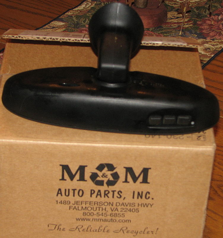

Successful install & Homelink programmed!
Originally Posted by JIM_GRAHAM
We should both post "How to's" of the installs up here for others to check out.
I just got finished installing my new Autodim mirror and programming the Homelink. I am happy to say that it all works. The mirror arrived and sat outside in 9 degree F all day, so when I opened up the box and took it out in the warm damp air of my house, frost formed on the mirror! I thawed it all out, dried it off and cleaned it up. I decided to wait a few hours before I installed it so the insides would not have any condensation.
Removing the old mirror is a piece of cake. Grabbed the base and twisted to the left and it came off. I was surprised to find it was connected by wires that ran up into the head liner. I figured this must be for the keyless entry as previously pointed out in another post. I assumed I would be fishing for the harness, but it was all ready for me. In order to remove the plug I discovered that you need to remove the "clamshell" cover that goes over the mounting base. (See pictures)
Installing the new mirror involved plugging the new one into the cable and reassembling. This is a bit tricky as putting the "clamshell" back together with a broken thumb was rather difficult. Not having 2 properly working paws was troublesome. Also, holding your arms straight out for several minutes at a time was tiresome. Getting it all back together PERFECT was a bit of trial and error. I had to take a couple of breaks to go blow off steam. There's not much room to manipulate large paws up by the mirror.
After I got it installed I took Pepper for a ride to check on the AutoDim. A BMW SUV pulled up right behind me with it's Xenons blaring and the AutoDim toned it down nicely.
When I got home I decided to program the Homelink and had prepared for the task by downloading the instructions from www.homelink.com The instructions were clear and I discovered I had to do some extra work because I have "revolving code" door openers. But I finally got both doors programmed. I have NOT tested range yet. I hope it can reach from the end of a 50 yard driveway.
This is the 1st time I have ever purchased anything from a "Salvageyard" online, and this was a success. I paid $172.00 delivered for something that was going to cost me $439 + shipping (NAM discount at Classic Mini) to purchase new. Someones wrecked Mini now gets to live on in Pepper. Kinda like an "Organ Donor"!
Attached Thumbnails Adding self dimming mirror to 2005 MCS-oldmirror.jpg   Adding self dimming mirror to 2005 MCS-newmirror1.jpg   Adding self dimming mirror to 2005 MCS-newmirror2.jpg
Thanks Jim!!!
I'll see if I can get another one of those form the same recycler. Sounds very easy to swap. I like that upgraded mod!!!

May I "borrow" you autodim/homelink mirror picture? I want to put a "wanted" ad here as well.
