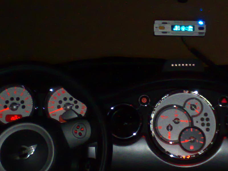

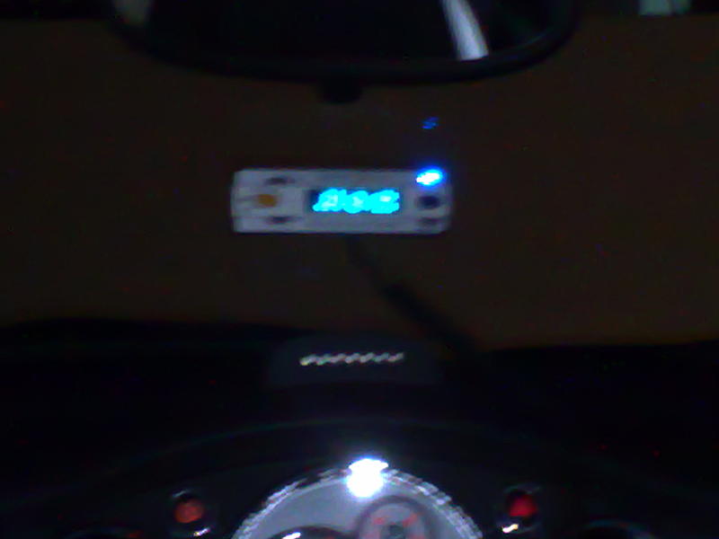

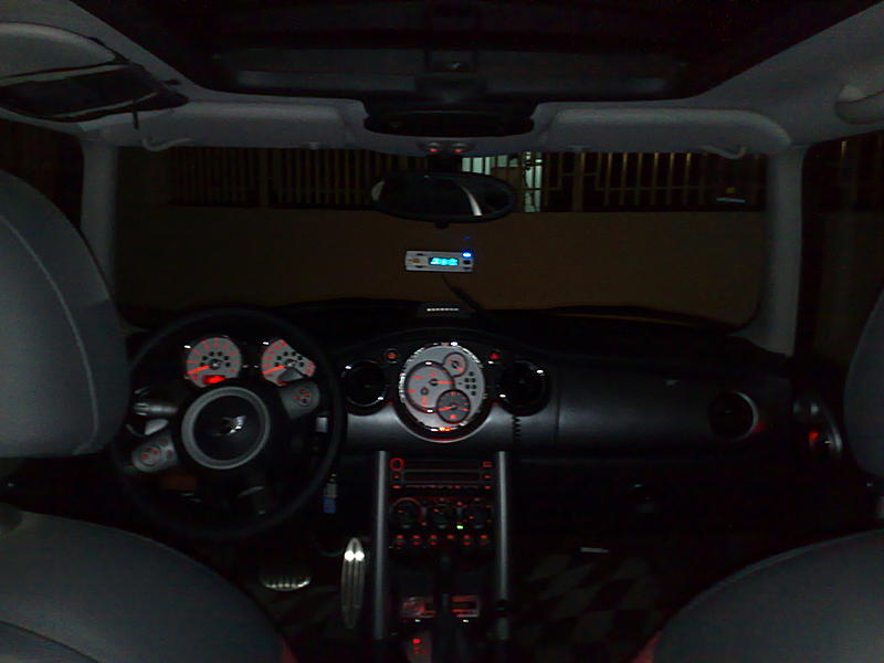

Guys, I got the GMeter GT2. I loooooooooooove this product! Check it out in the attachments
