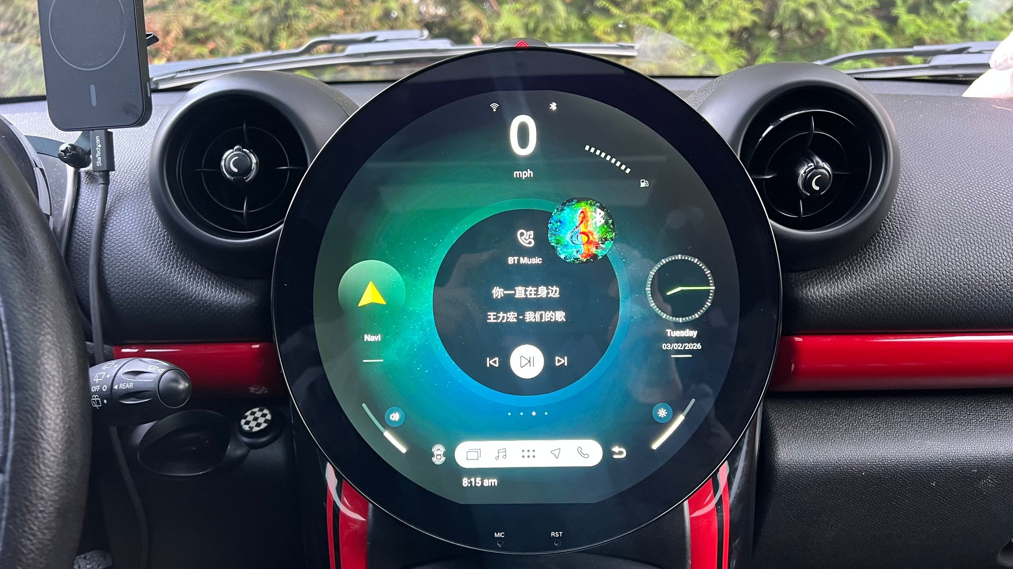

Hi all, I've recently added an aftermarket head unit to my R60 JCW, which came with HK audio. I connected the Amplifier Control cable as per the manual, and didn't use the RCA connectors. It turns out the volume is overall too loud, even turning the volume down to 3 or so. I suspect the head unit's built-in amplifier is connected to the factory HK one in this setup. Unfortunately, the unit doesn't allow to change the volume of the built-in amplifier. Hence, I'm wondering what options I've here. Do I need to connect the RCA output to the HK amp (if yes, how), or is there a way to turn down the HK amp's volume instead?
Thanks in advance!

You bought a U25-styled head unit for the R60? I wanted to ask if anyone did, as I am interested too, but I just didn't dare!
How expensive was it to buy? Does it function well? Integrates fully with the car controls? It definitely looks amazing.
It would be great if you could do a separate post with a bit of a review @jacky1019

Thanks for your reply! I just made a separate post on the HU: https://www.northamericanmotoring.co...n-r60-jcw.html. Hope you find it interesting.
