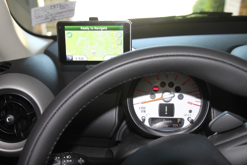

I did the same with my CM, I have Connected but no Nav.. I also got the Ecoroute HD for the Nuvi which displays vehicle info like the scan gauage on the GPS..
Attached Thumbnails Sad about the Nav/Connected-img_1401.jpg

OneFish2 and mjgood thanks for posting pics!! How difficult was it to install and hardwire?
Its very easy to do. If I can can do it anyone can.

TPBC....
I don't think the pics I put in my reply worked so here they are with a brief description of how I ran the cable for the GPS....
There is a pocket just behind the cigarette lighter, inside that pocket it is open on the top.
I ran the cord up and to the left, then behind the lower part of the dash (where the start button is) then up to where the steering column goes into the dash right behind the tachometer.
Just to the left of the climate control you will need to gently pry the plastic to make room to pass the cord through.
There are only a couple of inches of exposed cable, which is hidden by the tachometer. That part of the cable has the traffic receiver in it, which works out well for reception. The cable is essentially hidden from view....
Attached Thumbnails Sad about the Nav/Connected-img_1423.jpg   Sad about the Nav/Connected-img_1424.jpg   Sad about the Nav/Connected-img_1425.jpg
