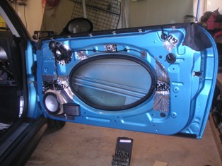

I looked at trying to do the wires in the front doors and decided to just try them out with the stock wires and it sounds pretty good.
I replaced the front speakers with Polk db6500's (6.5 components) they have a non-adjustable crossover that fits perfectly next to the speaker in the bottom of the door, just had to cut out two plastic casting ribs on the door panel (see attachment).
I replaced the rear speakers with Polk db690's (3 way 6x9).
Testing with the stock head my impression is:
Fronts sound great even at volumes where the stock speakers would break up (I assumed the break was caused by the amp). They have a broader range without being too bright (even with the tweeter mounted in the stock location).
Rears play a broader range also much better base and highs than the stock, but they start to break up at about the same volume as the stock speakers.
Overall I think just replacing the speakers would make the non-HK system sound much better provided you don't want it loud.
But I want it very loud so its back to the garage. To replace the head. I haven't decided if I will try running the speakers directly from the Eclipse CD5000 head to see how it sounds, seems like a lot of work for an experiment. But I would guess if nothing else it would give you clean sound at a little higher volume.
Attached Thumbnails Replacing Speaker wires - Worth the hassle?-door-panel-mod.jpg   Replacing Speaker wires - Worth the hassle?-complete-pass-door.jpg
