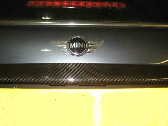

We have just installed the OEM camera in a GP & wired it to a Clarion motorised screen
Attached Thumbnails OEM backup camera I DID IT!!!-img_3595.jpg   OEM backup camera I DID IT!!!-img_3601.jpg
