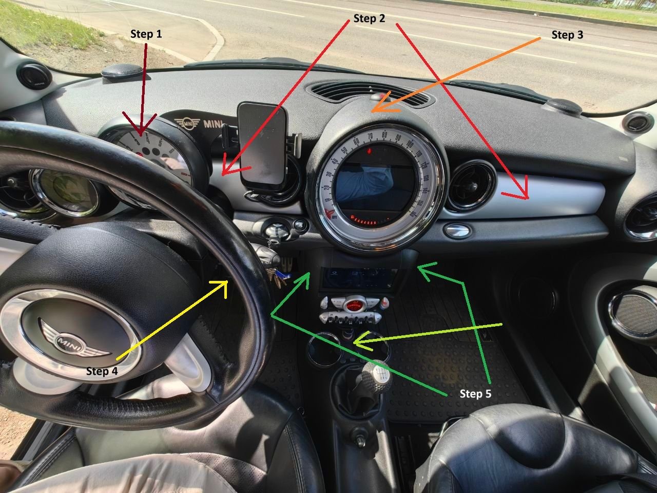

Steps to take:
1) tach;
2) 2 inserts (or just one if you have a secret glove box compartment);
3) speedo trim;
4) lower driver knee trim panel;
5) left and right center console trim panels;
6) cup holders and 12v socket panel
