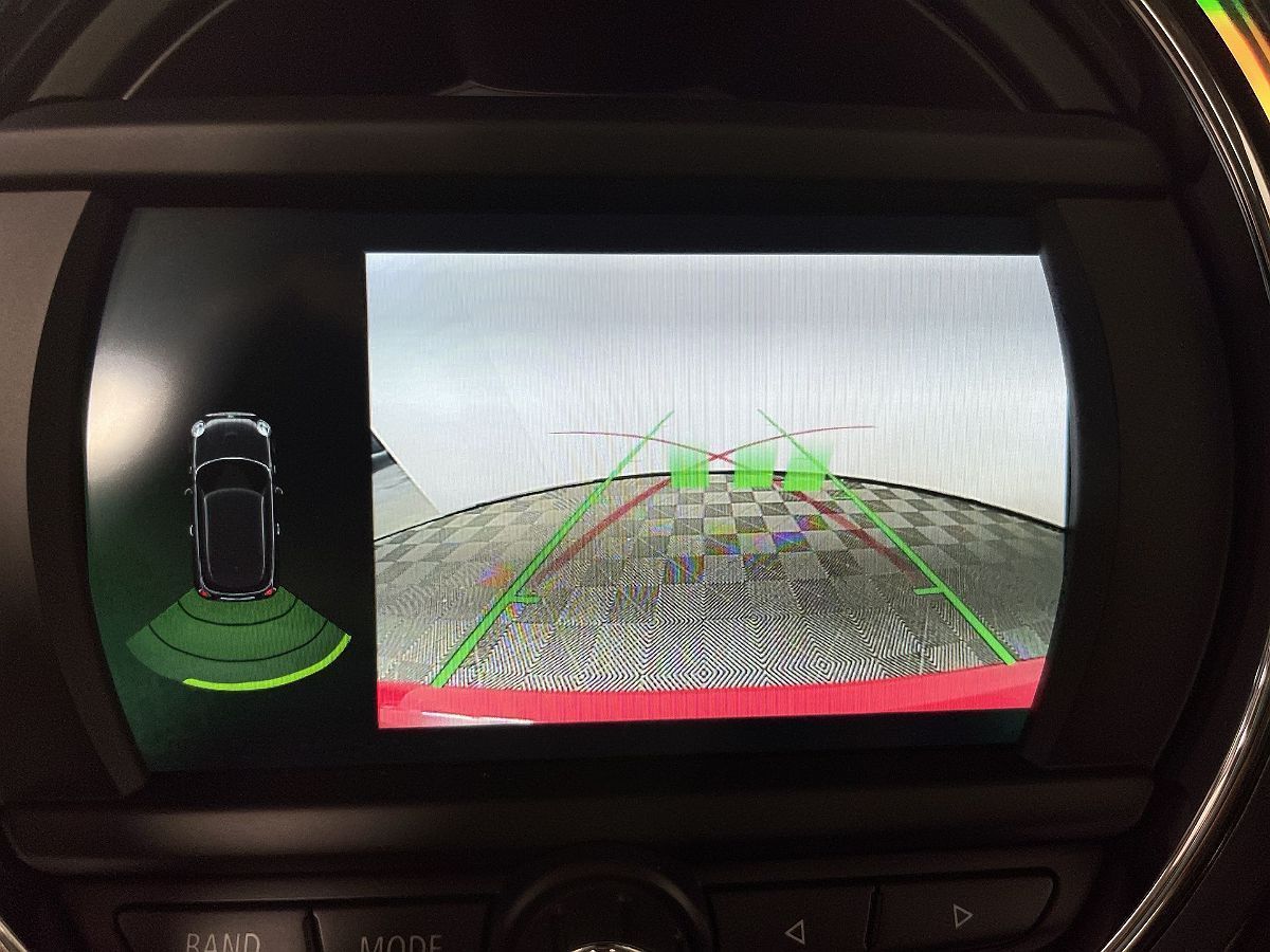

Hey all,
Just got my '19 F56 MCS. I didn't realize there was an 8.8" Nav option and mine came with a 6.5". It's 2 doors without the HK system. Looks like the screen is an NBT, but I don't know about the pre-LCI or LCI. I did talk with someone at BimmerTech and they said I have BIS01 head unit.
Is it possible to upgrade to the 8.8" screen the newer models have? Touchscreen would great and Apple CarPlay sounds like a great way to integrate my iPhone to the car. I've attached some pics of my setup right now.

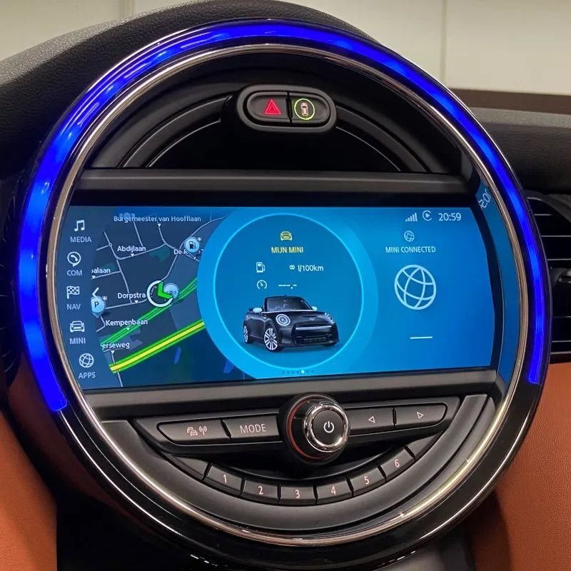

No bro! The only option is to save some money and but an evo 8.8 screen and unit! It will be a perfect fit, you could have the new interface as well and carplay full screen!

This is what you need!

Ask the seller if the unit has 2 or 4 gb ram. needs to have 4! Then it will be good! Do not buy the one that has 2 gb ram cause it’s an id4 flashed id5 unit and it has carplay splitscreen
