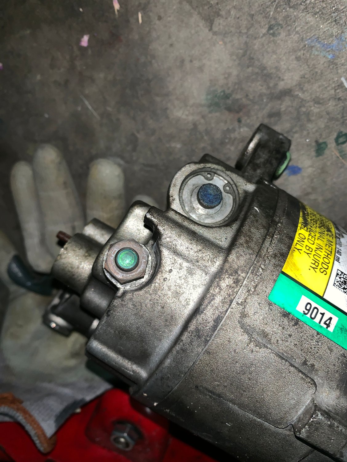

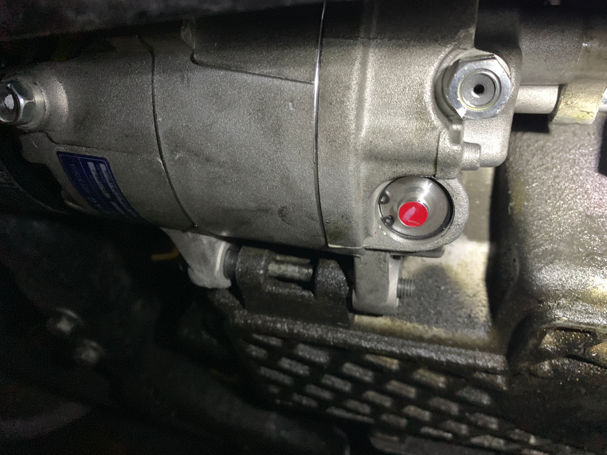

Hey guys so I recently replaced my ac compressor on my 06 MCS about two weeks ago, recharged it and did everything correctly car was blowing cold ac for a solid weekend and then this one day after work I was at a stop sign and noticed a mist of something... turned out to be Freon because after that my ac stopped blowing cold, replaced the o rings that go onto the ac hoses went to a buddy’s house that owns a vacuum and recover machine and it sprayed out Freon but I noticed there was a hole not covered by anything and I’m thinking it’s coming from their cause the machine was reading that it was holding pressure also on the my oem compressor that same hole is covered by some sort of material (will attach pictures of what I’m talking about) , any leads to what it can be or a way to cover this hole will be greatly appreciate!
