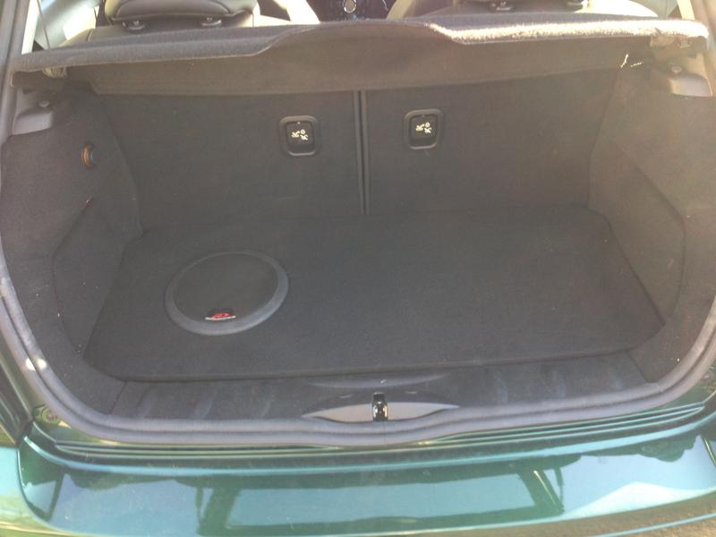

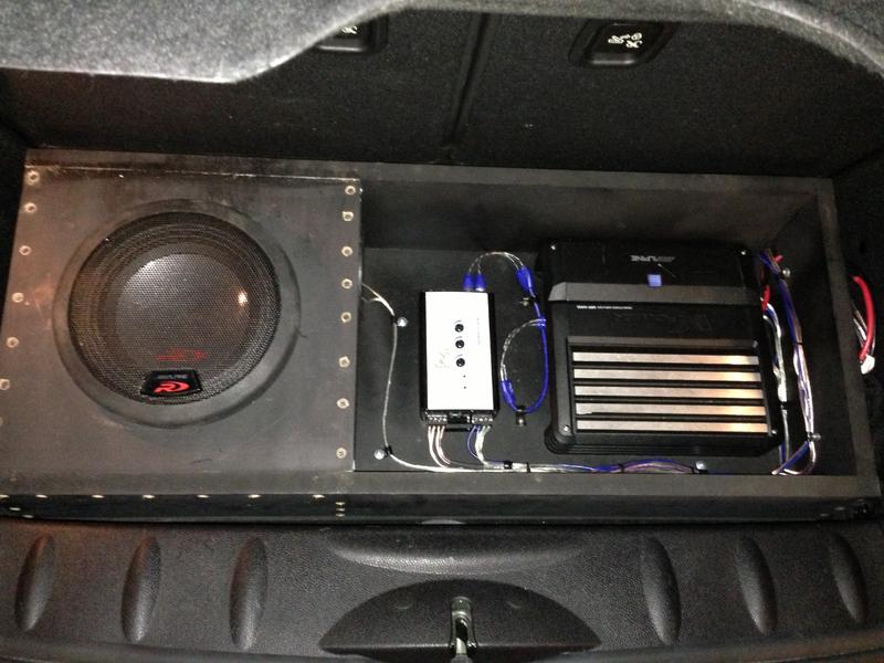

I run a single 8" Alpine type R DVC in a sealed enclosure getting 400x1 at 2 ohms from a MRP-M450 and it is more than enough. Clearly it comes down to preference, but if you are only asking if it is sufficient to add depth and clarity on the low end, then I'd say I'm more than satisfied. I attacehd 2 pictures of the setup for reference. Good luck and I'd love to hear how it turns out.

Very nice setup. I think I may have come across pictures in other threads too. Very clean! How is not having the back seat going? I have to throw my kids car seats back there once in a while, so deleting is not an option for me, but the useable space seems great!!
