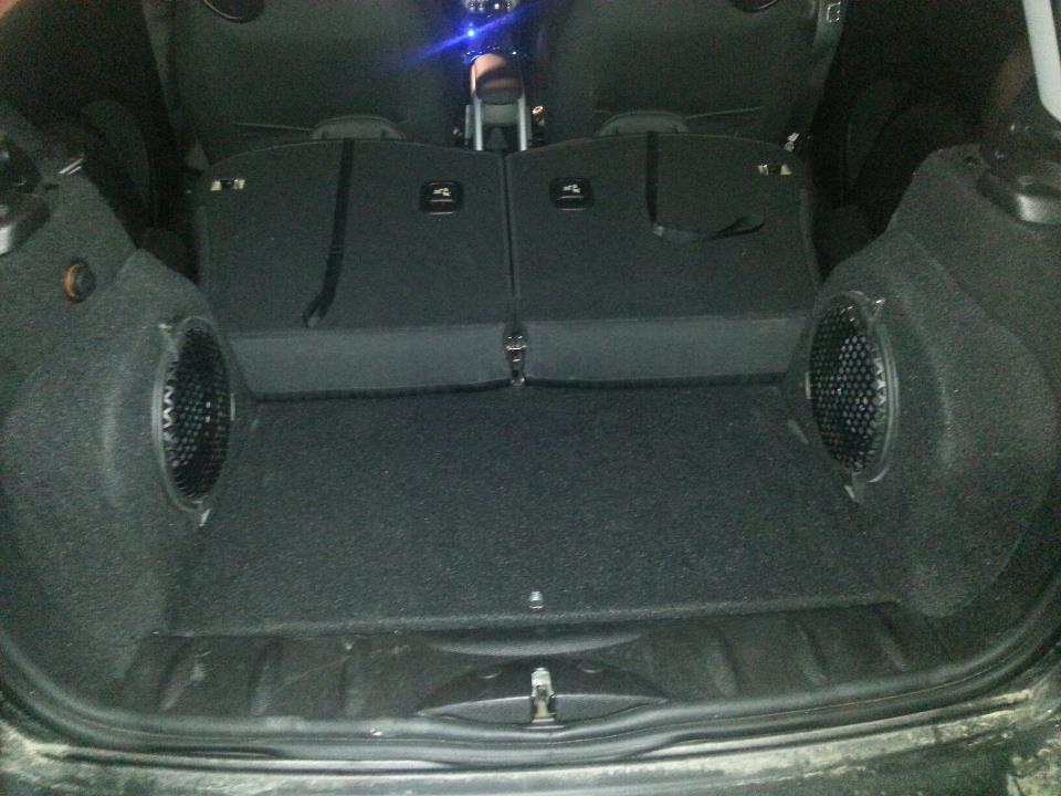

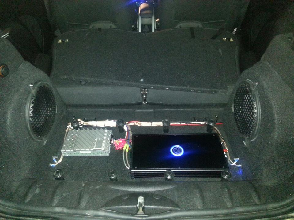

I did mine a bit different due to factory amp..but looks and sounds great...
