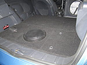

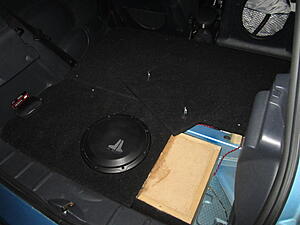

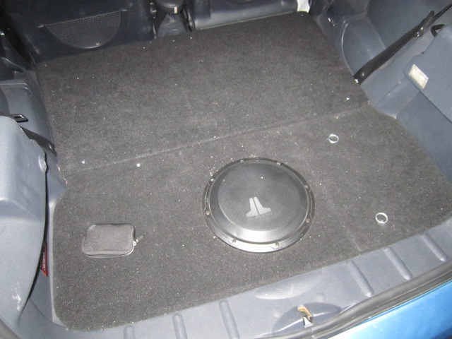

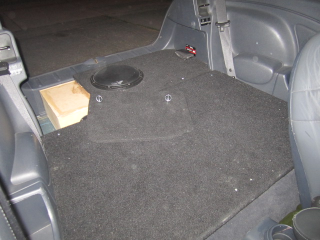

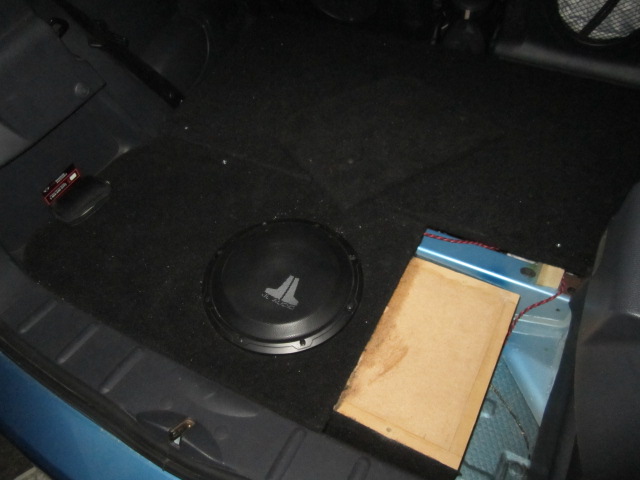

Rear Seat Delete Project Finished
Built a single 10in JL into the trunk's recession. Cut out a top piece of 3/4 MDF for the top of the rectangle box then cut a third of the MDF out and drilled two holes for lanyard/pull pins for easy removal of the box as a whole. Now for the actual seat delete I also cut a piece of 3/4 MDF out to fit snug in the rear in place of the seats. All of it I carpeted in black interior carpet/sub box carpet to match my upholstery. Now for the RSD MDF section I put a single hinge on the back where the seats mount in towards the middle. I also mounted four+1 support to distribute weight evenly upon the 3/4 MDF section. In the very front I have a drawer handle mounted upside down with 4 plastic spacers to act as supports as well. All this is invisible unless you open the RSD itself. Now as the AMP's go I mounted both underneath the RSD upside down. They give me no trouble as air movement goes. Pretty handy considering the back seats are basically buckets so there is a nifty storage compartment on either side even with the amps mounted in there as well.
I will say that with everything completed it sounds great with the little bit of polyfill. I have everything running of a high volt pre-out outfitted JVC. All in all I spent upwards of 700 dollars to replace my entire sound system. All 6x9's, 6.25's, 10in JL and the H/U were installed by me. Only thing missing is the PITA steering wheel controller that I haven't gotten around to.
Excuse the messy interior as I have been overhauling it accordingly. Have to keep up with all the Subies in the neighborhood.
Also if there is any fellow motoring MINI's around the Ogden UT area give me a shout out! I need some competition through the canyons. I can't possibly be pulled over alone all the time.
Happy motoring.
Any questions or concerns just let me know.

Specs:
2x Infinity Kappa 6x9's
2x 6.5 Infinity Kappa Perfect 6.5's
1x JL 10W0v3-4
1x Kenwood 660 4 channel
1x Crunch (hifonics) bridged to run 1x @ 700rms but running at 200rms
JVC Arsenal KD-AR 870 (purchased mainly for the pre-out's and backlight options to match the amber dash)
Will post more pics if wanted.
Please give me a rating for my custom sub-enclosure/RSD work.
