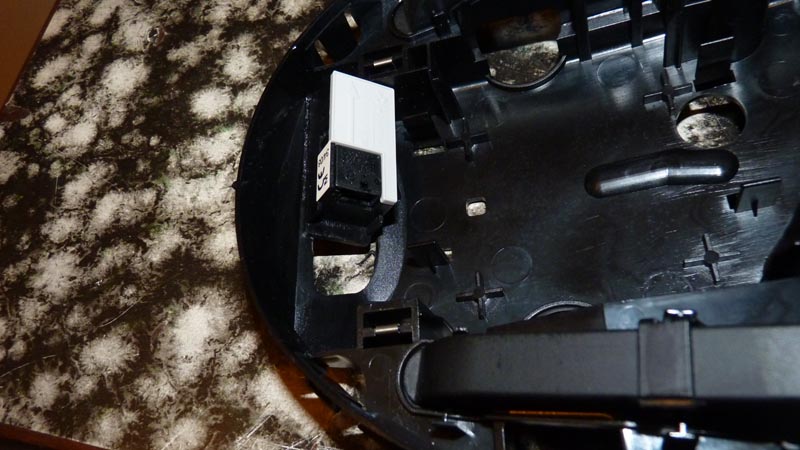

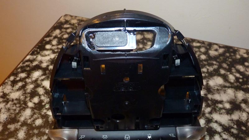

I have an 09 Clubman S with the factory bluetooth and it was qualitatively unusable. I spend a LOT of time on my cell in the car so BT is critical for me. Everyone listening said I sounded like I was shouting into a long tin can. So I contacted 3 different dealers all of whom said: Yep, it sucks. No fix. I tried an expensive Motorola aftermarket (also point directly down), it sucked too.
I found a thread here that said that the mic may have been installed on the right-side vs the left side... Yep, that was true. I moved it. The sound was still horrible. Really unusable.
So in desperation and without any real "fix" like someone creating a better mic, I thought I would experiment. I removed the lighting assembly then the mic from the left mic compartment. I cut the center section from the back and glued the mic to the back section with hobby glue so the mic faced back and toward the drivers-side. The cover already has a really convenient "grate" at the back that just screamed "microphone hole". I then used a bit of tape to seal up the open area and reinstalled the lighting assembly.
That worked. The sound quality is much better and the BT is now at least usable. I do need to have my head tilted up a bit though...
Disclaimer: This will certainly void your warranty on the mic and the plastic lighting assembly and possibly other related components.
If you are even more creative, figure out a way to point the mic from that rear section of the lighting assembly a bit more toward your mouth than I did. Those mic's like to be pointed right at your mouth.
I posted this and the photos because without this fix, the car, which I like, was history because I need working BT and can't use the in-ear BT. Now it's "usable".
Good Luck!!!

Yeeehaw!!! Drew… I had a go the other night at copying your effort… GREAT improvement (waaay more than just moving the mic to the correct side).
I got away with just some tape; for me the mic just ‘wedged’ into the hole nicely and also got it ‘aimed’ correctly.
Tools:-
T20 screwdriver
Wire cutters or something else that can clip or cut plastic
Tape (I had some >really< thick tape handy from another job), but duct-tape will do.
Total time : 15 mins or so.
Steps:-
0- Call your voicemail and count to 10 as you turn the fan up. That will give you the ‘before’ recording.
1- Remove the gray over-cover. Put tape over the two original mic-grilles. I also added some of my thick tape in the center (like ‘sound deadening’); not sure if that makes any difference.
2- Remove the mic as you did before; put it aside
3- Look up at the black plate from underneath and remove the two t20 screws (they’re in pretty deep, so hard to see).
4- Release the six clips around the edge and let the plate hang down. (I'm pointing at 3 of them here... you'll see them easily when you're there).
5- At the end of the plate there is a big hole, with a central dividing piece of plastic; with the clippers… cut away the plastic. DON’T make the hole TOO big… its nice if the mic just wedges in there.
6- Squeeze the mic in, most of the way (it can’t protrude too much, otherwise it will hit the gray outer cover). Angle the mic so it will face slightly down and (left) towards the driver.
7- Fix the mic in place with some tape on the inside.
8- Reassemble it all and call your voicemail to test the result.
If you look really closely here... you can just see the mic.
