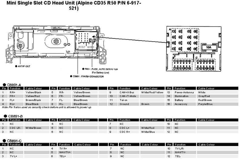

debayo,
My solution may be different than a fix for you since you're installed in a Camry, but it might be the same issue. Unfortunately, I don't have photos anymore, but I can try to explain it better if that helps. If you can send me pictures of your kit and if you have a pinout diagram of your radio that would help.
You need to know which wire goes to the battery and which one goes the accessory. See the attached file - it shows the wire going into the 15 pin on the MINI stereo is for the battery and the 16 pin is for the accessory.
The GTA kit was wired into the battery so I think it was always pulling power from the battery (even though it shouldn't). I just rerouted it to the accessory pin so it won't pull power if the car isn't on.
It may or may not be related, but the adapter is really flaky lately. Most of the time it won't find the iPod. It will charge always, but no audio. I haven't had time to pull the radio back out and look at it.
I've noticed that GTA no longer sells a kit for the MINI. Clearly they had issues with it. :(
I would now not recommend the kit (if they still sold it).

Well, this only took me forever to reply. Sorry about that. I actually just pulled the entire kit out, so I have pictures to upload as well.
My kit is a little different than yours, but the concept is the same.
So in mine, GTA uses 4 pins going into the radio. Pins 9, 12, 15, & 16. You can see the 4 wires coming out of the GTA kit and sharing the pins on the plug that goes into the radio.
Using the pinout diagram I posted earlier, I found that on the MINI pin 15 was for the battery and pin 16 was Accessory. So since the battery was draining, I cut the GTA wire (blue wire) going to it. However, the GTA interface still needed power, so I stripped back some of the housing on the GTA wire going to the accessory pin (red wire), and then wrapped the GTA blue wire originally going ot the battery around that GTA red wire. That provided power to the unit still, but only when the key was turned out.
That completely fixed the battery draining issue.
So for your car, it looks like to do the same solution as me you want to find the wires going to these pins
Car Radio Battery Constant 12v+ Wire: Blue/Yellow
Car Radio Accessory Switched 12v+ Wire: Gray
You want to cut the Port 1 side of the wires. Cut the constant wire (Blue/Yellow). Strip off some of the housing from the constant wire and some housing from the accessory wire (Gray) and wrap the stripped constant wire around the accessory wire. Wrap some electrical tape around the new piggybacked wire and you should be set. That should stop the battery from draining.
Let me know if something doesn't make sense.
