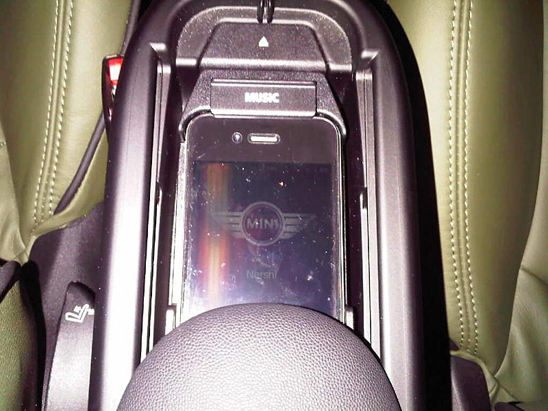

Old Jun 15, 2011 | 12:12 PM
Club Chapin's Avatar
Club Chapin
Joined: Jun 2010
Posts: 70
From: Seattle
My dealer called last week and said they have the adapter in stock now. I went and picked it up today. It is part no. 84 21 2 199 393 that cost $197.
Installed it and it does work with connected. Interestingly, it did not work with my ipod touch but it does work with the iphone4.
There are 2 features (so far) that don't work, video (video option is missing from the media menu) and ipod out/PlugIn (The system indicates that there are no PlugIn compatible devices connected).
I think that this adapter is an audio only adapter. It is labeled "Music" on the release button. Picture attached.
I wonder if 84-21-2-186-288 works with "PlugIn".
