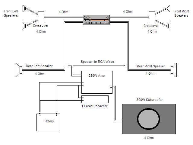

Reviving this old thread. Attached is a diagram of the stereo layout in my '06 MCS. I am guessing there is an overload due to the fact I may be pulling more power from running some speakers in parallel, which is halving the impedance from 8 ohms to 4 ohms. Any ideas or suggestions are greatly appreciated. Thanks.
If you have an overall 4Ω impedance on each front channel (taking the crossover into account) and an 8Ω impedance on each rear channel, that shouldn't cause your problem. The speaker-to-RCA converter into your sub amp won't cause an excessive draw either, since the input impedance of your amp is so high. The stock head unit is designed to drive a 4Ω load on each of its four channels, so a 4Ω load on each front channel and an 8Ω load on each rear channel would actually be a very light electrical load.
Are you sure the impedance for the rear channels is really 8Ω, though? You mentioned speakers in parallel, which would halve the impedance, not double it. So if you have two 4Ω speakers on each side in the rear, and each speaker is 4Ω, then the overall impedance on each rear channel would be 2Ω, not 8Ω, and a 2Ω load on a single channel would certainly be low enough to cause the head unit to cut out.

Hmm... I will have to go back and look. I think I assumed (gasp!) the speakers are 8Ω. If I did halve the impedance to only 2Ω, do they actually make a resistor that can compensate?

Ugh, you're right. I think all my speakers are 4Ω, which means all my numbers are half of what I have in the diagram. Interesting thing is the old deck I had in my '02 MCS never cut out. It simply capped the volume level. The only other difference is the auto shop that installed the wiring kit in the '02 tapped ONLY the right rear speaker for the two RCA drops for the sub amp. I changed that in the '06 MCS by tapping both rear channels.
I like having the MP3 support, so I'm not gonna put in the old deck. So, yeah, as I mentioned in my other post, I will need something that can help compensate for the decrease impedance.

First, what is the part in your diagram labeled "distribution box"? Is it just a simple parallel connection, or is it something like a crossover network? That will make a difference as to what the load is on the deck's front channels. If it's just a simple parallel connection, then the 2Ω load on each front channel, is almost certainly what's causing the deck to cut out.
Your rear channels should be okay if each channel has a 4Ω load, so it appears that the problem is with the front speakers. You can't just add in a resistor, because the typical Radio Shack carbon film resistor can only dissipate 1/2 Watt or 1/4 Watt. You would need a "power resistor", which cost as much as a speaker, and it would be a waste anyway because all you'd be doing is putting off half of the deck's front-channel power as heat.
The simplest solution would be to go to a single pair of speakers in the front. Since your speakers are 4Ω each, disconnecting one of the front pairs would get you back to the 4Ω per channel load that your deck needs. If you want to have two pairs of speakers in the front, another option would be to get two pairs of 2Ω speakers and wire them in series for an overall 4Ω load per channel. There are 2Ω specialty speakers out there, although they're not as common as the standard 4Ω ones.

From what I am reading, the distribution box is actually a two-way crossover. The mid leads to the 5 1/4" speakers are split into mids and highs. The factory high-range connections are not used at all. This is part of a component kit (was in my old '02 MCS and installed by a friend/previous owner; I migrated them over to the '06 MCS). They look similar to what you see in this ad: http://www.crutchfield.com/p_158GTX1...1S.html?tp=106.

So you have two pairs of speakers in the front, along with the crossovers. Did the crossovers come with the speakers, or did you mix-and-match parts from two different component sets? If the crossovers came with the speakers, then the overall impedance for each front channel should only be 4Ω and therefore not a problem.

Yes, the crossovers came with the speakers. Maybe the issue is with how I changed the way the amp gets its RCA signaling?

I updated the diagram to reflect what we've discussed. The only section I'm not sure on for impedance is the RCA taps.
