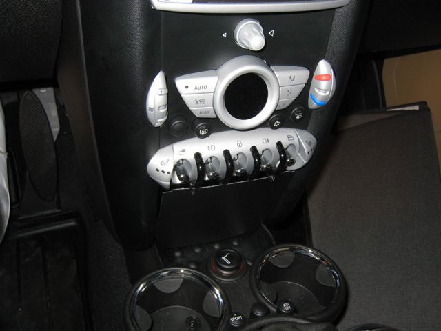

Originally Posted by blackjackmark
Got any pics? I've thought of something similar myself, I'd love to see how you made it work!
Here's two pictures. One is up real close with the flash. It shows the detail (imperfections). The other picture is from not quite as close and I think the flash was still on.
Anyway, the makeshift cover doesn't look great up close with the flash, but from the normal sitting position, it kinda just blends in. At night, it absolutely disappears. It's just a black hole. My iPod is connected behind the cover in both pictures.
If I were to take another shot at it, I probably could contour the cover a little better, but this is good enough for me. It only cost me $3 and ten minutes and I no longer have to disconnect my iPod every time I hop out of the car.
Attached Thumbnails iPod in "Secret Compartment" with Comfort Access?-img_0378.jpg   iPod in "Secret Compartment" with Comfort Access?-img_0375.jpg
Thanks for that!
Wonder if a "friction fit" would look better? If the material is flexible enough to bend a little, yet stiff enough to hold firm, could you cut it slightly larger than the opening (either top to bottom or side to side) and make it stay through the pressure exerted on it being just a tad too big? Or are the sides for the enclosure too smooth and or splayed outward so that it would always be popping out?
Thanks for that!
What you describe wouldn't work unless you add something to create the friction. The plastic material that the cover is made out of is as slick as can be when against the console's plastic surface (or whatever the console is made out of). Maybe if the cover was wider and you glued a rubber strip to the sides of it that could work. Then you might have to worry about it bowing and leaving the iPod partially visible.
Someone really handy could fashion a door that would pivot on those two pegs at bottom of the console. I wish MINI had done that for us. They made that little rubber mat for the console. A door would have been even more useful.

Thanks for the cover idea; I don't know if I am up for the whole wiring job, so that might do the trick in the meantime. I was thinking about how to do it, and now I can just copy Jeru99.
