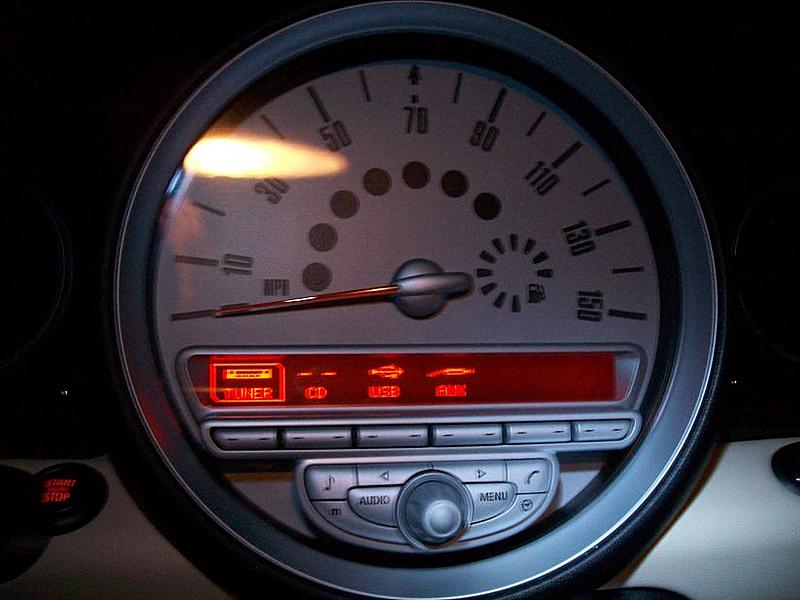

After 3+ hours of testing different cables, settings and quantities of music i have found the following.
All generation iPods will work with the white standard iPod cable. The difference is that the car DOES NOT think it is an iPod it beleives that it is just a USB drive and has the same limitations that a USB drive would have. That is to say that there is a 20,000 item limit. Items consist of the mp3 tags for each track. So if there are 5 tags for each track you are limited to 4000 tracks and if there is 10 tags per track you are then limited to 2000 tracks.
This limitation is brought on by the CCC and ULF and other modules in the car. I.E. the computers that run the ICE (in car entertainment) system. These limitations are because of the lack of memory in the ICE system. All the music information (tags) is read by the ICE system and then can be displayed on the screen in the speedo be thru the nav screen or the basic screen. If you have more music than what the ICE system can contain some of it is lost until you try to access it. When you go to access music that is not in the ICE system but is on the USB device it takes some time for the ICE system to find it as it has to go thru and index it into memory.
The way to see this is to hook up the iPod with the white cable and press the audio button it show across the screen Tuner, CD, USB, Aux as seen in the first photo below.
But when using the Mini Supplied cable the iPod actually show up as an iPod. This function can be seen in picture two below. When the system sees the iPod the only limitation to the amount of music is the amount the iPod can hold. There is no 20,000 item limit because the iPod actually controls the music and playing of it and the ICE system is just a dummy interface that controls the iPod.
The reason that the other cable that have both the usb and audio cable such as those from Kenwood or others do not work is because they do not have the correct resistance between pins on the usb connector to tell the ICE system that it is an iPod that is connected.
Different cables have different resistance in them to tell the unit that they are connecting to what software protocol to use.
So the conclusion is that you either accept the limitation using just the standard iPod cable, Buy or get your MA to give you a Mini cable, or make one from a cable such as the one that Kenwood sells.
I will try to see if i can figure out what the resistance is and how it is hooked up in the cable. When I do i will post it so that others can try an make their own cable and save some money over purchasing the Mini cable.
EIDT: if you go to the link in post #28 of this thread it tells you a little about the different resistances for pins 21 and 27 and also about 5vdc power to pin 25. So by minipulating these values the system will see the iPod differently.
Just a note that with NAV, the menu still says "AUX," but your playlists show up when you use the MINI cable.
Does the USB Symbol change to iPod?
What year is your car?
I ask because the one (1) vehicle I tested at the dealer with nav changed to iPod and eliminated the AUX
'08 MCS, build end of May 08. The 4 choices in the Entertainment menu are FM, AM, CD, and AUX, even when the iPod is plugged in, but again the iPod works like it's supposed to (playlists appear, playback resumes at exactly the spot it stopped or where you stopped when listening to the iPod elsewhere). Don't know if this is a software change or irregularity, but it works and I'm happy .
