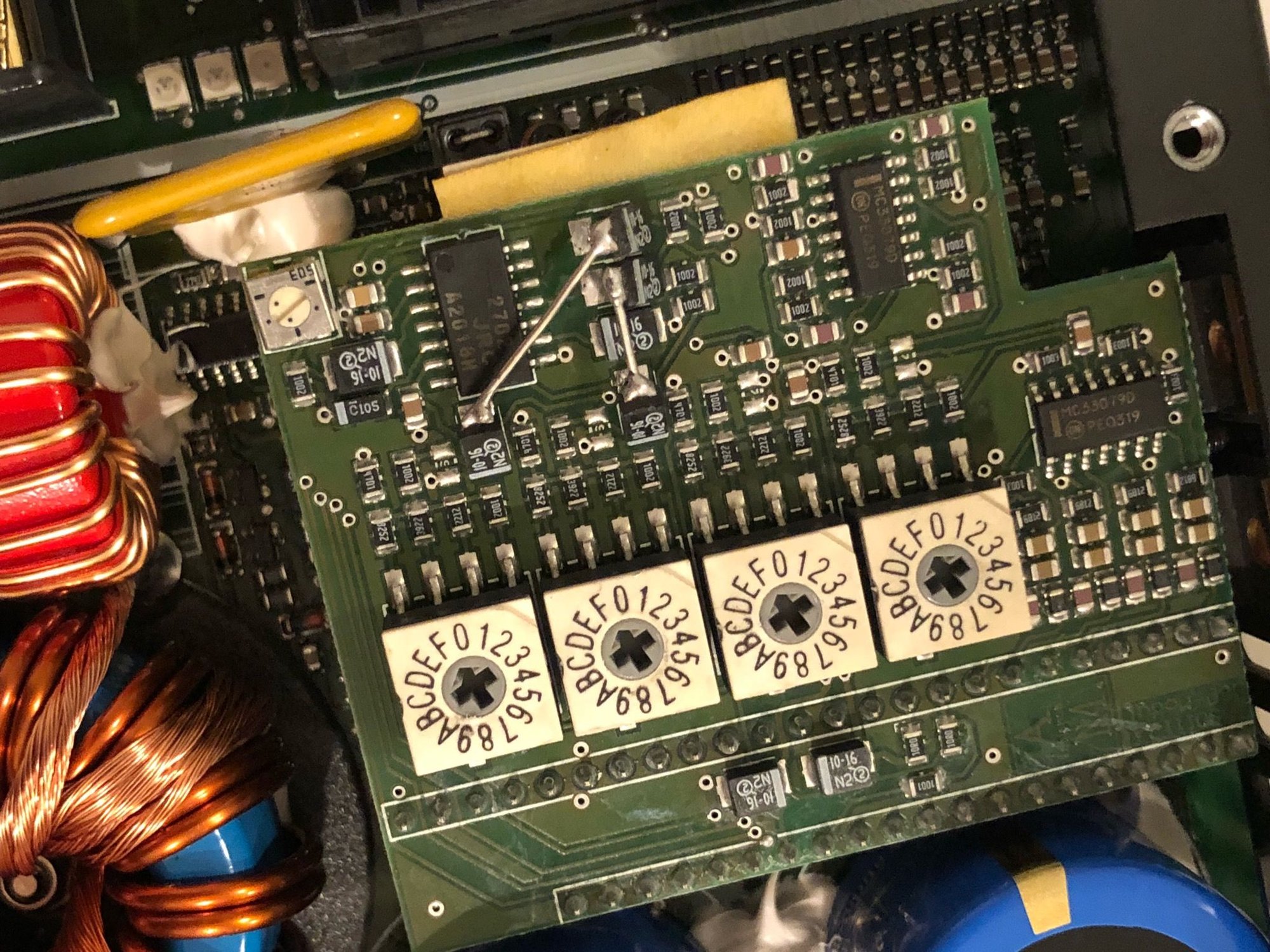

Nice, I have a used kit with a bad amp from the UK. I need to fix the amp how did you fix it?

Someone on Mini2 figured out that bypassing the surround chip fixes the amp from popping all the time. Check out the last pix in my post, heat the ends of those chips and wire them as shown.

Hi everybody, I think we have the same DPSM problem in our german Cooper S R53.
- What is the surround sound chip and the switch for, which does not work anymore?
- The 4 solder joints must not be connected to the board, only together with the wire?
Thank you

The DSP surround chip is super faulty. It’s the rectangular chip under one of the bypass wires.
Correct, lift just one end of those chips as shown in the image and connect them with wire.

Ok, and then I can turn the switch on or off, it has no function anymore?
What are the rotary switches on the board, because it is possible to adjust the balance and fader on the radio?
Reply 0
Oct 31, 2018 | 01:49 PM
  #61
Once you make the mod, the switch DSP on-off becomes inoperative and can be removed. I don't remember what dials do what, I would just leave them as-is. If you do want to change them, take a picture of their current positions. Adjust the dials with a plastic tool and use the picture to reset them as needed.
