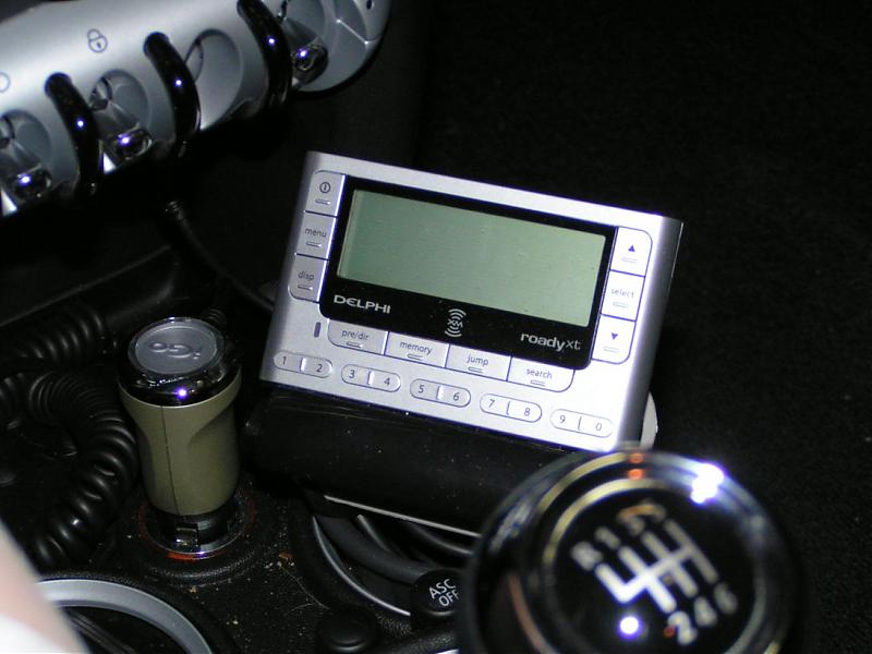

Hi, I've got a Roady XT also. Had it hardwired by the stereo shop. It's mounted on a Belkin TuneDok for Roady and SkyFi:
http://www.circuitcity.com/rpsm/oid/...oductDetail.do
it works really well, the reciever stays put and you can bend it any way you like so you can see the display.
A picture is attached (please ignore dirty MCS!!)
