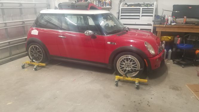

While waiting for the gaskets and steering pump lines, I got bored and started some of the cosmetic things that needed to be addressed.
I cleaned and waxed the hind quarters and using the faded paint and small imperfections I was able to locate where the last decals were and applied a new one while leaving the protective cover on.
We test fitted the hood before I realized that I did not have any dimensions for it, so off to the nam forum and before I could even get back to my computer with a tall glass of milk and four, no lets call it three, yes three cookies, well officially it is just TWO cookie. The actual count is unimportant to this story, just know that I got two quick replies and I will put that info to good use before this week runs out. Let's call it two cookies and leave it at that. After all, we were all friends here right?
It was a nice change in pace. Although I had to get up and down on the floor a few times it went smoothly and Monty seemed to cooperate more than usual.

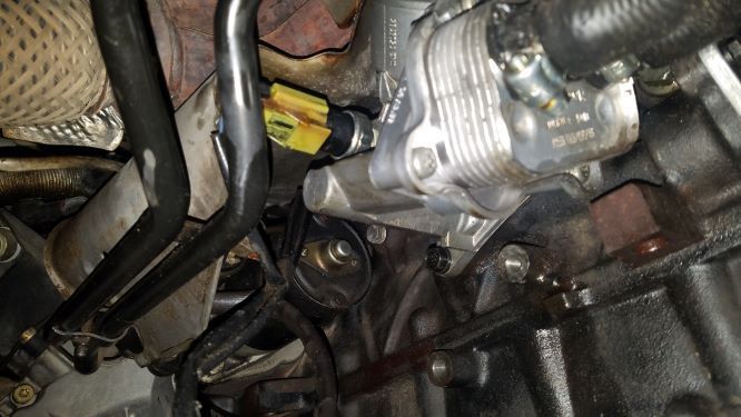

I know this is Texas, but enough oil already!
I was under the engine torqueing the oil pan gaskets to meet some arbitrary fig Newton amount. I think there are 45 in a box and we used 31 of them. Might as well use the others on some random bolt or two before I throw the bag away. Then I saw this thing with oil on it.
Thanks right boys and girls, the oil heat transfer unit was leaking.
I had sprayed down the back of the engine last night and it should have been dry, but nooooooo. This little cooler unit had oil on it and a lot of silicone sealant from previous owner trying to stop it from leaking. I hope I don't find a bead of silicone replacing the O rings gaskets. I had already changed the oil filter, and the accompanying o ring for that and that funny looking three chamber gasket that goes against the engine, so the only thing left were the two O rings underneath that THING that the hoses connect to. UGGGH>
Well OK, a quick look at [ favorite parts store] web site and $17 later two rings were ready to ship. But then I looked again......
Both of these hoses looked like they were bulging and had been weeping. A hose is a hose is a hose, right? and I could always fix it later if it was leaking, I told myself. But as I was dragging my but out from under the car I realized how hard that would be once the subframe was in. So back to the web site and added two more hoses at the new hyper inflated BMW/MINI prices (enough so as to qualify for free shipping).

Silicone sealant around O-rings is never a good sign
I took the old hoses off from the oil cooler heat transfer housing because I was having trouble getting the Torx 30 head crews out, so I had to take the three 13mm bolts and put the whole darn thing on my workbench. I CAREFULLY put it in my vise and was able to get the last two Torx head screws out with on incident.
What I now had were two parts of the puzzle and I did not like what I saw.
It has silicone seal around and ALL OVER the gaskets. I hope this was an attempt to stop it leaking with the old gaskets. The old ones were stuck to the face plate and came out of the grooved slot real easy, so now I am concerned it will leak when I put it back together.
They pulled off the face rather easy enough and the face looks a little scraped up. Wonder what THAT part would cost.
The parts will arrive on Wednesday so I guess I will just watch TV for the next few days. I would invite Monty in to watch as well, but His journey lays on a different path and so he remains in the garage.

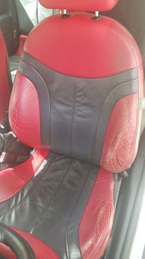

A quick recap of the interior. It was much cleaner than expected and sans the 3x3 build plate it was complete with the MC40 shift **** all four of the floor mats and the one in the boot.
The seats were pretty good considering they have 94,000 miles on them, but still there was a certain amount of patina that made the whole car seem a little more genuine.
But a closer looked convinced me that the seats needed some professional help. The leather was worn through and no amount of leather seat conditioner was going to fix that.
I was hoping that I could just fix the one bolster on the drivers seat and keep the patina and wear on the rest of the drivers and passengers seat. One shop wanted to replace all of the cover in a "new and better vinyl that would wear better than leather" I passed.
The second shop did not seem interested and pretty much said they only do "custom work" and factory restoration was not something they would be interested in.
The last shop I tool the seats to said the seats were sun faded and it would be hard to match the color as it did change from one part of the seat to the other, but they were willing to try. They also offered me a vinyl option just as a cost savings measure and admitted that they would not look as good as the leather. They said they would be better off in leather, despite the added cost. I agreed. At that point I got the feeling that they were interested in the project since they seem to prefer to work in leather.
They called a few days later with bad news. They could not match the faded color and the side bolster ran all the way up next to the head rest. (which was not as sun faded as the front or side of the bolster) and there was no way to just repair the front of the bolster without it looking "cheap and uninviting". I reminded them that because I resurrecting this car and wanted to leave it with as much normal patina to show it was an honest road car and not a full restoration for some museum I did not want to do a complete refit. We agreed to change just the red leather. (as a side note, it would have been cheaper to have replaced all of the leather red and black because they would not have to take extra time to protect the black leather for reuse)
After nearly 7 weeks, the seats were ready for pick up. here is the drivers seat as I first saw it.
They put in new foam where needed and even got new batting in the bottom of the seat.
Once home and installed, they do look good. I think I made the right decision to fix the seats. It was a major part of the budget (who am I kidding...... budget ha! we don't need no stinking budget"), but in the end it DOES look good.
Their attention to detail even got the airbag and MINI tags back in place.
After looking at the beautiful seats, I remembered that I had a cabin air filter on the self and since I was working in the interior, why not put it in place.
However, in the process to put in the new filter, I had to look at the old filter.... YUCK
Might actually be the original (or at least 10 years old).
We had a lot of pictures this time. Next time we will get the clutch bled and the subframe back in as we help Monty continue his journey to Zig Zag or Bust next July.

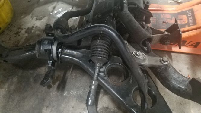

Got himself together and acting like he owns the place
I had such a hard time bleeding the clutch that I gave up and put the rest of it together and out in the driveway before any pictures were taken. suffice it to say, the struts went in; the disk brakes on, the new pads were put in place; the calipers were secured; and all attachment wires ran and secured in their mounts. basically
They say: A picture is worth a thousand words. I am such a poor artist that if I were draw it; it may only be worth 642 words, BUT a PHOTO? that rates the 1,000.
He is on the ground but the journey is far from over.
The clutch is still not properly bled out, the windows are not positioned correctly so wind makes it very uncomfortably loud at highway speeds, the right door lock does not work, and the door lock switch in the dash does not seem to be working.
That's it for now. Monty is literally coming together. His journey is looking brighter these last few days. He has fought me a few times, and rewarded me on others but the journey continues (as do the invoices)

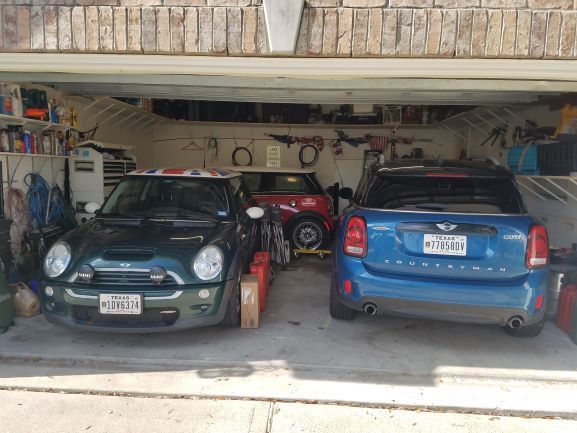

Too Many MINIs?
I have taken a break during the holidays. We needed to travel to family at the end of the year, but had a problem. We were taking a lot things for our trip, so we took the Land Rover (which normally sits outside). but that still three MINIs that needed to be inside while we were gone.
Normally no problem as we have a two car garage and two cars. BUT with us adopting Monty and getting him ready for the MTTS 2021 next July, well there was a problem that needed solving.
There was no way my wife would let Jameson the 2018 JCW tuned Countryman sit outside while we were gone. I did not want Nigel the JCW tuned 2003 BRG Cooper S out either, and with Monty runnig distilled water while I finalize all the hoses and gaskets, if it were to freeze, well I might be doing more work that planned.
We pondered this short straw dilemma as to who would sit outside for a few days and then my wife came walking in with tape measure in had and declared as if announcing the royal Queen herself were being presented at a fancy European ball..... "I THINK THEY WILL FIT!"
Now, my wife is not the most mechanically inclined and does not normally get involved with actual wrench turning, (she has been known to were out here left or right knee bleeding brakes or clutches and any number of project cars we have had over the years). What she may lack in actual wrenching skills, she more than makes up for with her ideas, that I for one, would have never thought of.
After few measurements and rearranging some items along the walls we had this:
View from the house
View from the driveway
I think it helped that we could start with Monty looking like this
With the four wheel rollers, it was easy to push the car around
I plan on tackling the clutch bleeding after the holidays as I need to get him on the road and make sure all of my repairs were torqued right and make sure I did not miss a leaking gasket or some such.
Monty is tucked away right now, but that does not mean his journey to Zig Zag or Bust is stalled. just taking a short holiday.
