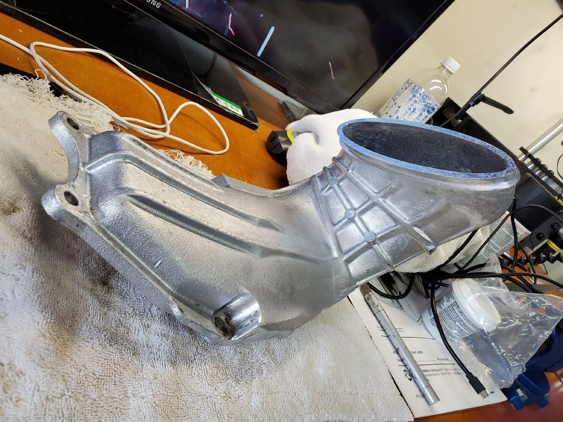

More DINAN Stuff!
Add some more DINAN stuff to the list. The stainless steel back-box is a Dinan unit as well! It needs some polish on the tip to look presentable, I'll get to the soon enough!
Dinan back-box.
