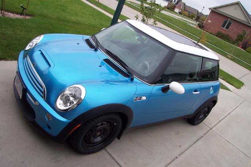

Steel wheels for the MINI
For those who want to know, steel rims from a 2002 Honda Civic EX are the perfect size for the Mini. The size is 15x6 with a 4x100 bolt, offset 40~45mm, but there was no rubbing on my 2003 MCS with 205/50/15 size tires.

here they are on my car

Where did you get them and How much$$$$
Those are great, I love that the hubs fit without rings. Where did you get them and would you mind giving me a ball park price? Thanks for posting the pictures too.

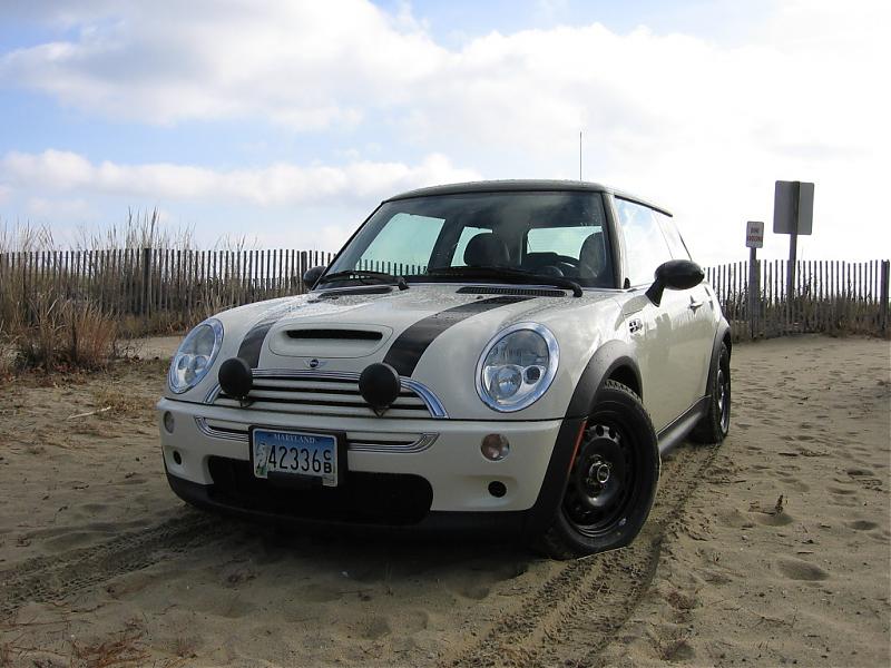

Here are the tirerack steel wheels - I don't have them anymore:
