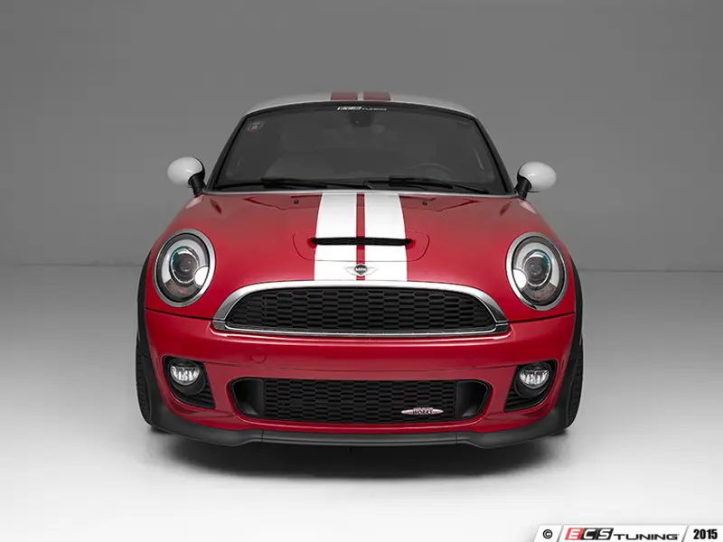

Old ones that are good at a junk yard. Only other option for Xenons is what i did aftermarket and you swap over the old parts ( bulb and ballast) to the new one. So its just the housing. Older cars have to get the updated ballast design new or used, its marked below.
Option 1.
https://www.ecstuning.com/b-spyder-p...-yd-mc07-hid-/
Option 2.
https://www.ecstuning.com/b-spyder-p...-yd-mc07v2hid/
Options 3. Spyders style above but cheaper:
https://www.ecstuning.com/b-fk-parts...sbm016007~fks/
