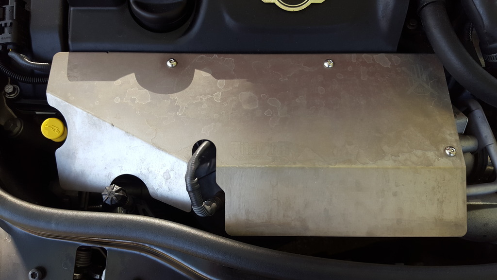

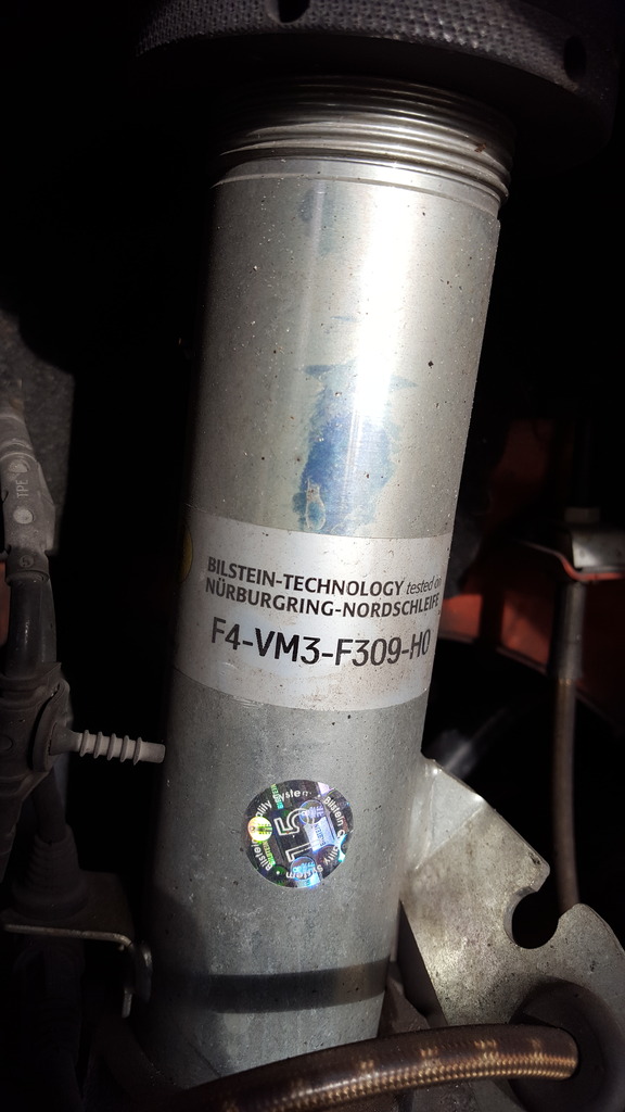

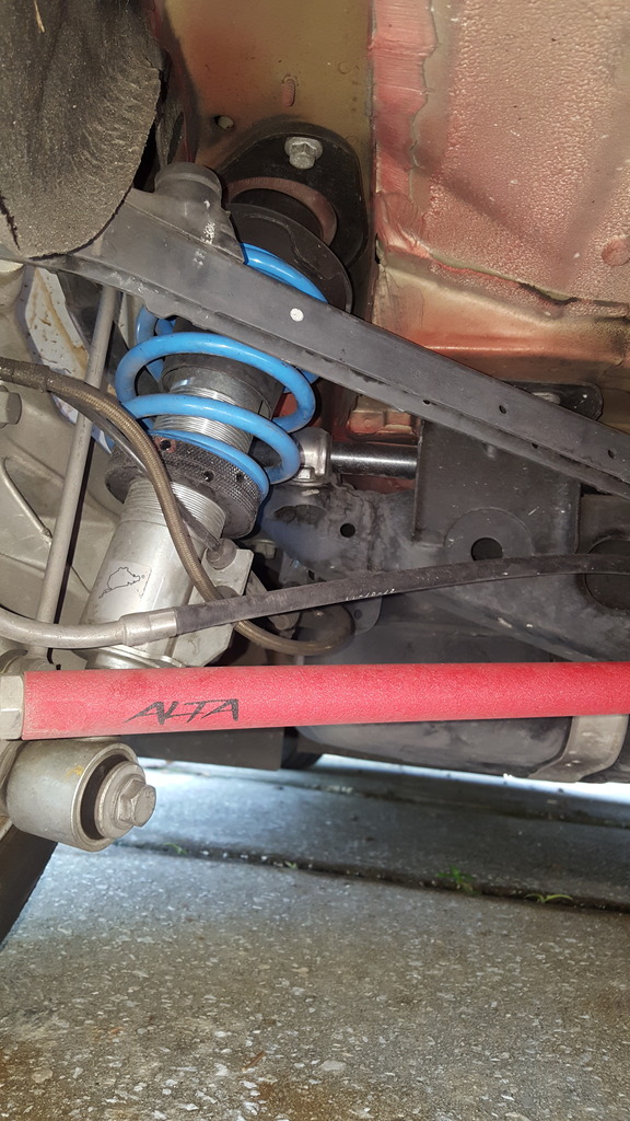

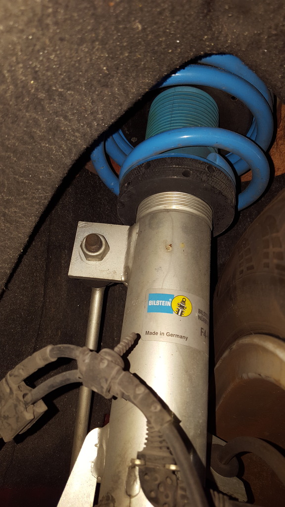

Pics of some the upgrades as best I can get in case someone knows something more about them than I have found searching the Googles.

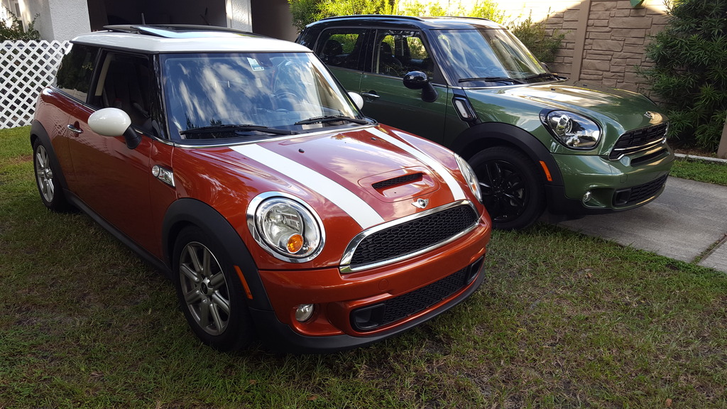

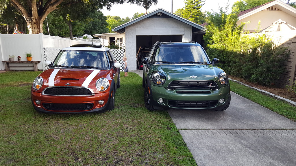

From: Largo, FL
Needed to go over to my mother in laws house to help load their truck for some hurricane prep supplies they're taking to their Daytona house tonight.
I figured I'd snap a few pictures of her R60 compared to my R56. Obviously it's bigger, and a bit chubby in the lines. However, what I really like is that the "spirit" of the Mini Cooper is still there. It's quirky, it still handles better than anything else in it's class, and it is fun to drive (by her standards at least)

So after a second look at my cars suspension I believe I was wrong with my original assessment.
I've got two types of adjustable dials going on, the rears are a ring at the bottom around the tube, and the fronts are a dial at the bottom of the tube.
This leads me to belive I have the B16 pss (9/10). I'll need to clean them up and count the available settings to be sure but that is an awesome upgrade :-)

These are definitely pss10. 9's were never made for this car. From looking at your pictures you are probably close to the max adjustment height. Ill have to find some pictures of my set up, but im at max height and it looks similar to your car.
I don't get it, how am I close to max height when the nuts are sitting at the middle of the threads?
Why put the option for the height if you can't use it, preload for the springs in that application?
i believe the option is there for if you want to use different springs. A lot of people change out the spring rates and there is enough damper adjustment to cover some spring rate changes.

Edit: your camber plates may have an effect on preload aslo, if they changed the top mount stack height.

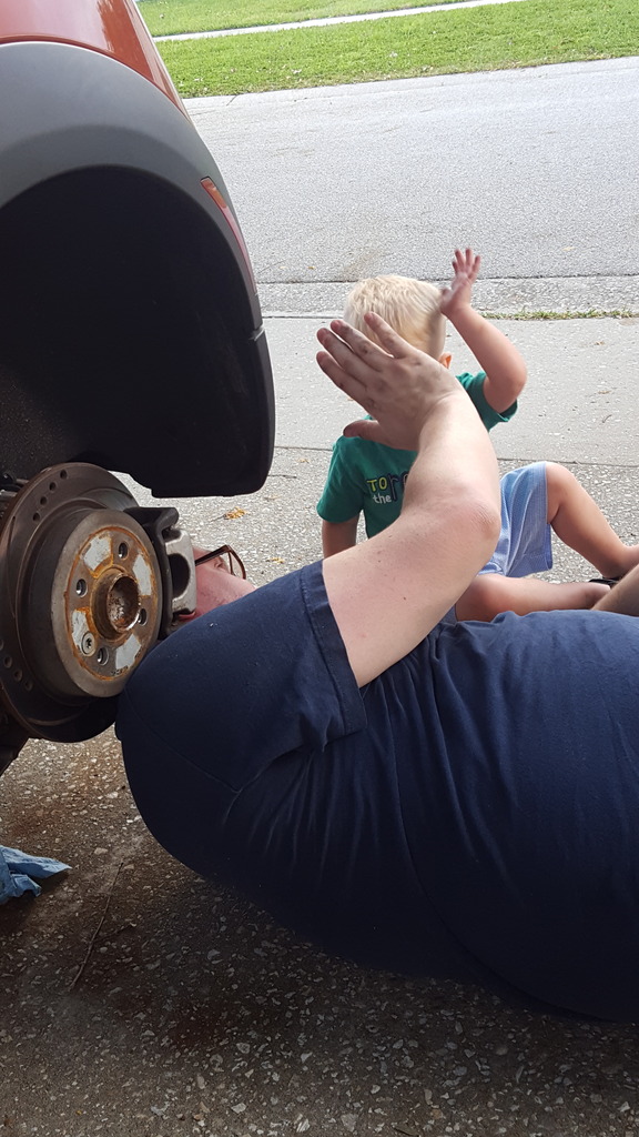

Old Oct 12, 2016 | 05:39 PM
JayDubYa2003's Avatar
JayDubYa2003
Joined: Oct 2016
Posts: 48
From: Largo, FL

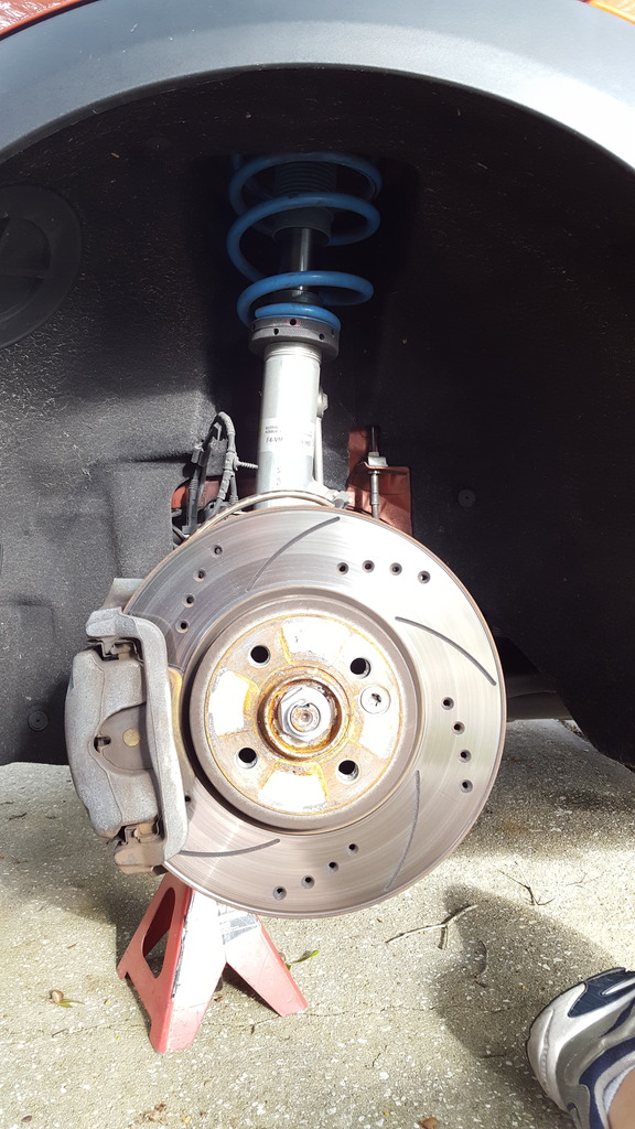

So after our back and forth chat over the last couple days across two threads I decided to take a closer look at the coilovers and clean up the damper s a bit so I could see what they were set at currently.
Come to find out they are sitting in the top third of the threads (so not much thread left for height) and were set to the 9 and 8 (f/r) stiffness settings on the dampers no wonder they were stiff as hell.
I tried them at a 4 and 3 (f/r) which was loads better, but in the end I just set them both to their softest setting (1) all around and it's so so so so so much better to drive on the rough roads around here
Basically big bumps are still rough, but the normal stuff is a walk in the park.

Better shots of the coilovers
