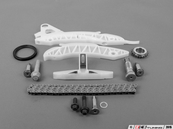

You will need to change the timing chain ( kit ), check the head / pistons / and all the valves , then a head gasket kit..etc. That would be the least, and then having the time to do all of this.
2007 R56 MCS
http://www.ecstuning.com/Mini-2007-Cooper-R56-S-Coupe-L4_1.6L_N14B16A/Engine/
Good luck.
2007 R56 MCS
Good luck.
