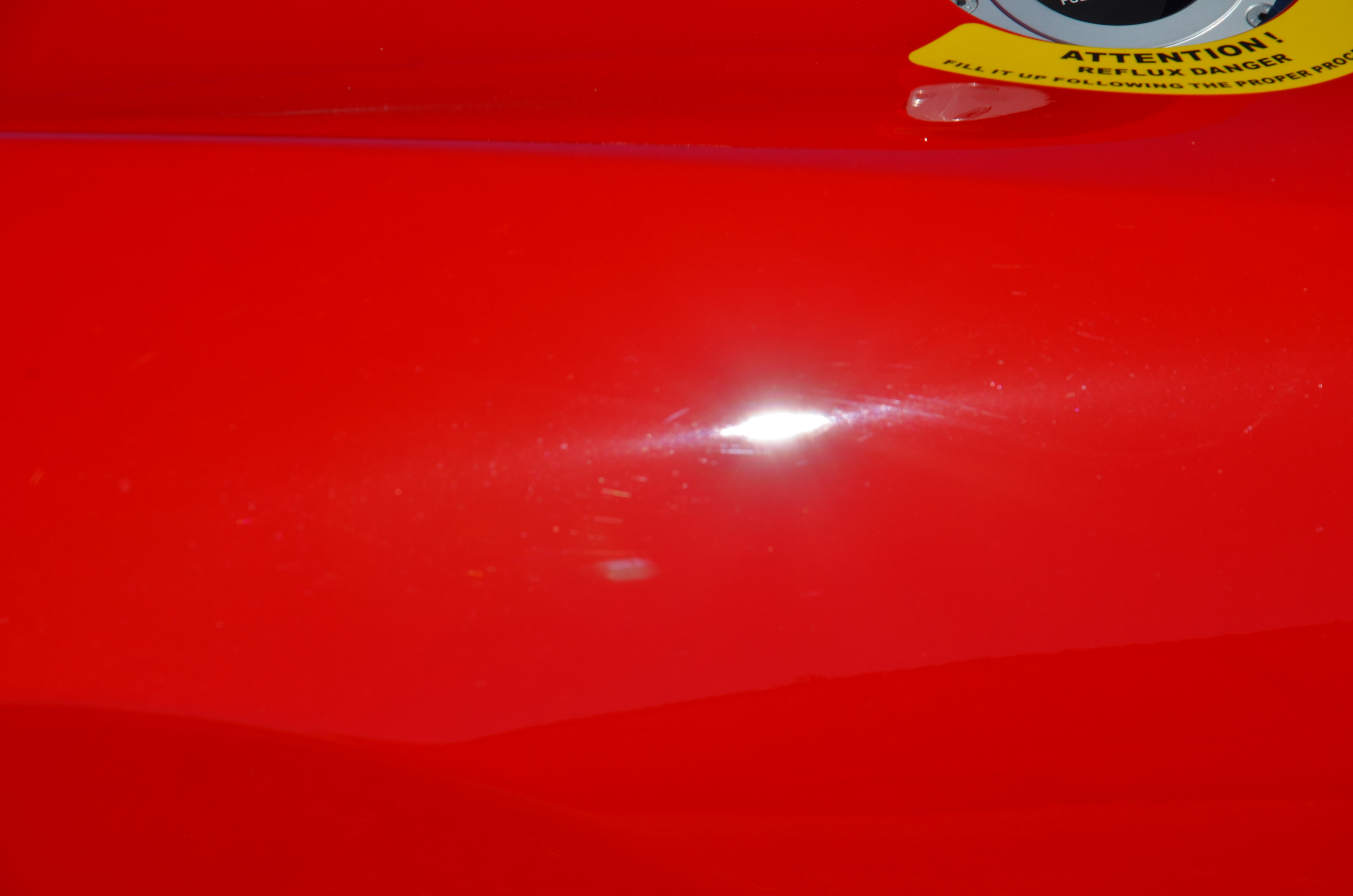

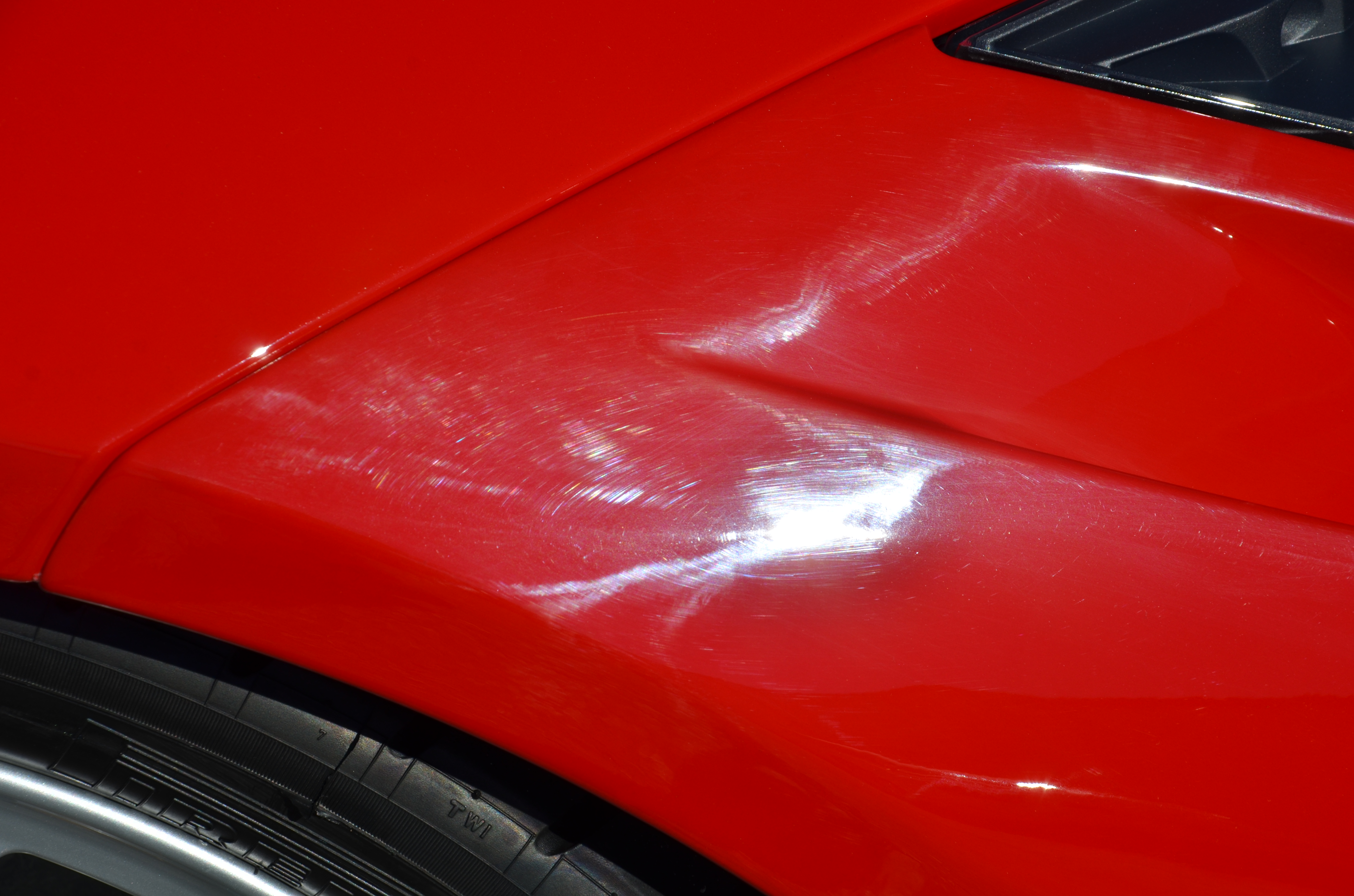

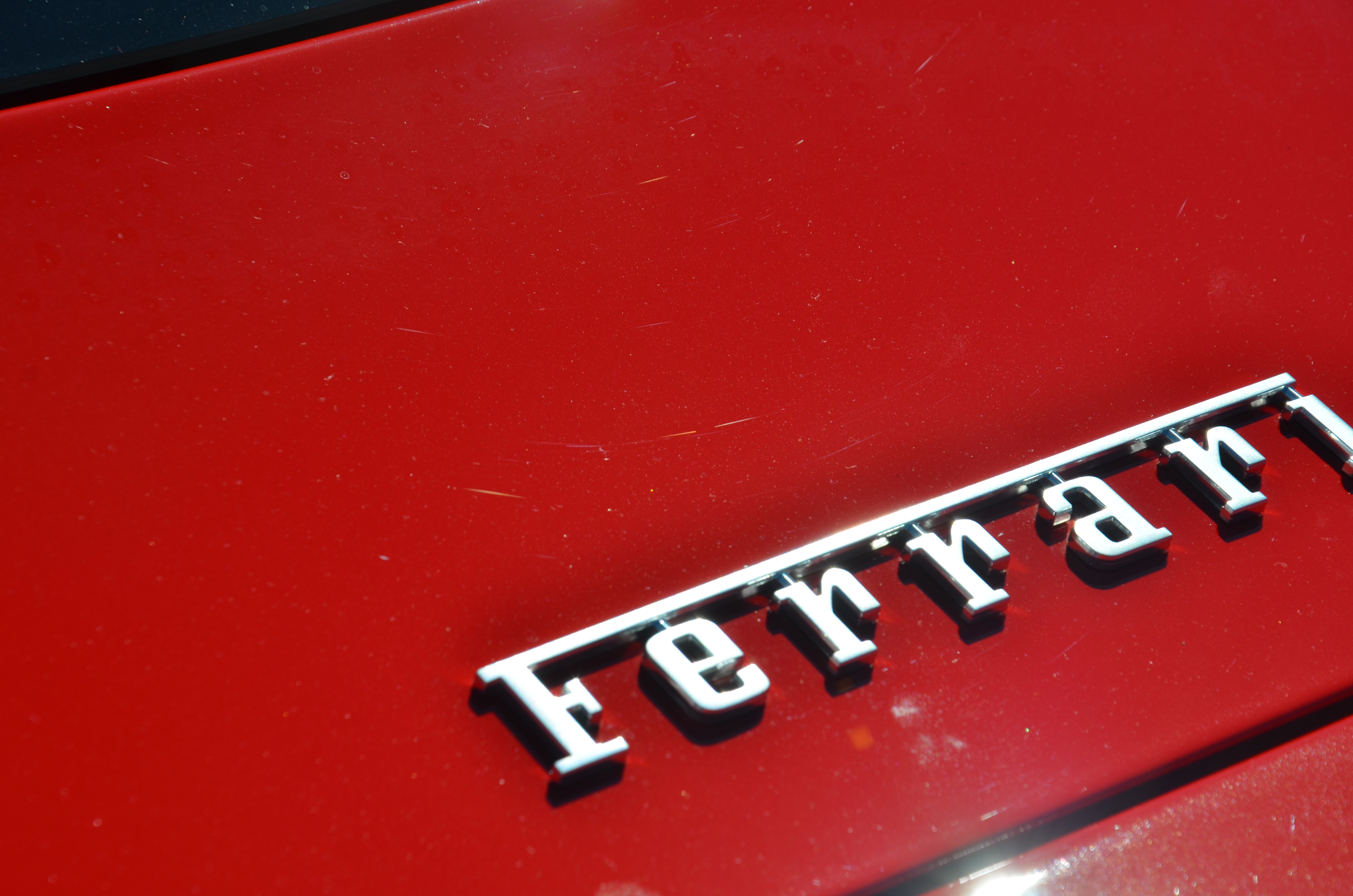

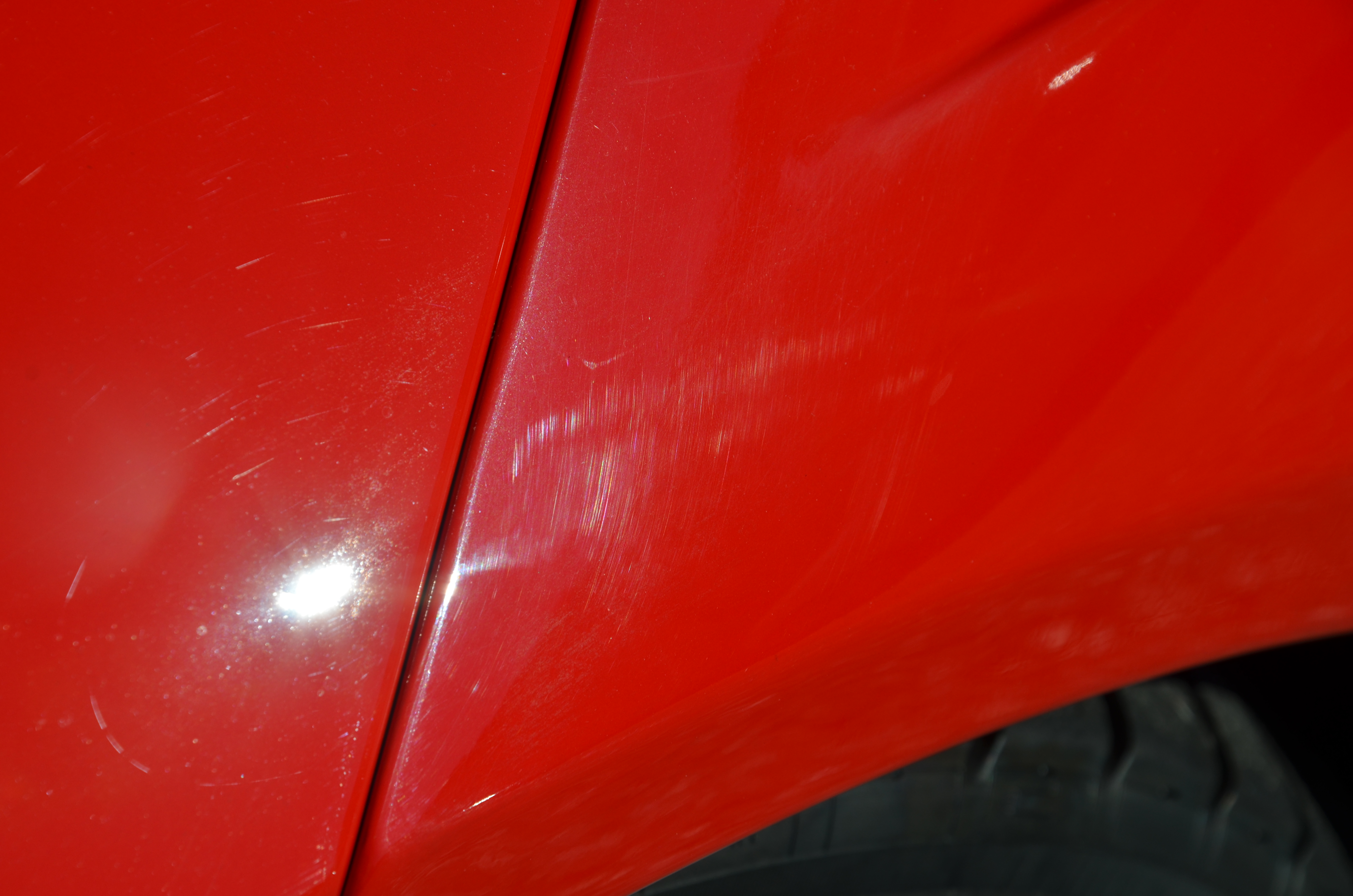

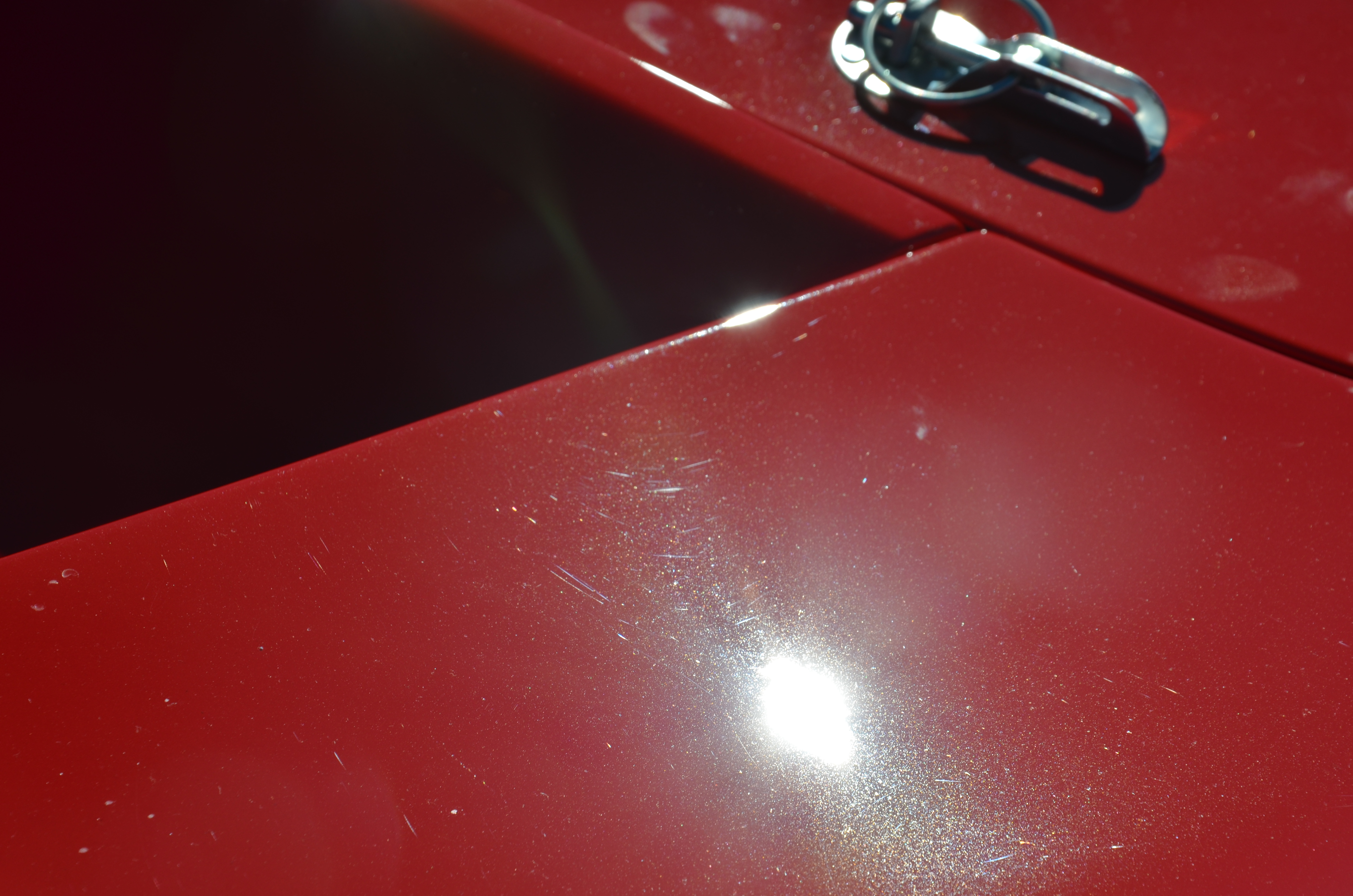

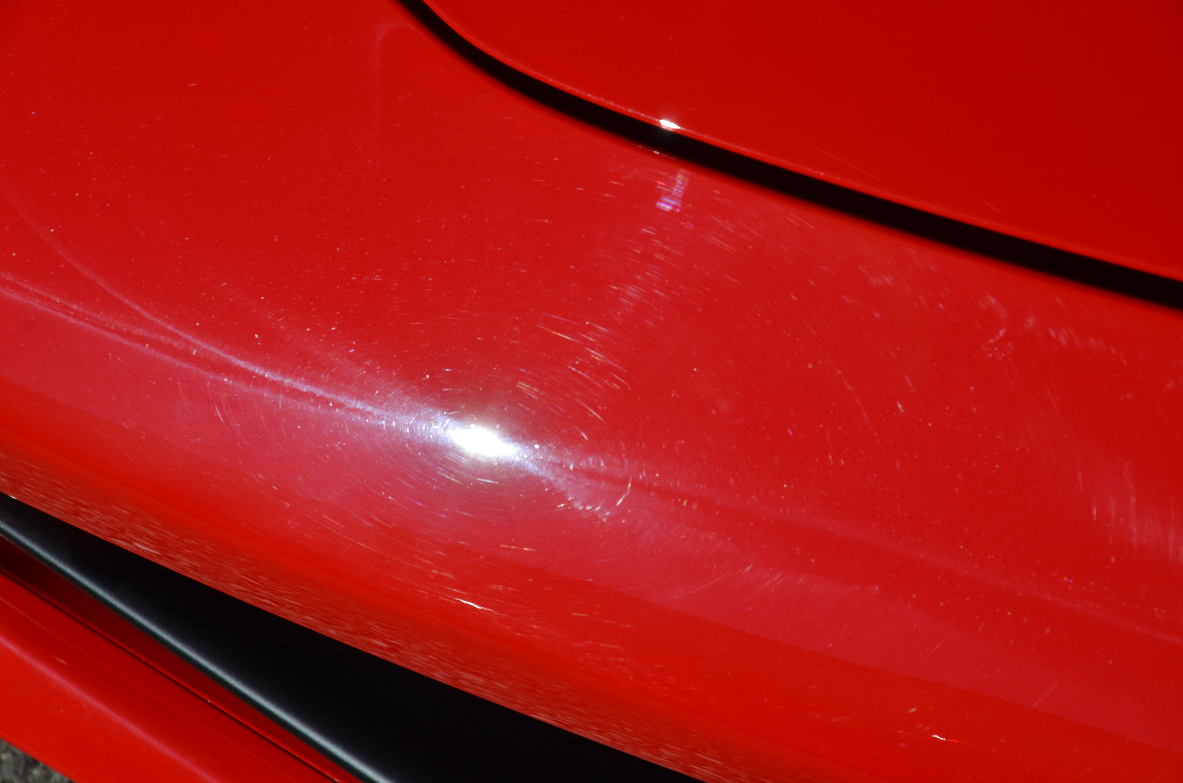

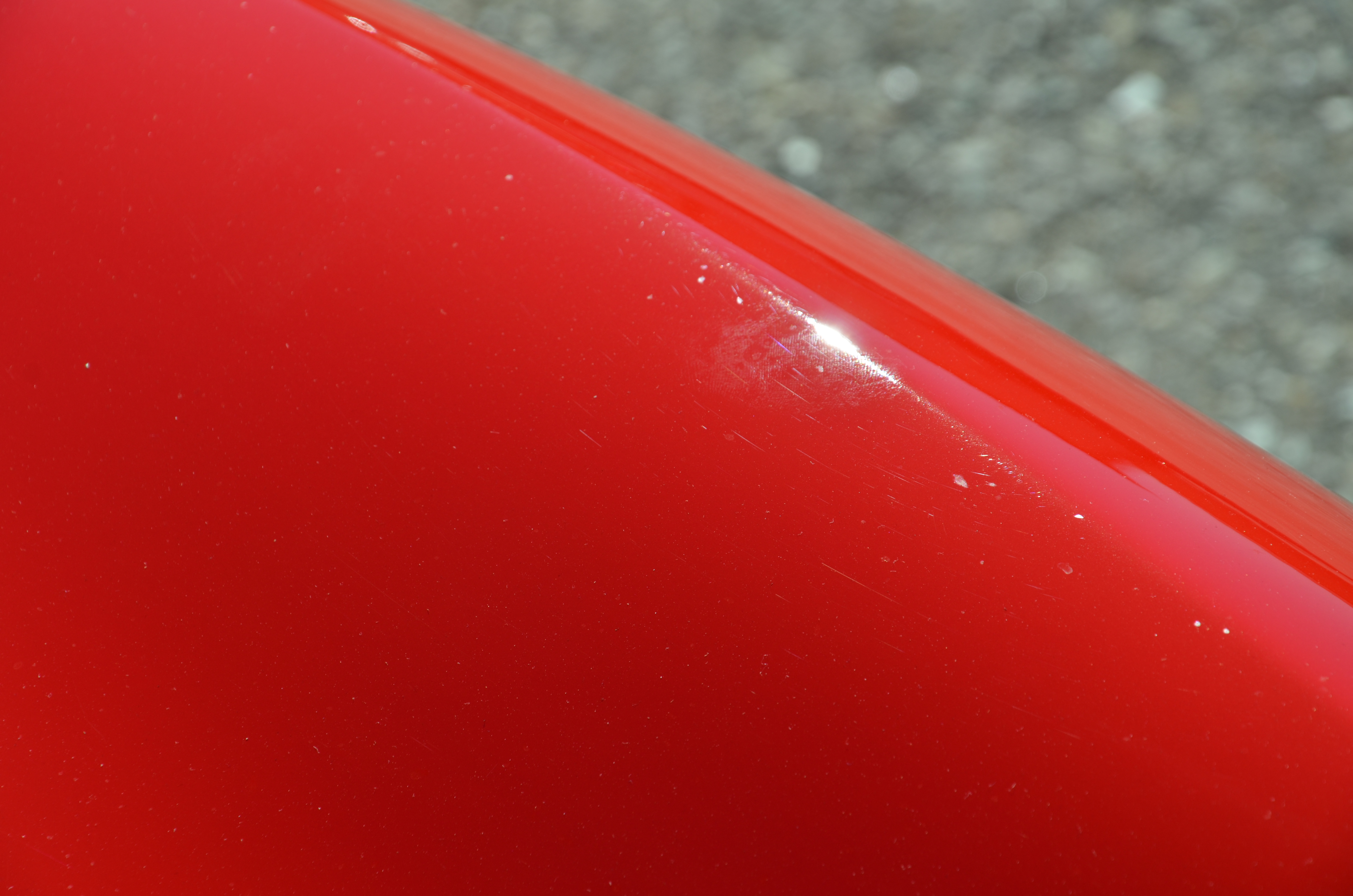

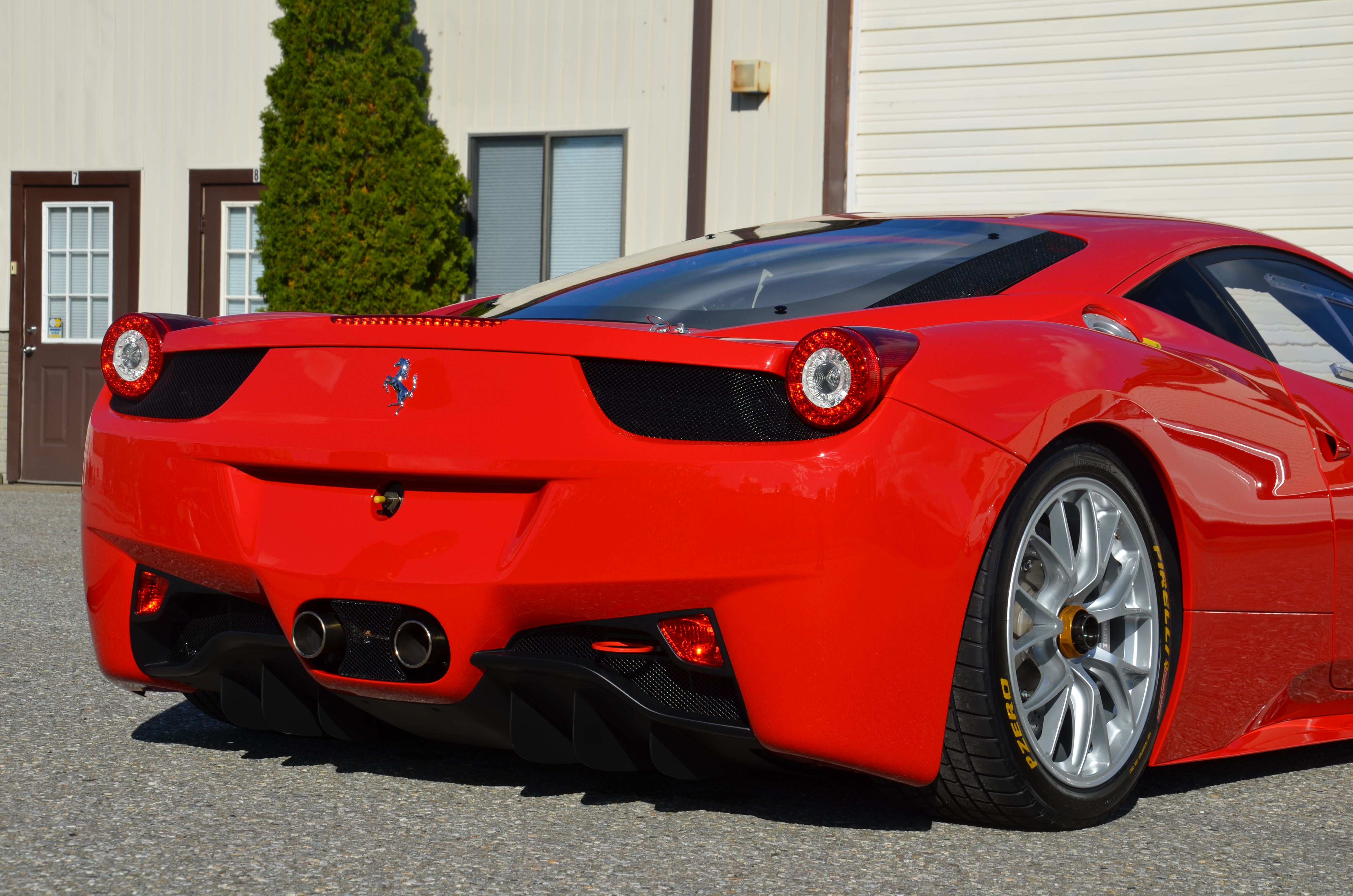

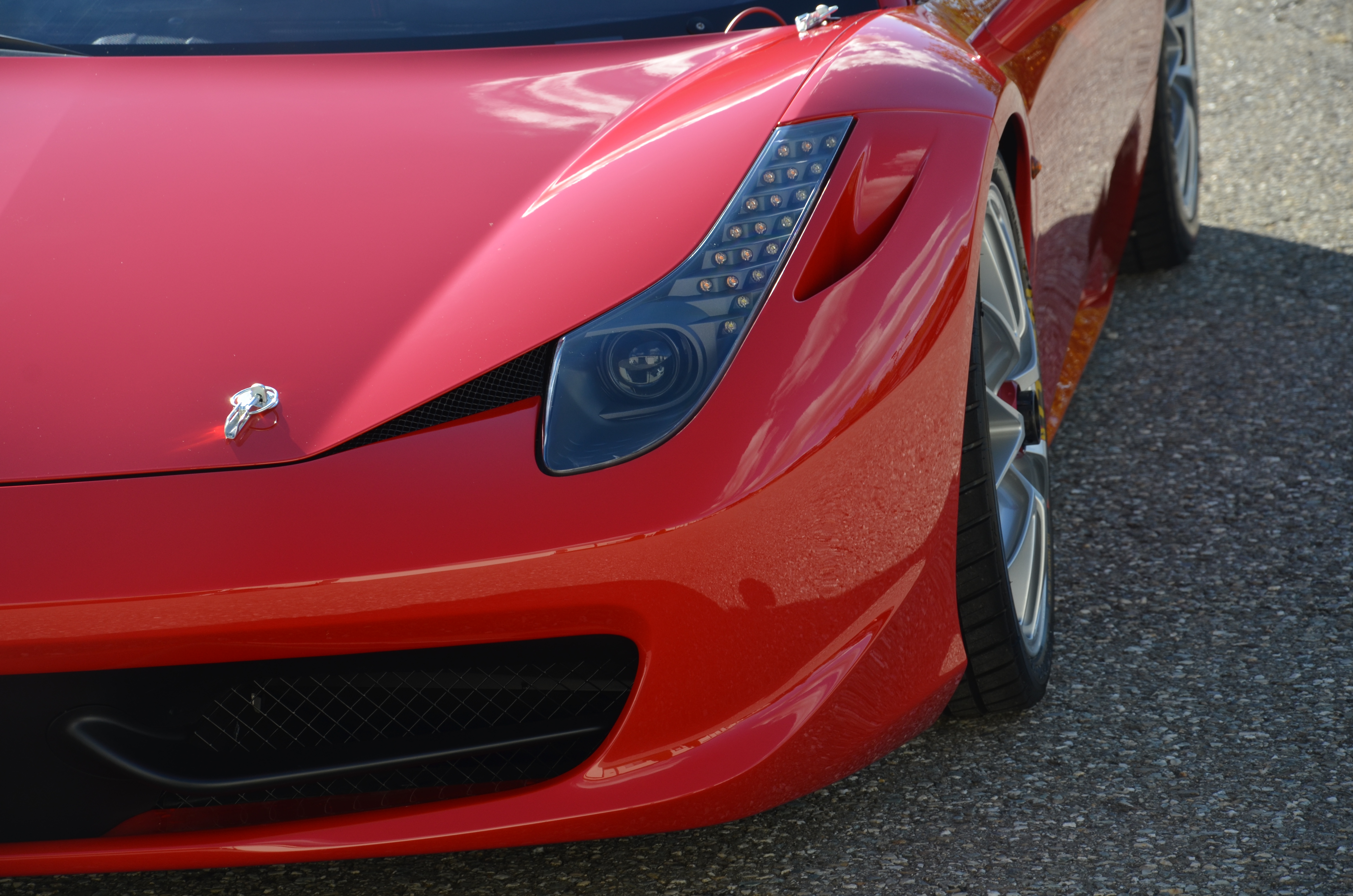

Before
For a few feet the car looked great.
Upon closer inspection we found a lot of paint imperfections. - Swirls, holograms, sand scratches were all visible

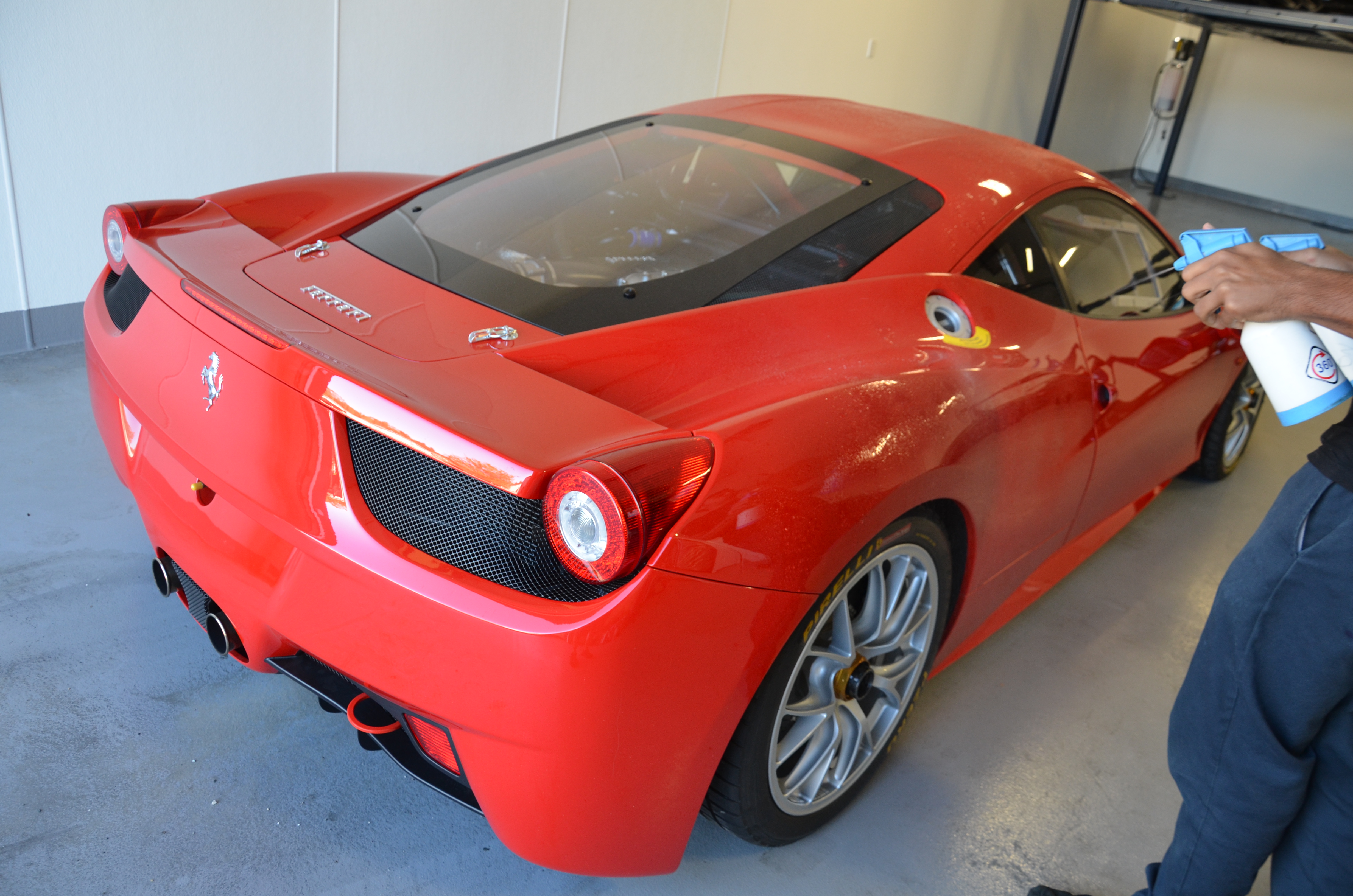

Prep - wash - clay - wheels - tires
The car was just delivered so instead of doing a traditional wash we decided to do use Optimum No Rinse for this one.

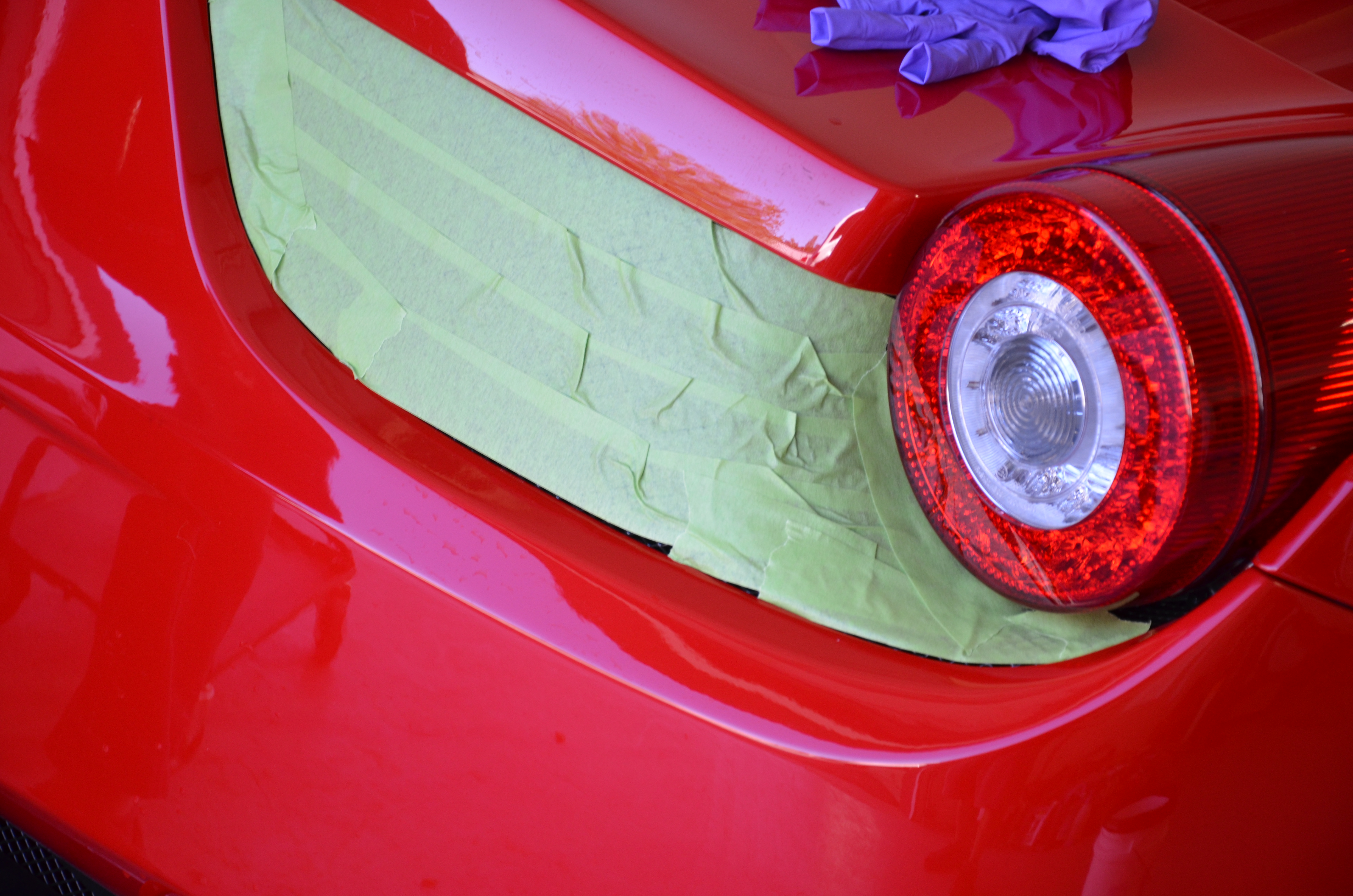

After the complete wash was done including wheels, tires, and claying. We moved on to masking the vehicle. (reasons for masking - protect the trim from damage and to reduce the amount of dust getting caked up in crevices and tight spots, reducing clean up)
Compound and Polishing - Paint Correction
Various machines were used to bring the paint back up - Rupes LHR15, Rupes LHR21, Griot's 3 inch DA.
Menzerna FG400 and Sonax Perfect Finish were used to achieve the results that were desired.

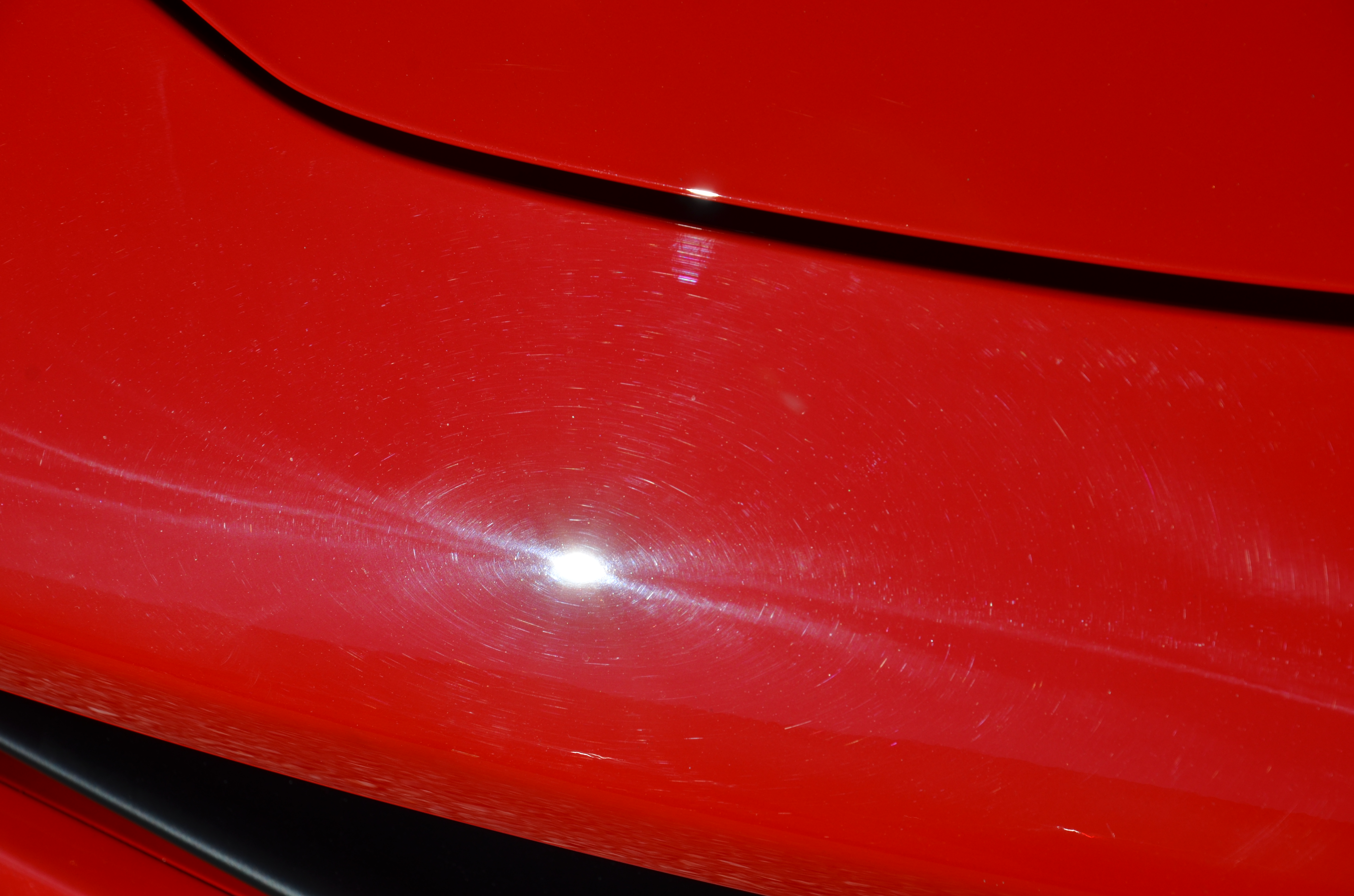

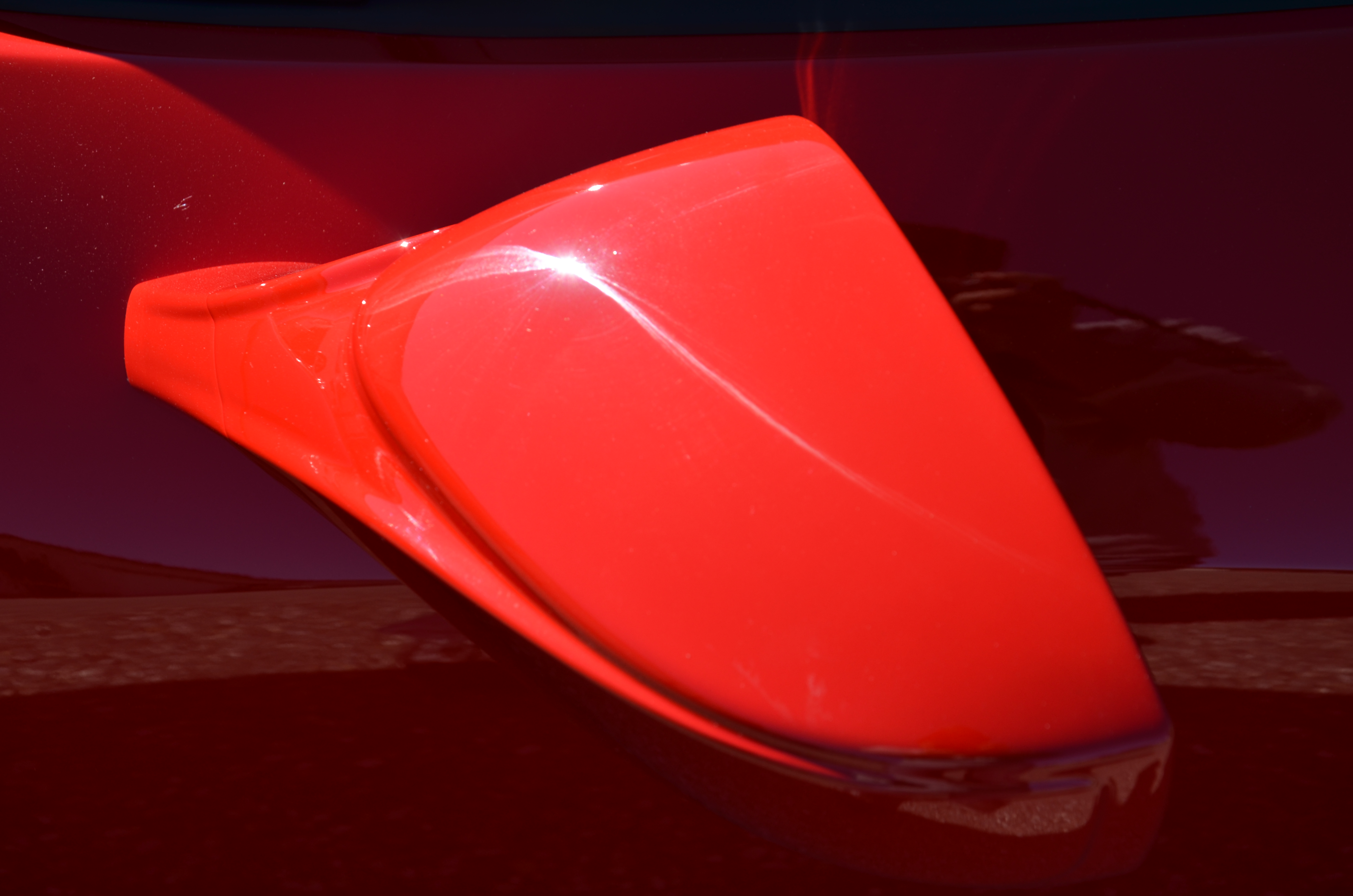

50/50 shot of the correction done - more of these in the video

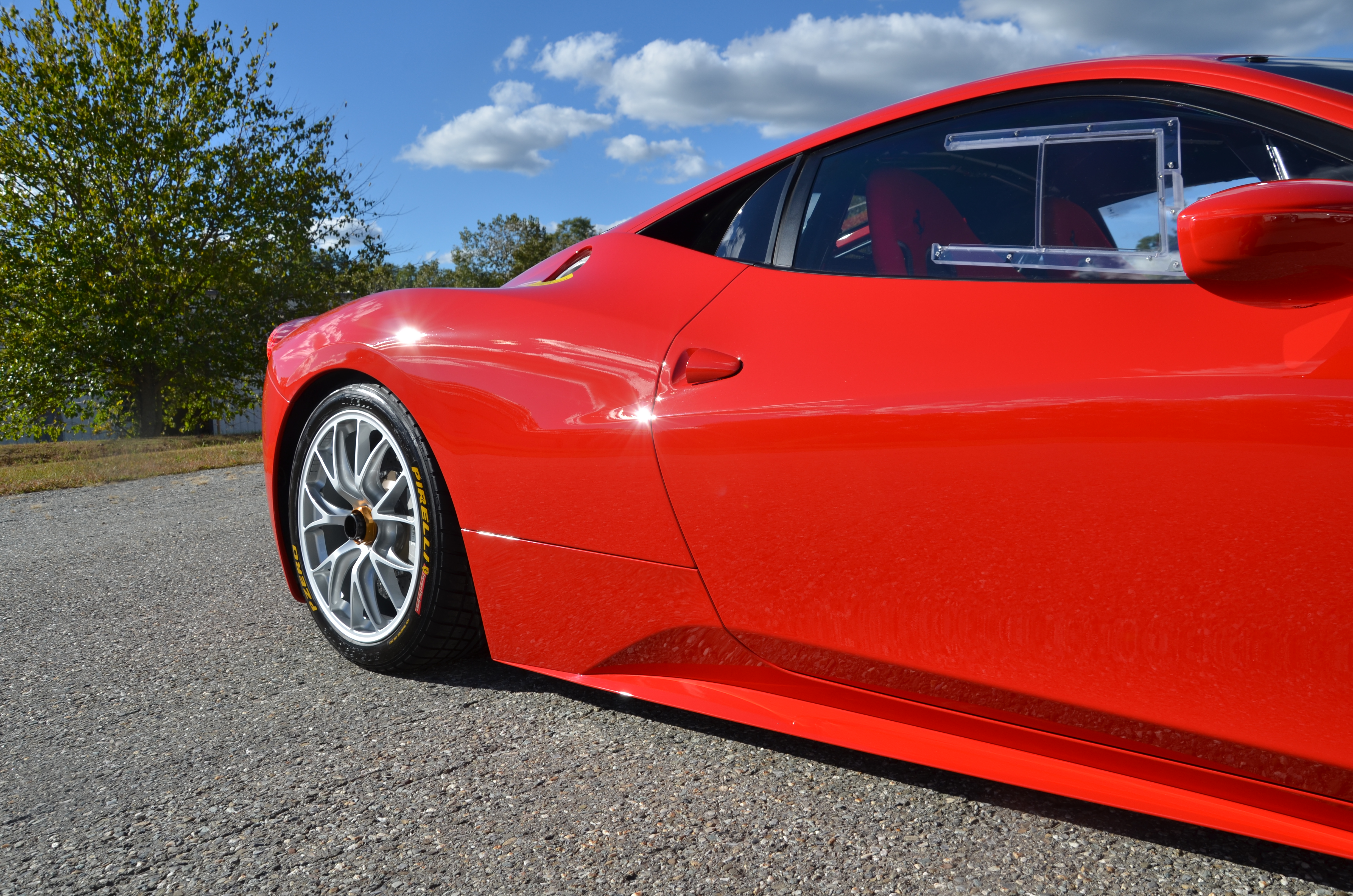

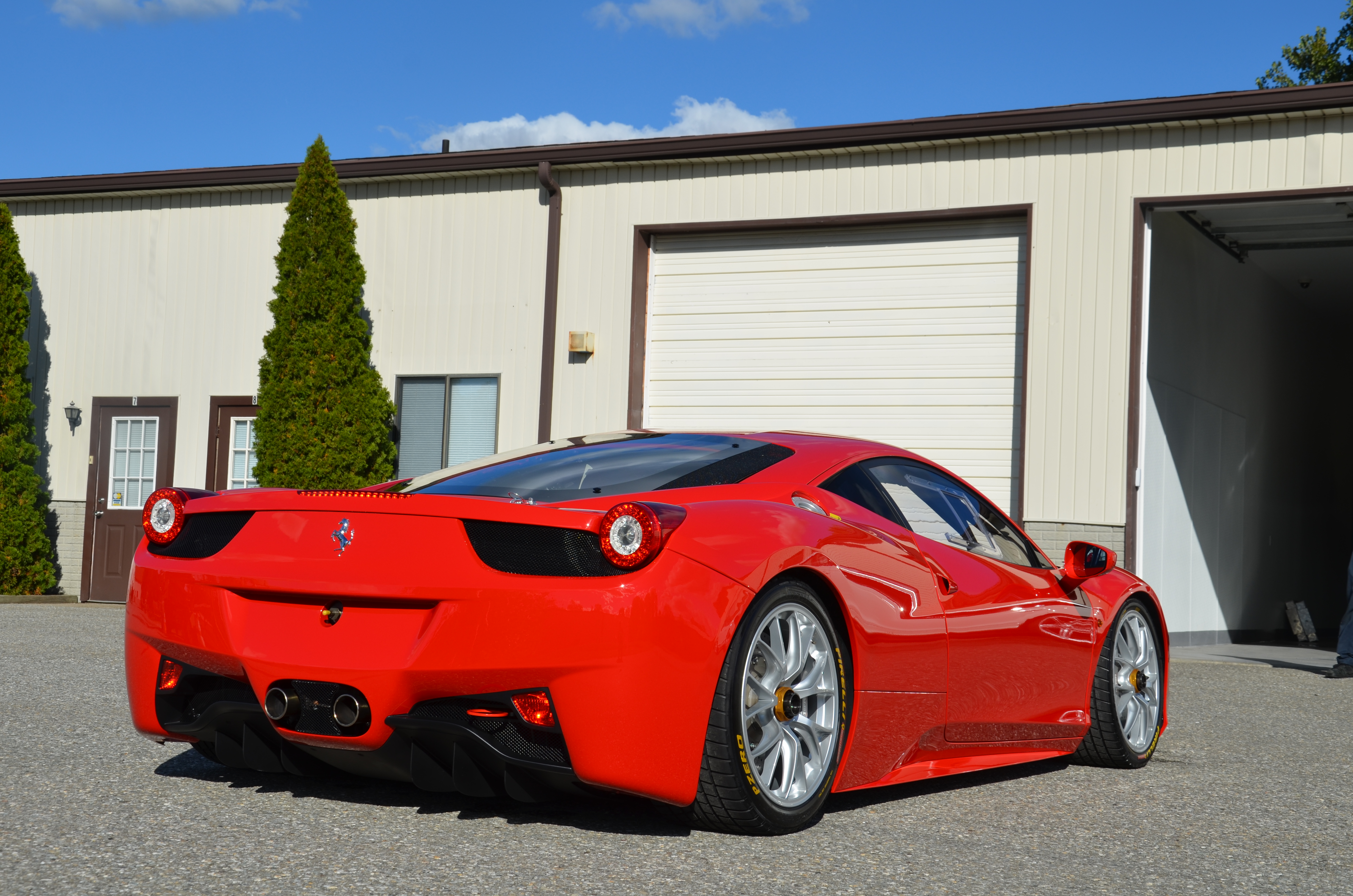

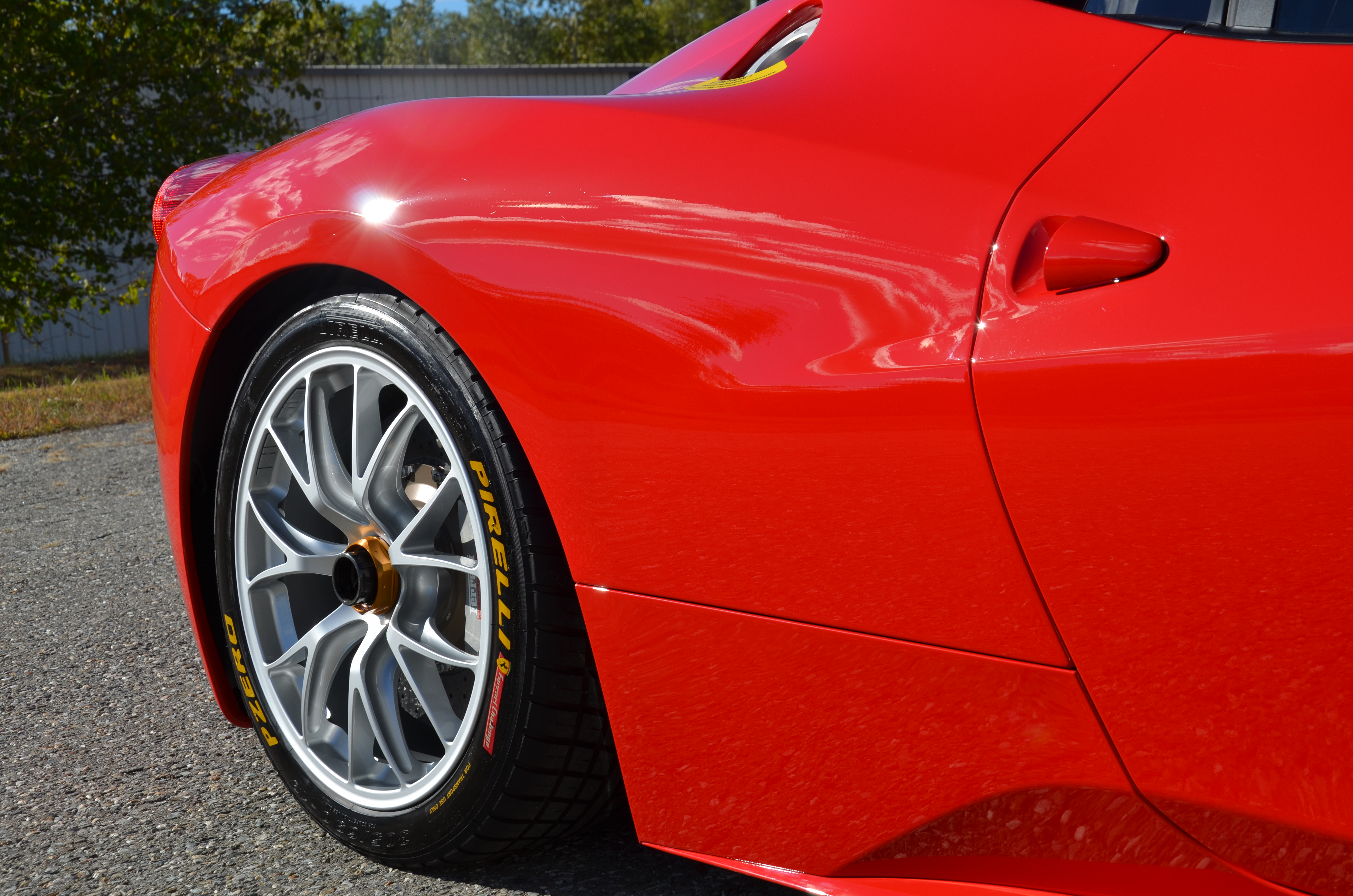

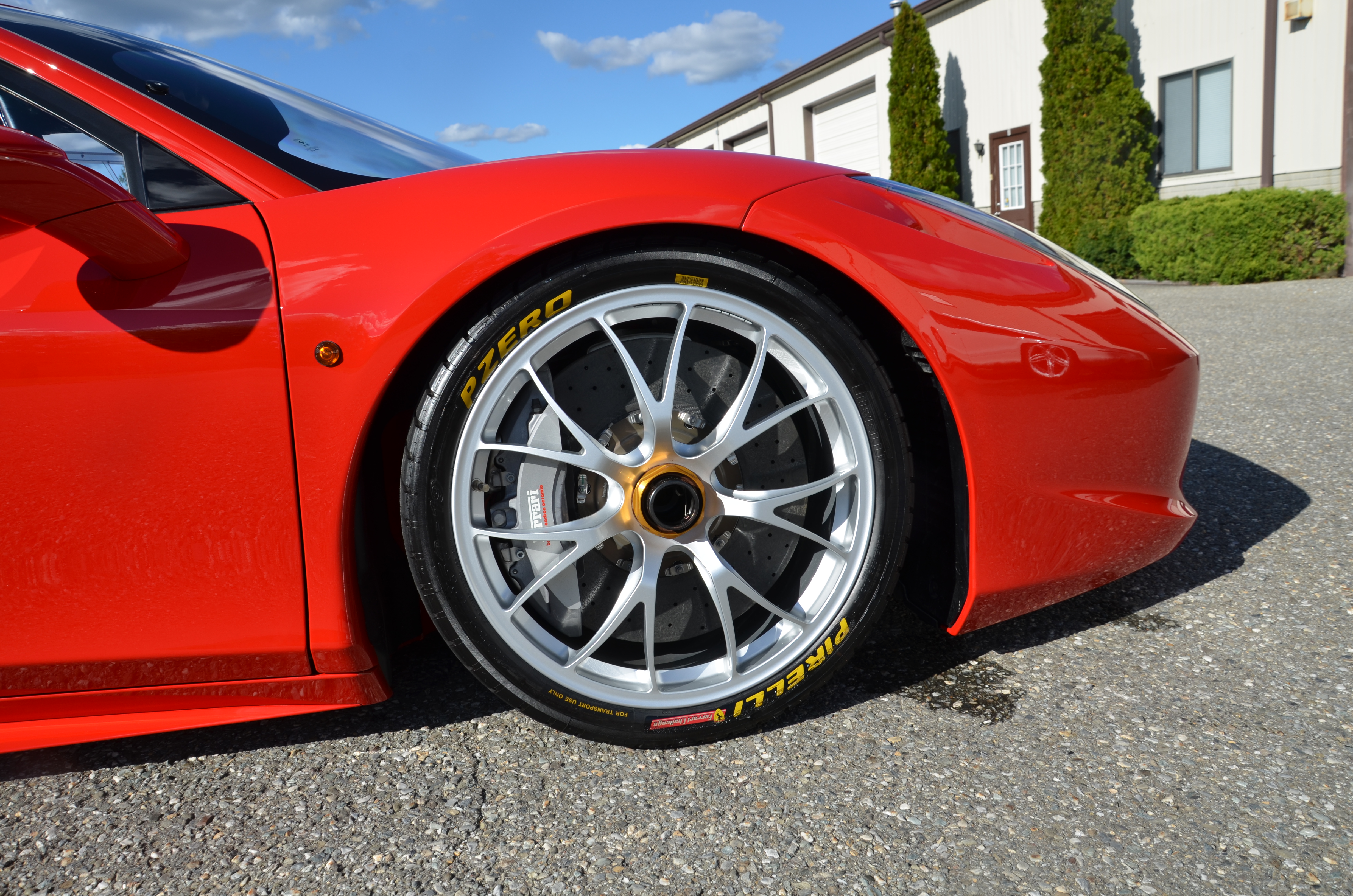

After shots - for the last step Opti Coat was applied
I hope you enjoyed this one as much as we did.
