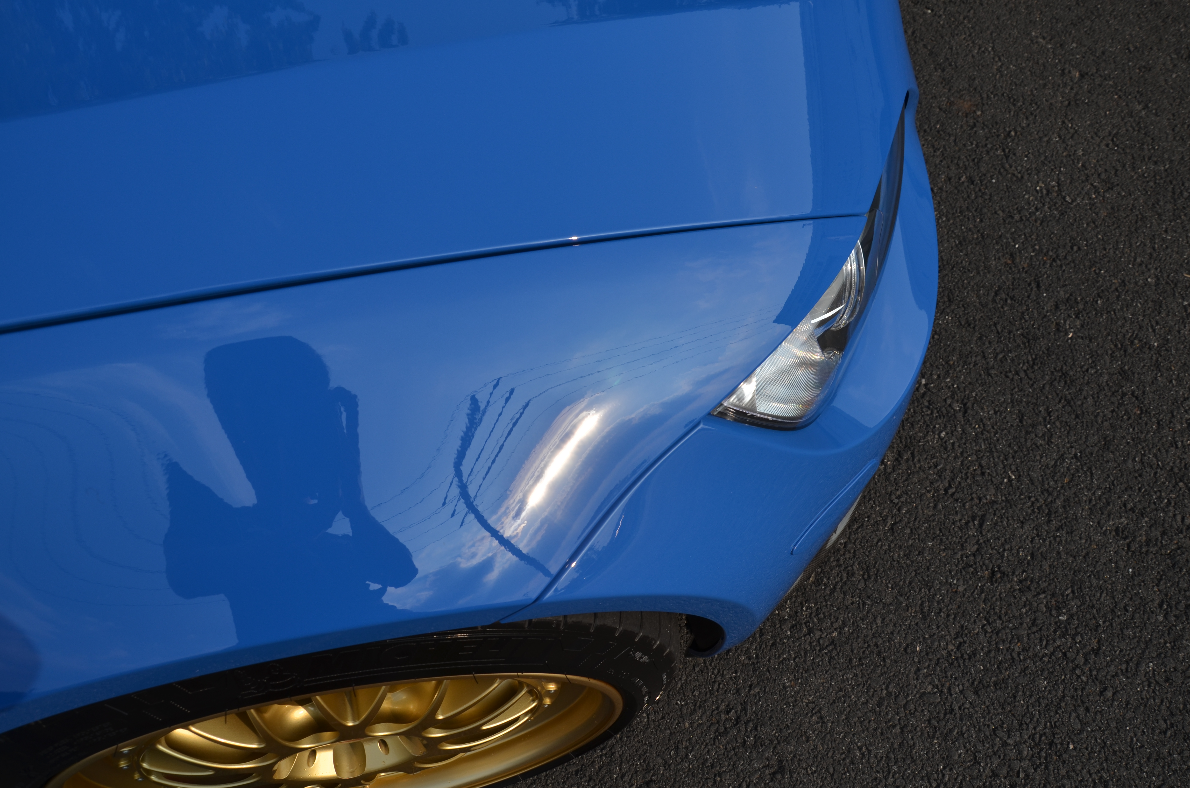

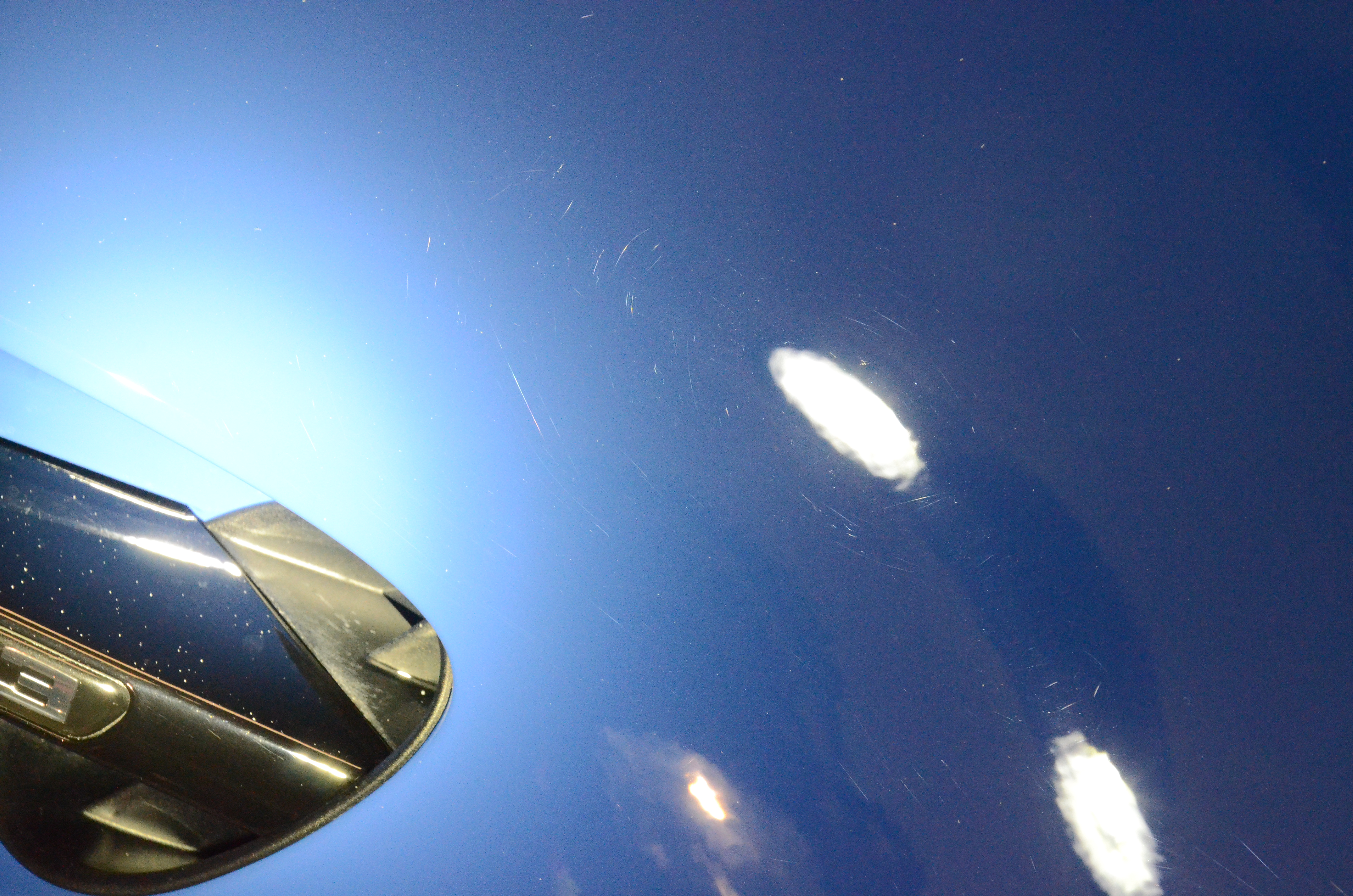

Before shots

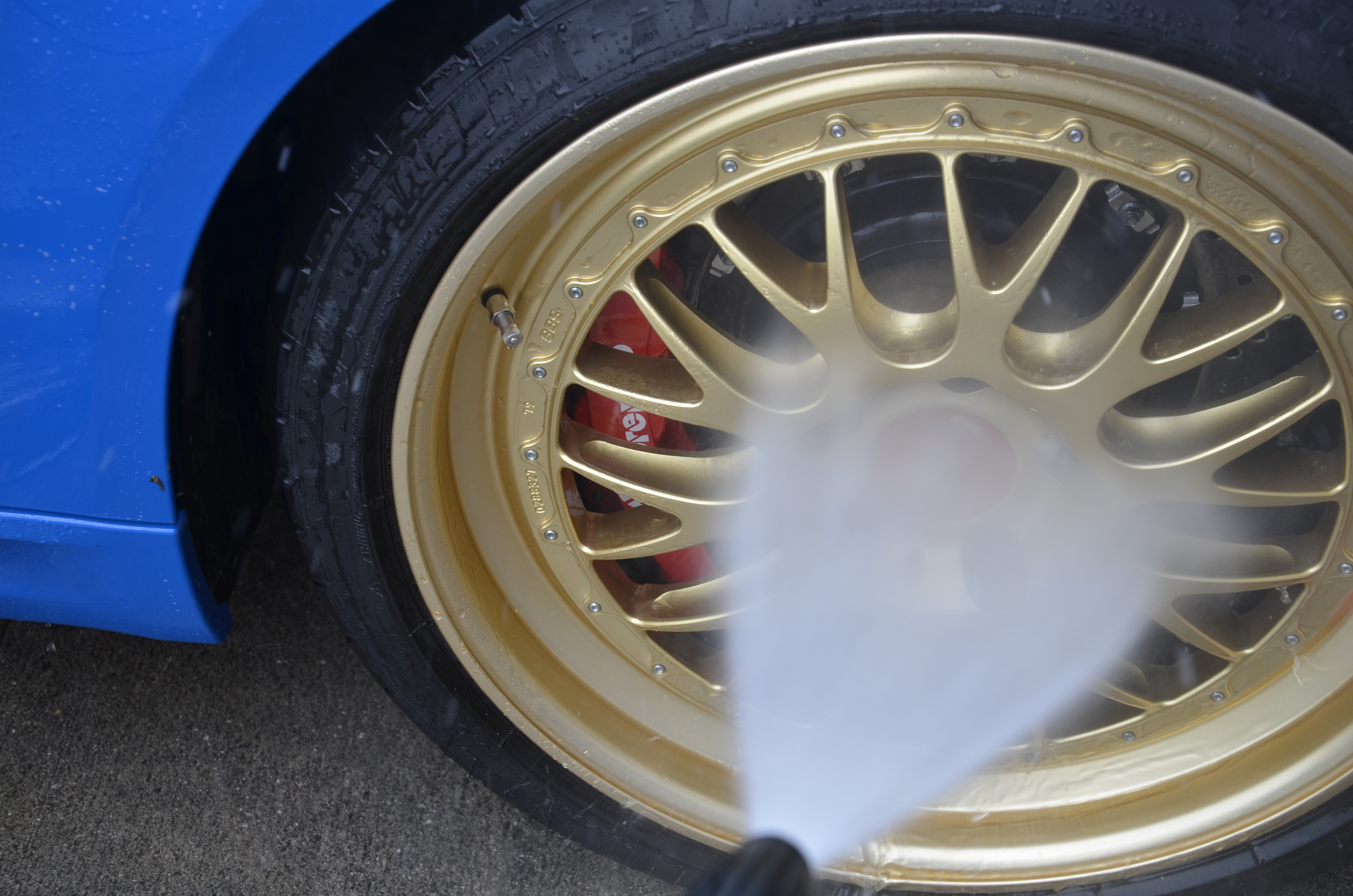

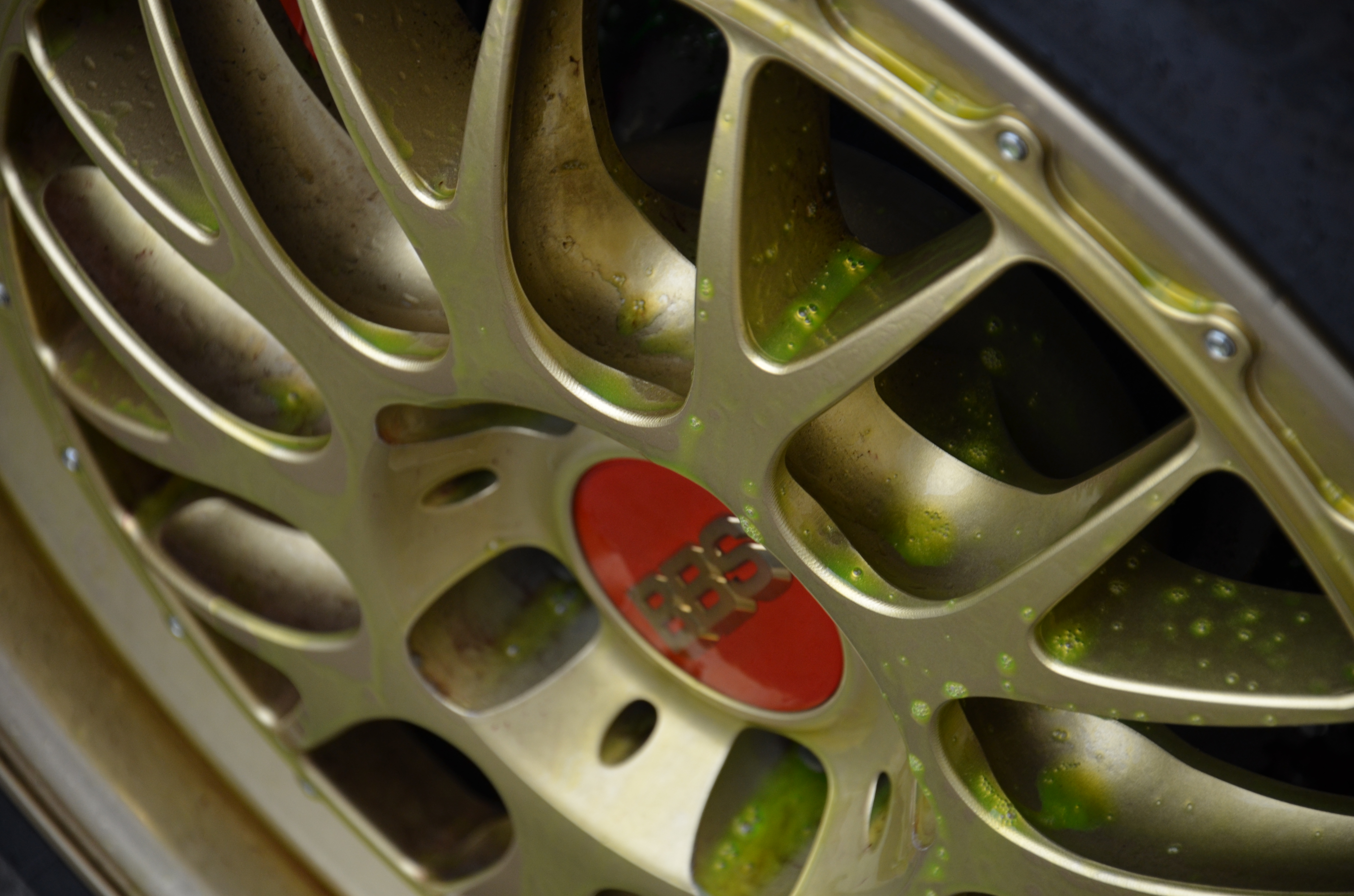

Sonax Full Effect Wheel Cleaner in action
Wheels were brushed then rinsed

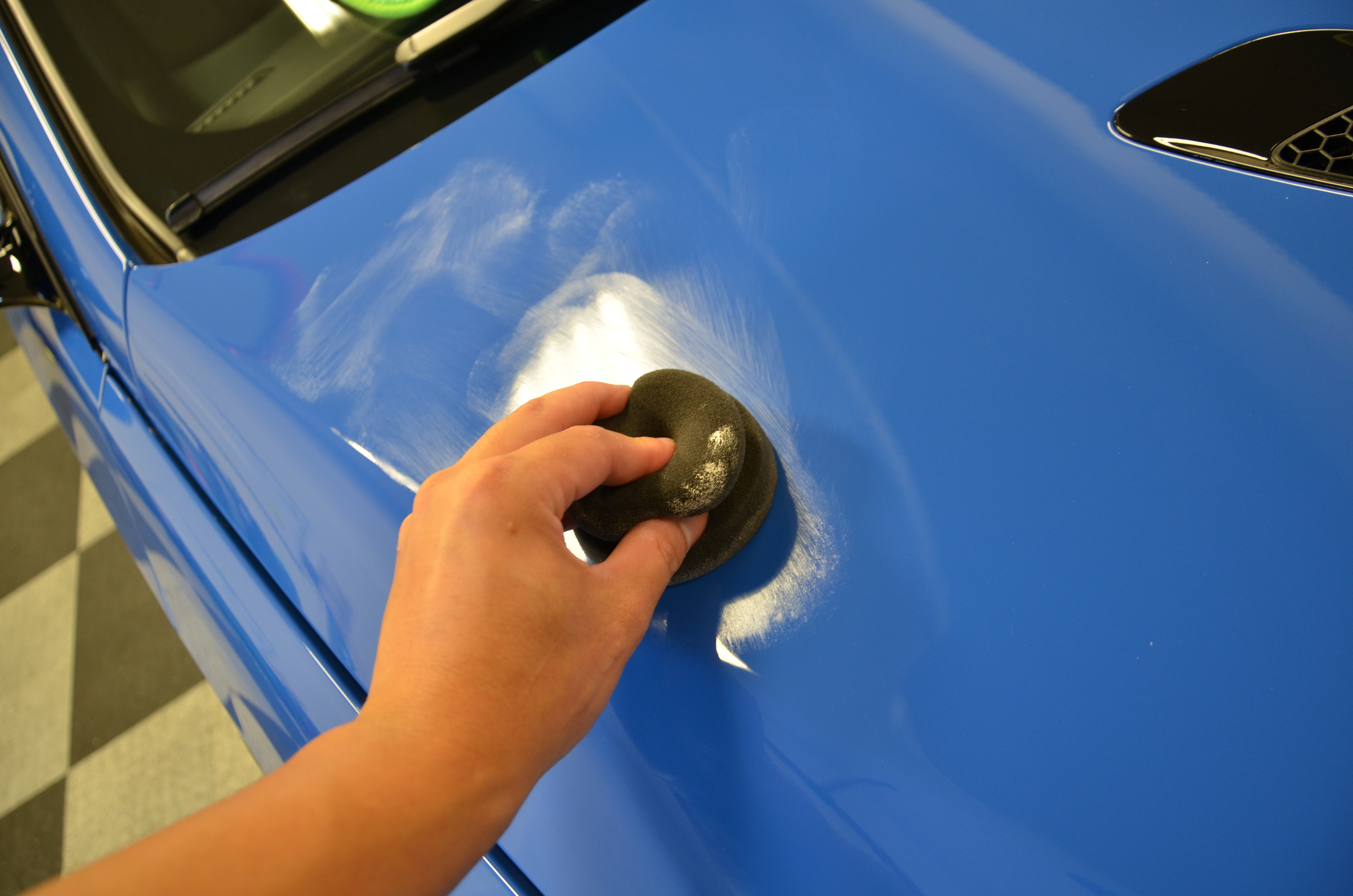

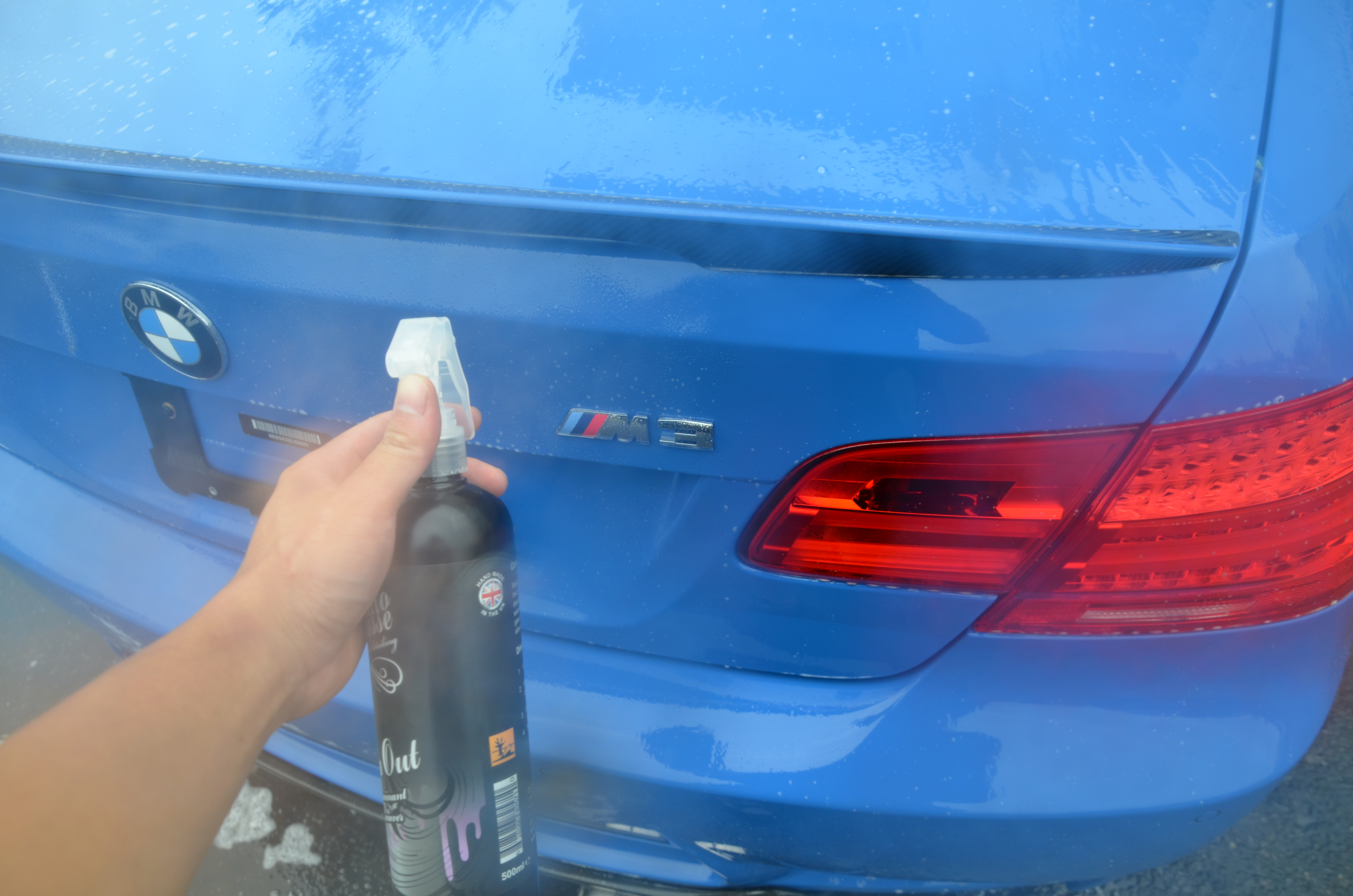

Decon
Auto Finesse Iron Out used prior to NanoSkin Autoscrub Fine Grade Wash Mitt and Clay Bar

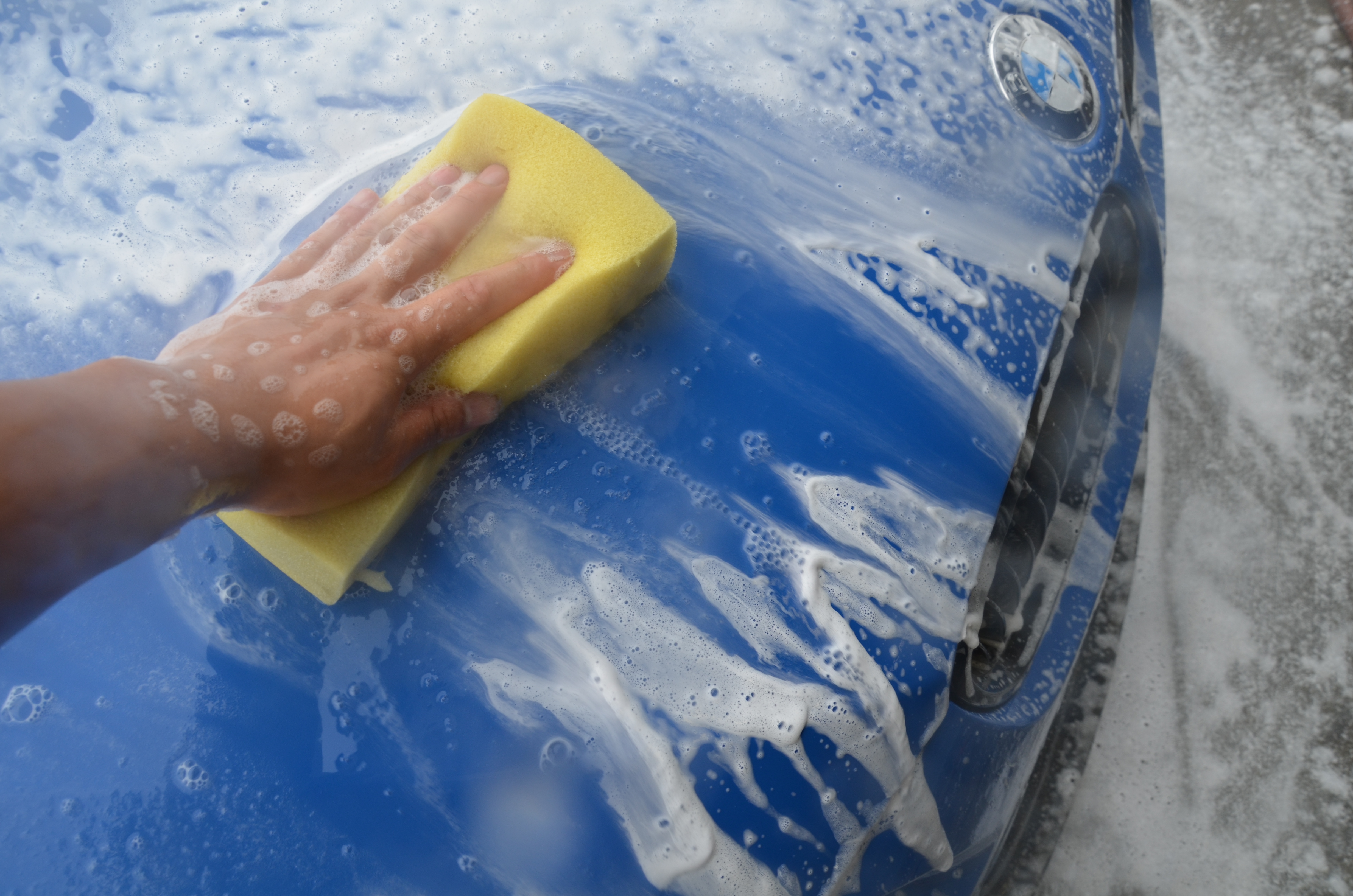

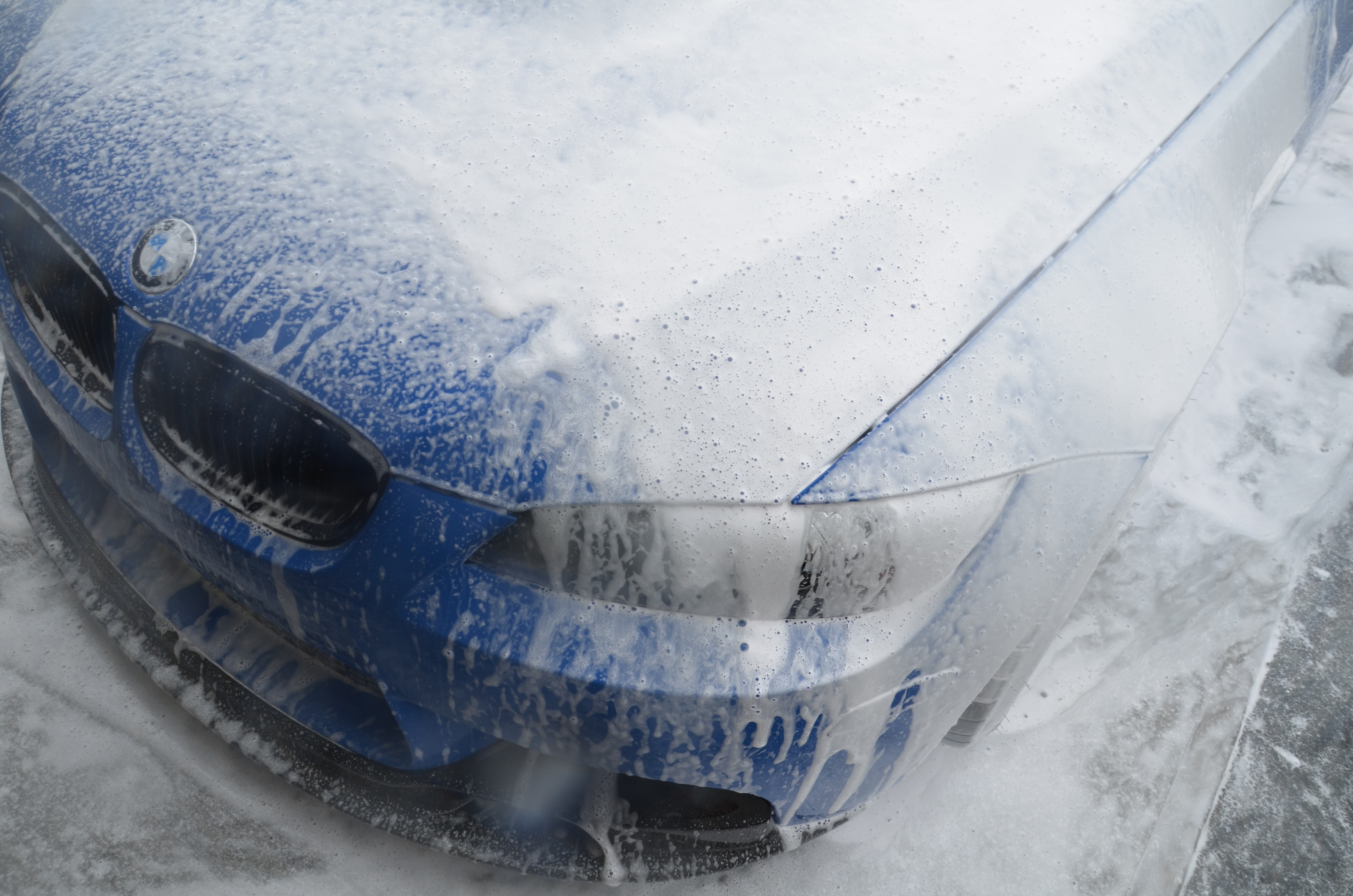

Foaming with Auto Finesse Avalanche and washed down with and Uber Yellow Wash Sponge followed by the NanoSkin AutoScrub Fine Grade Wash Mitt

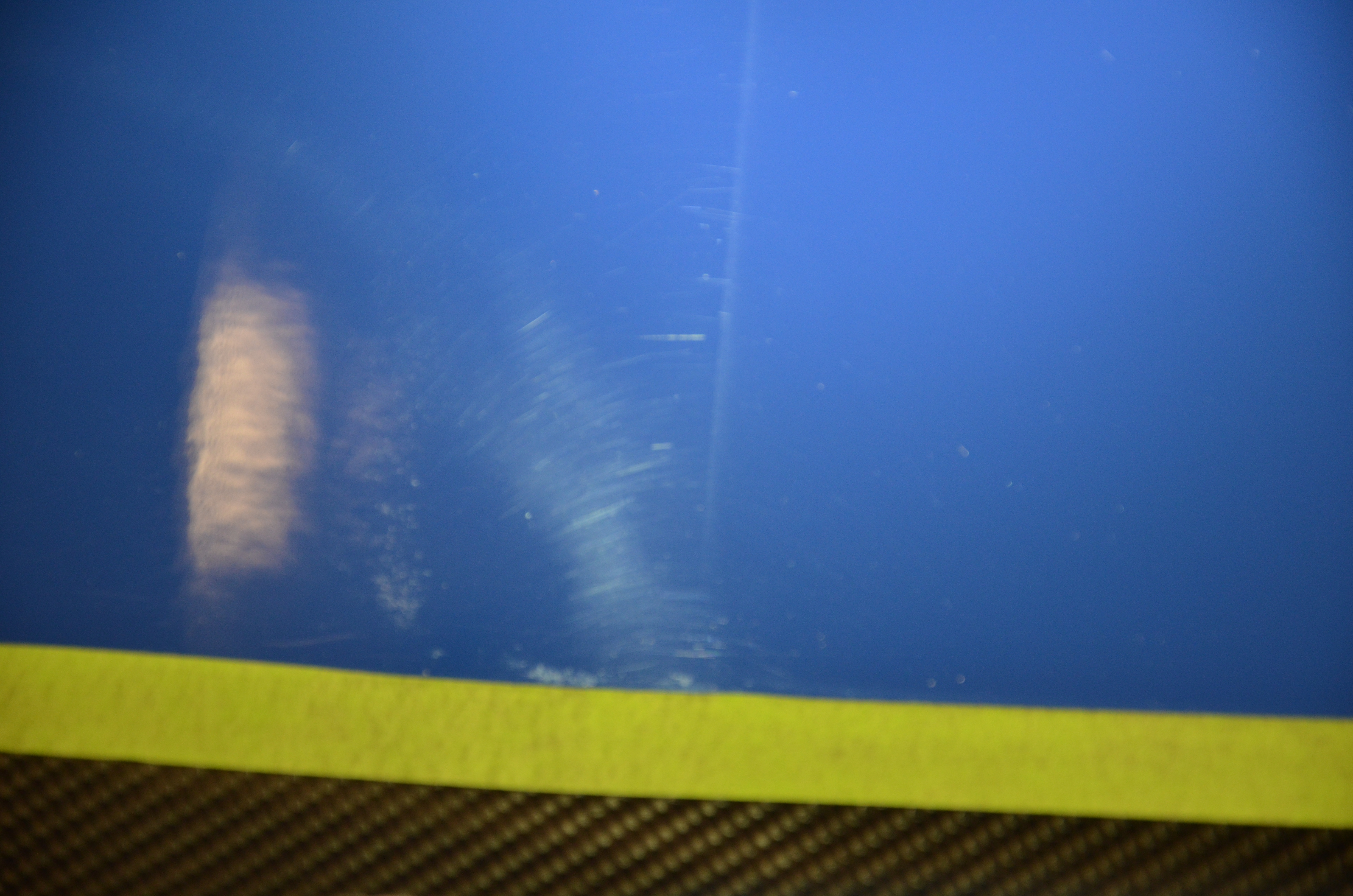

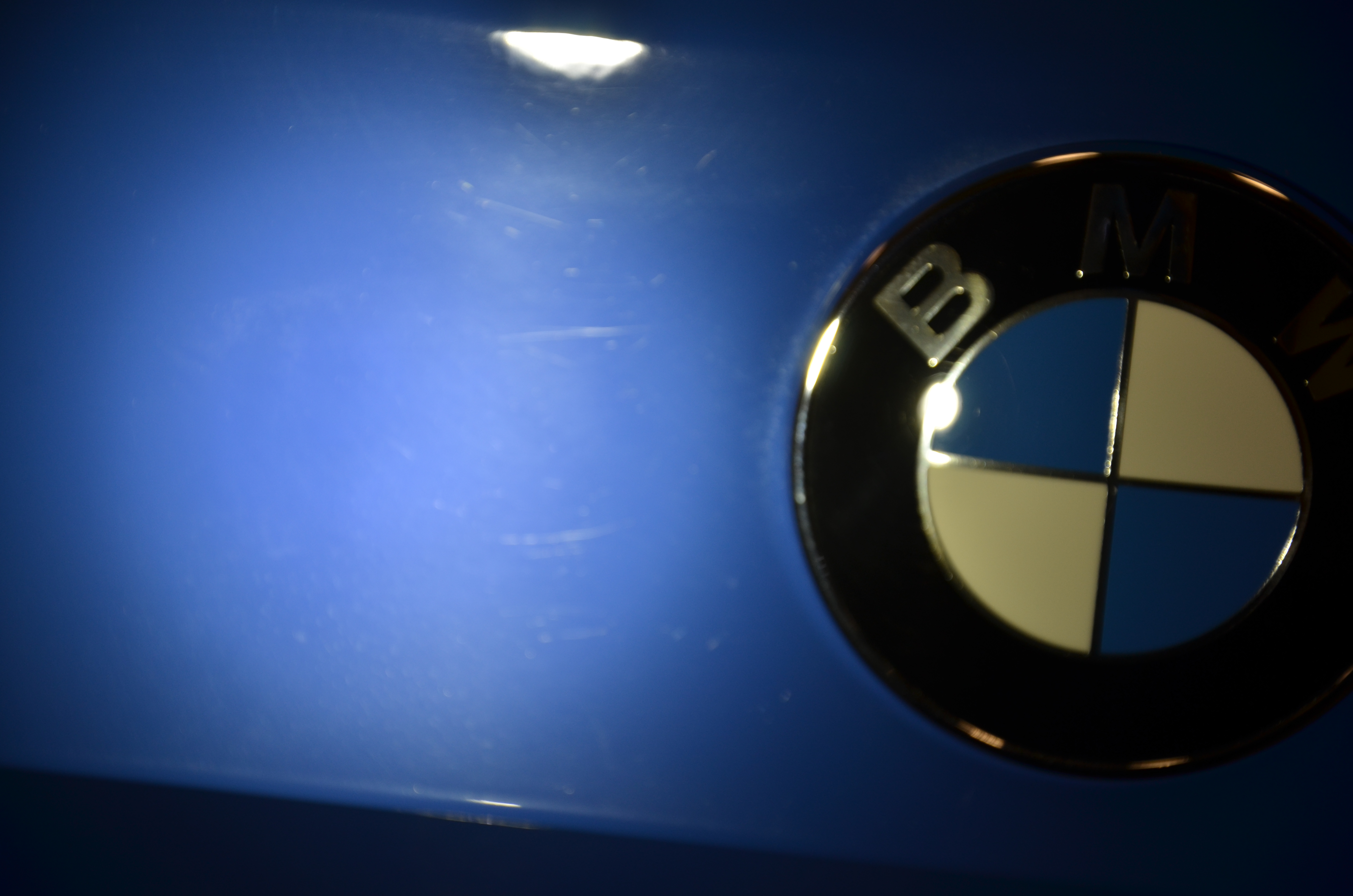

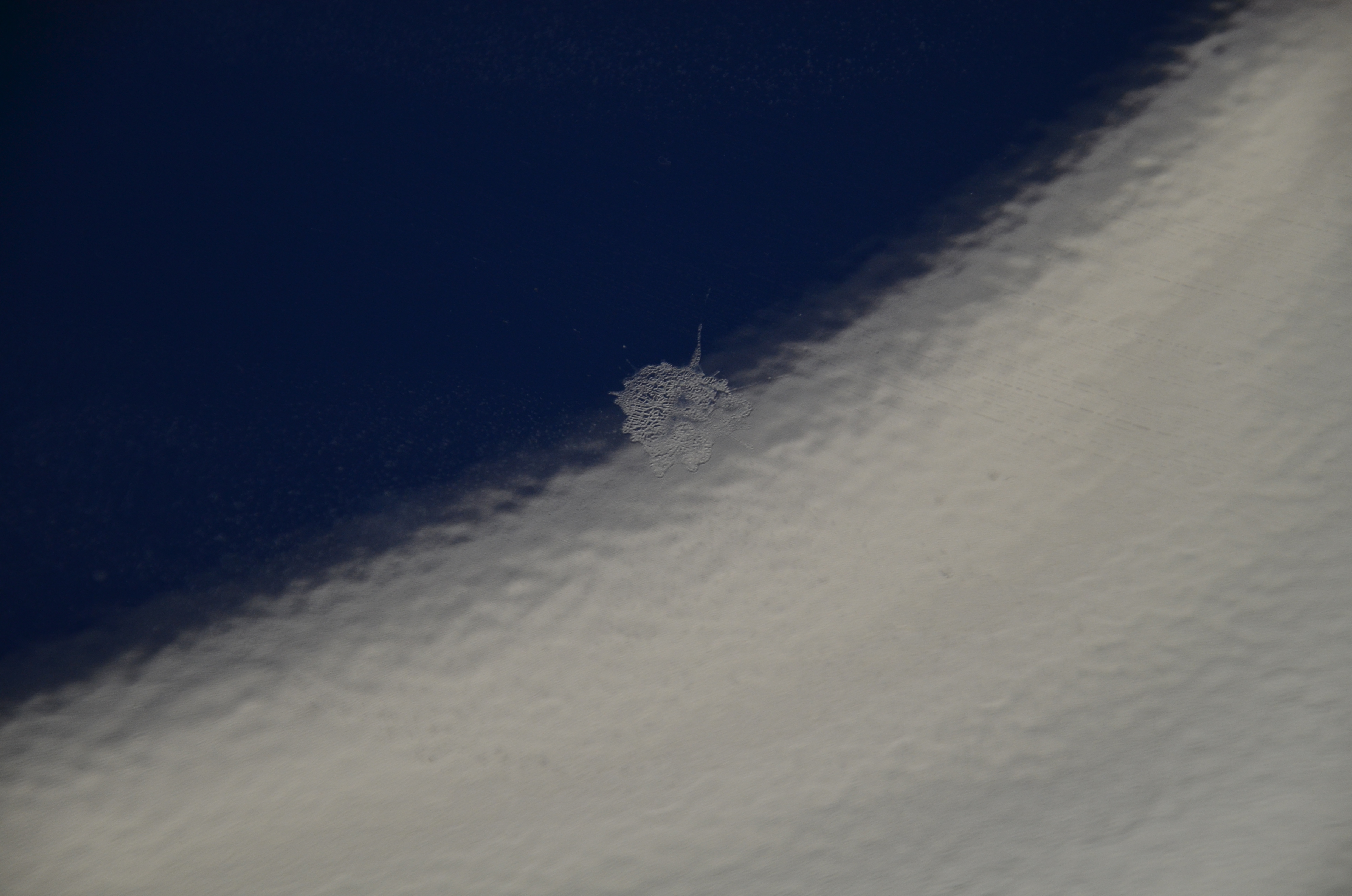

the imperfections on the paint
bird droppings

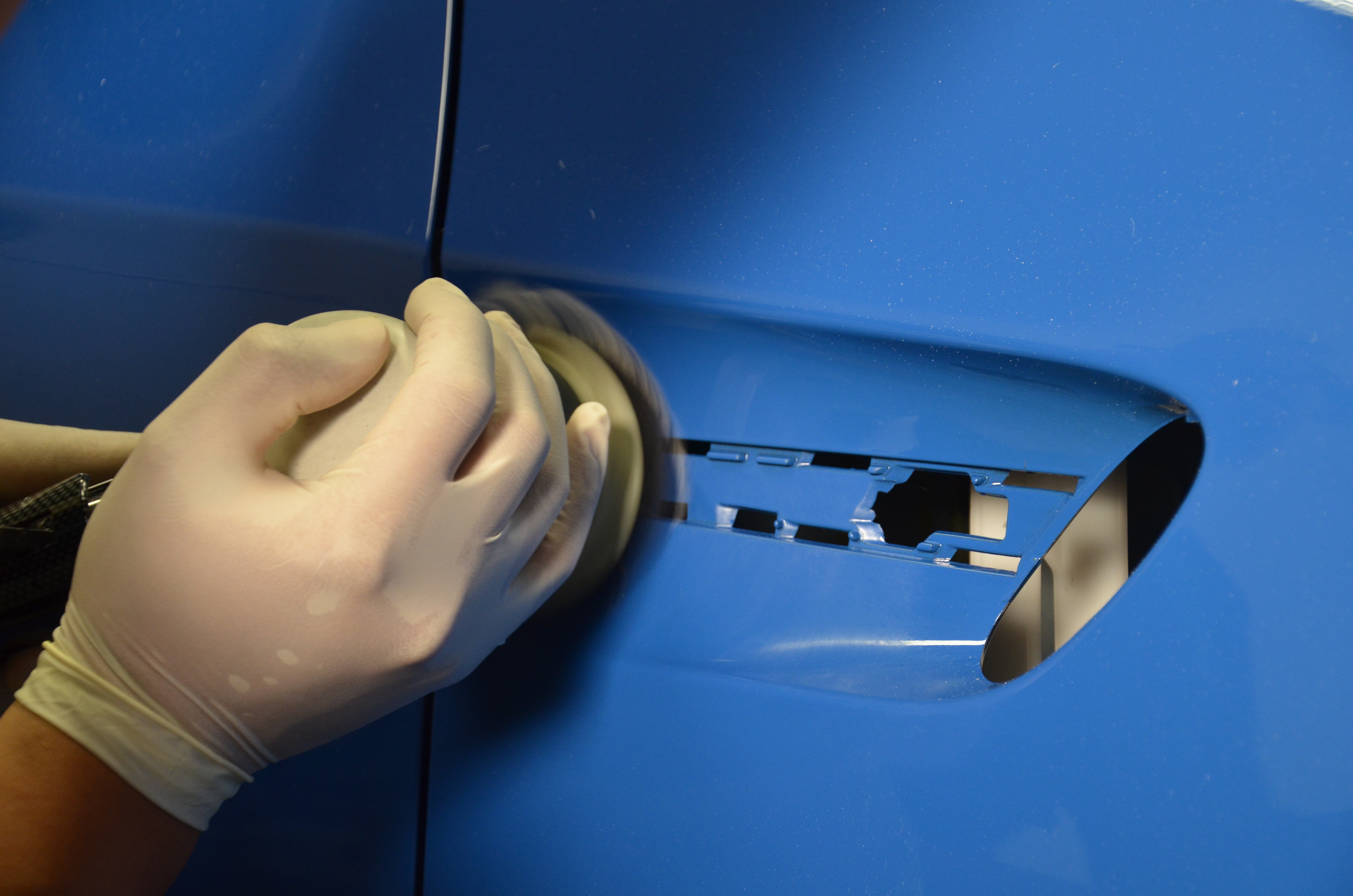

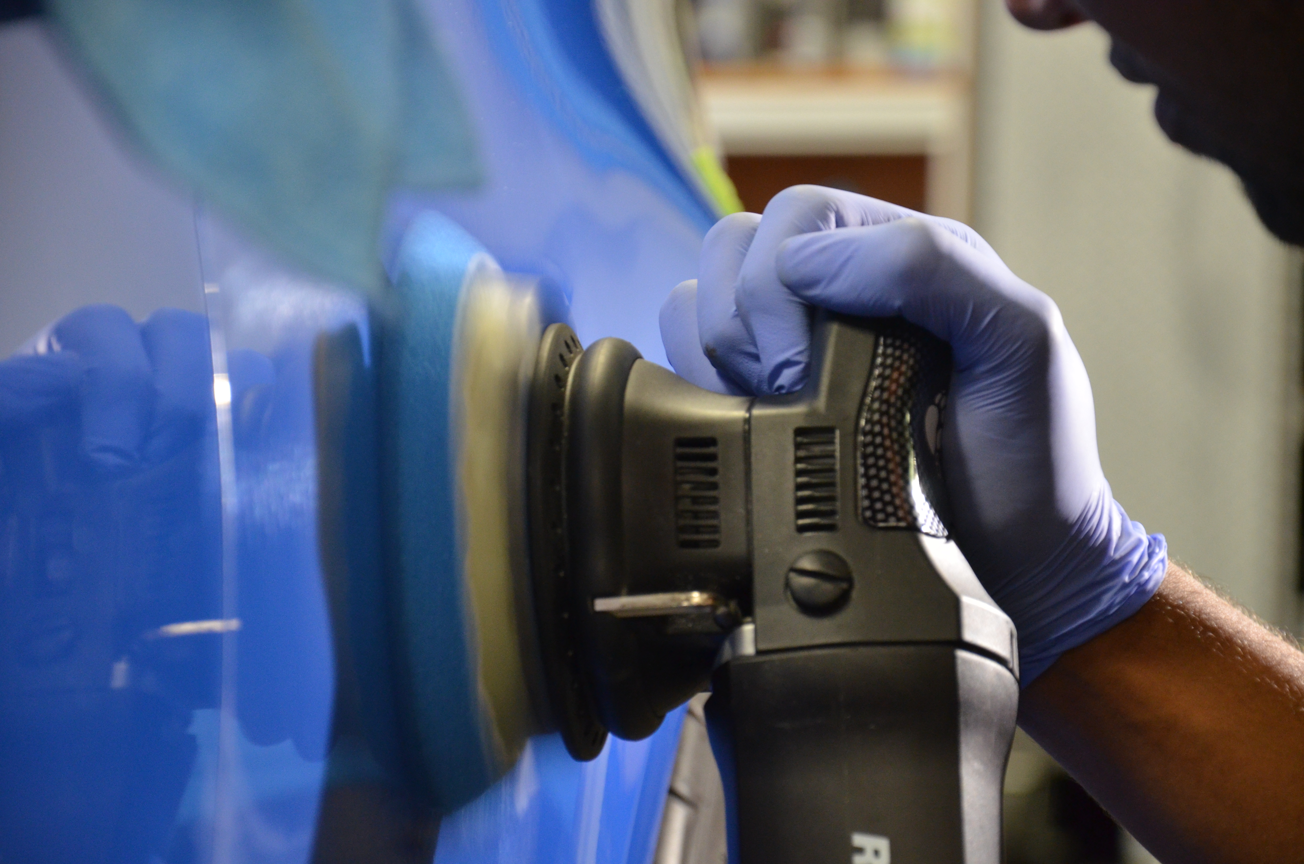

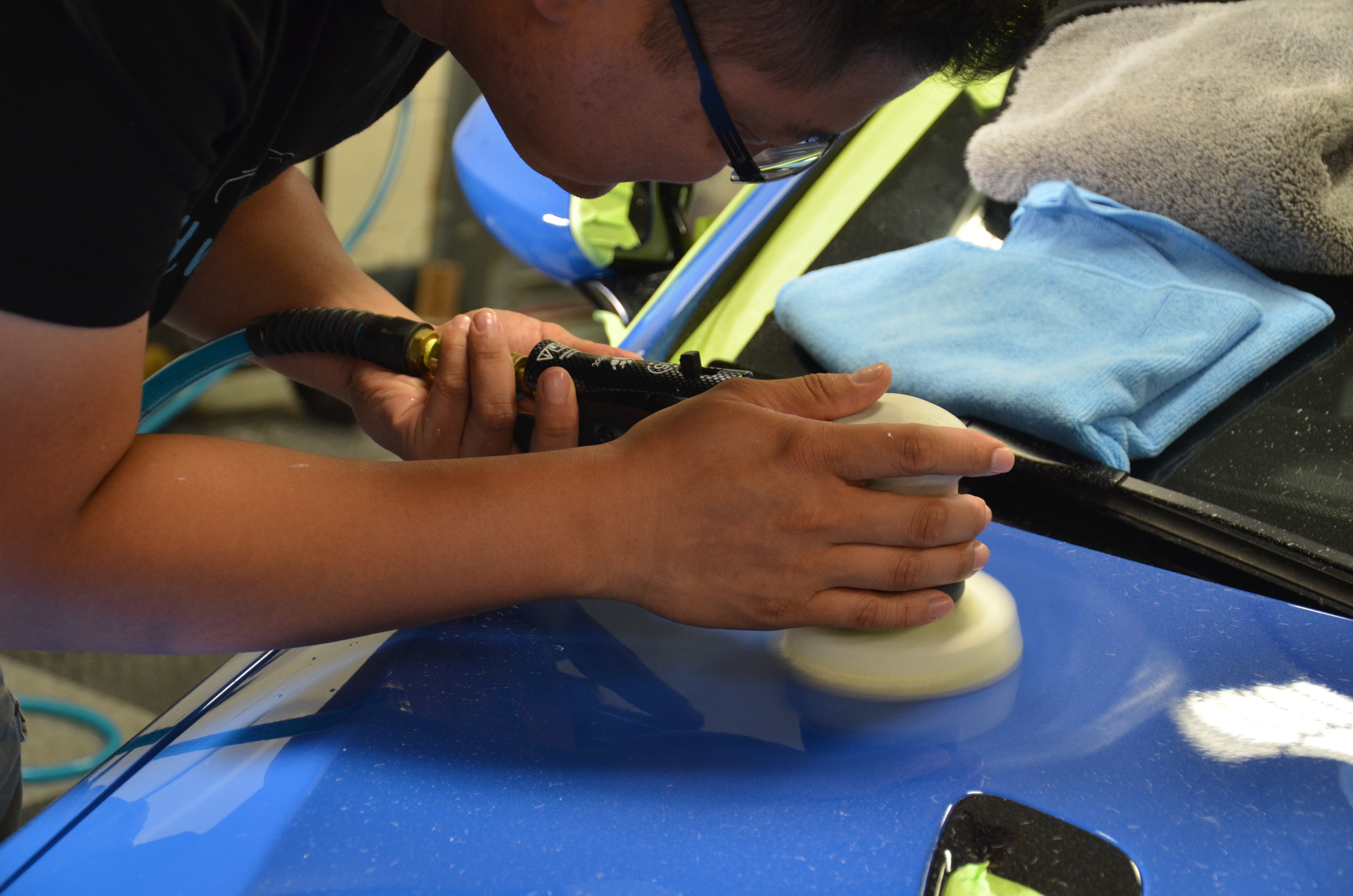

Rupes Bigfoot action shot

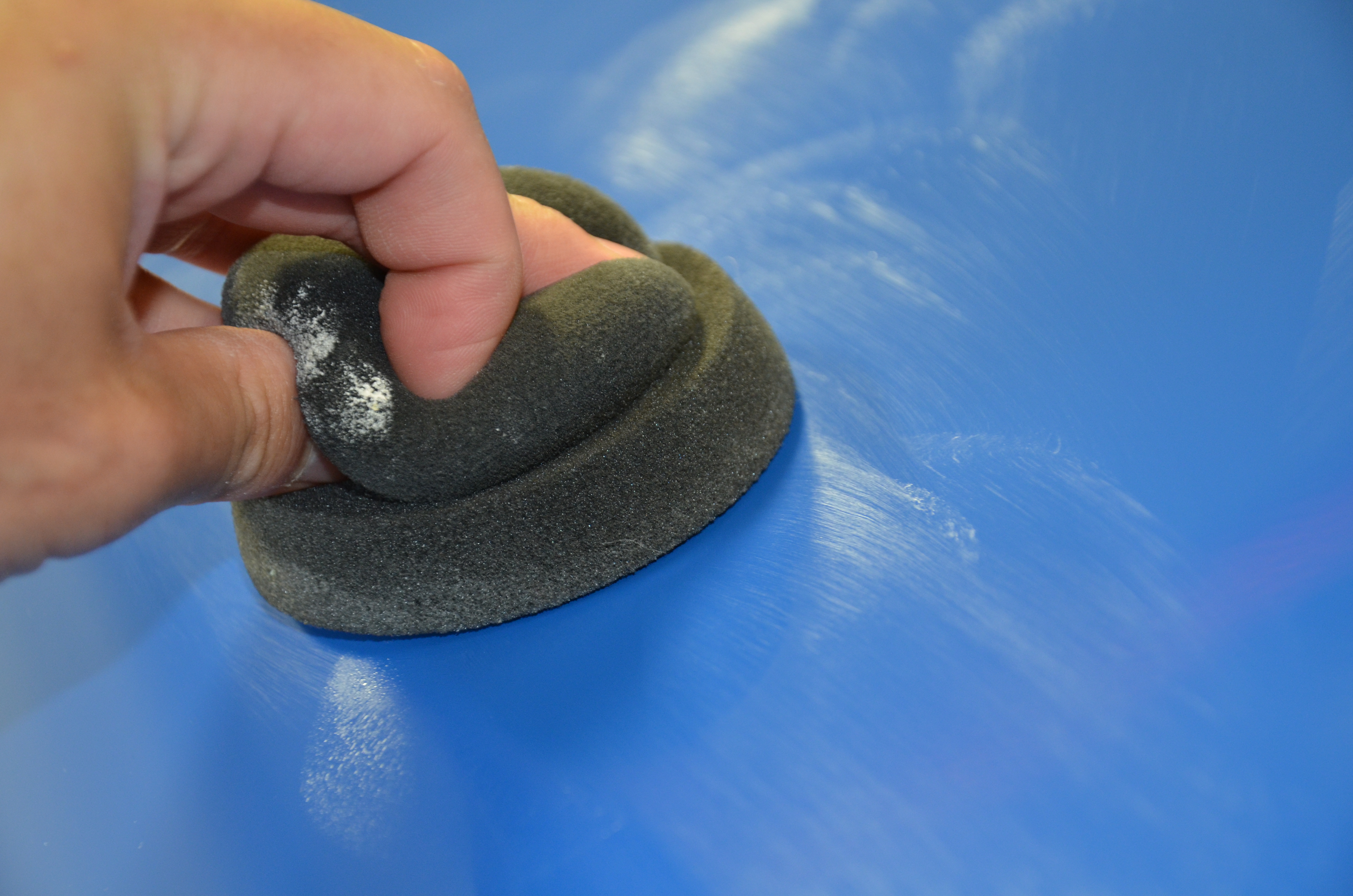

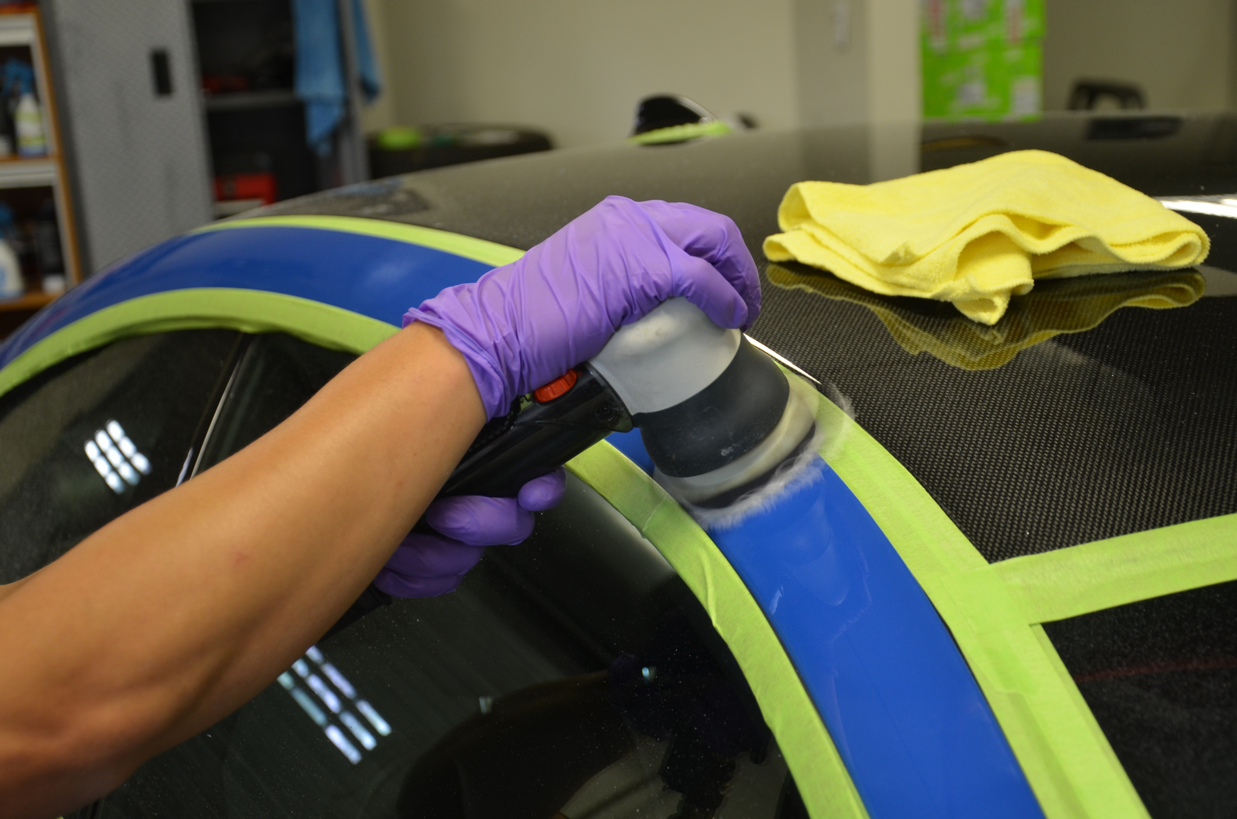

Surbuf pad used to remove the bird etching with Meg's M101 and Menzerna FG400
Following it up with the Meguiar's Microfiber Cutting Pad and Menzerna FG400

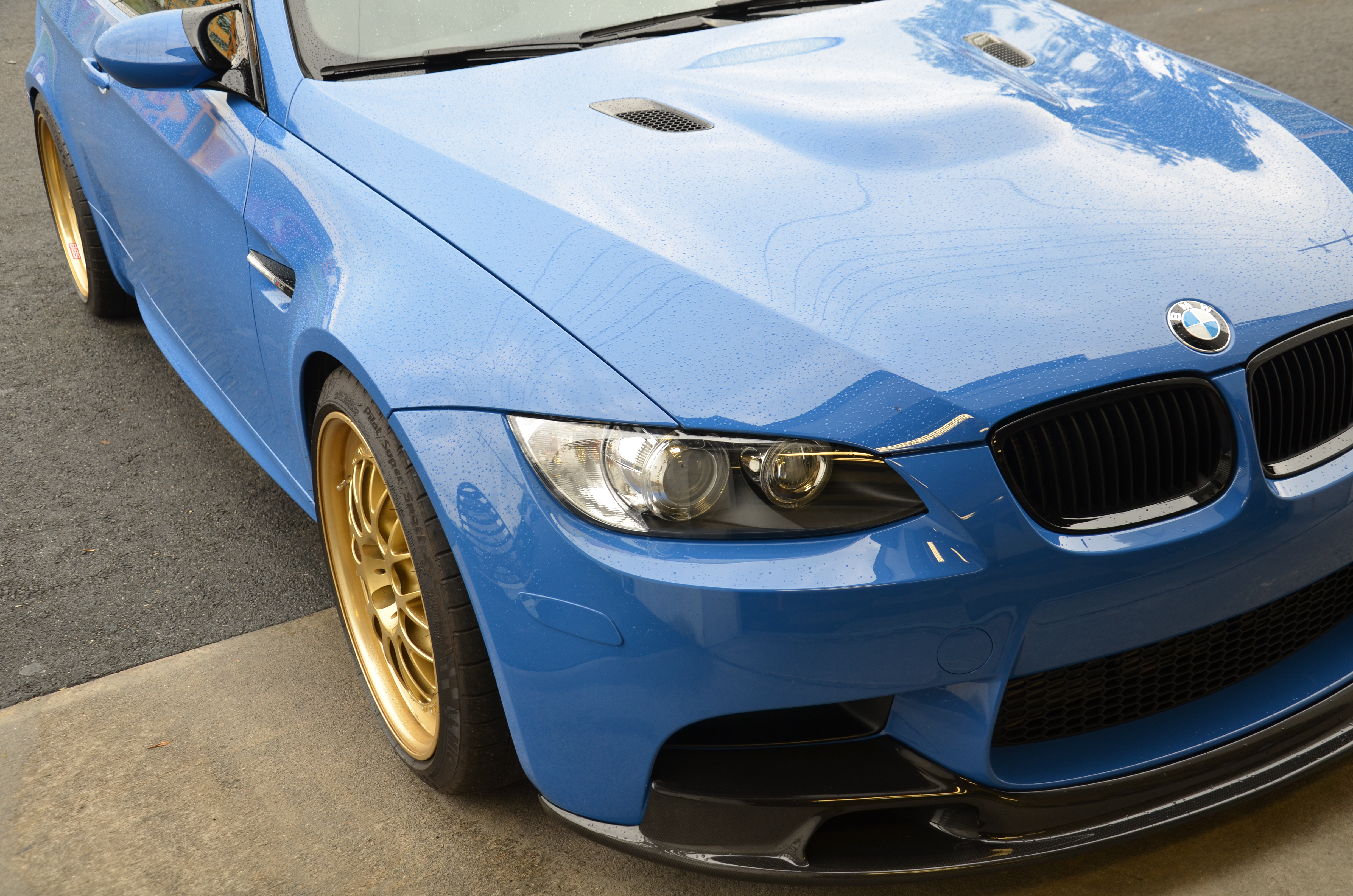

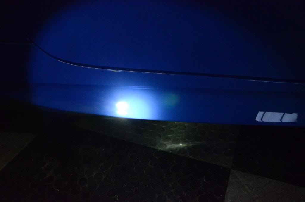

50/50 shot

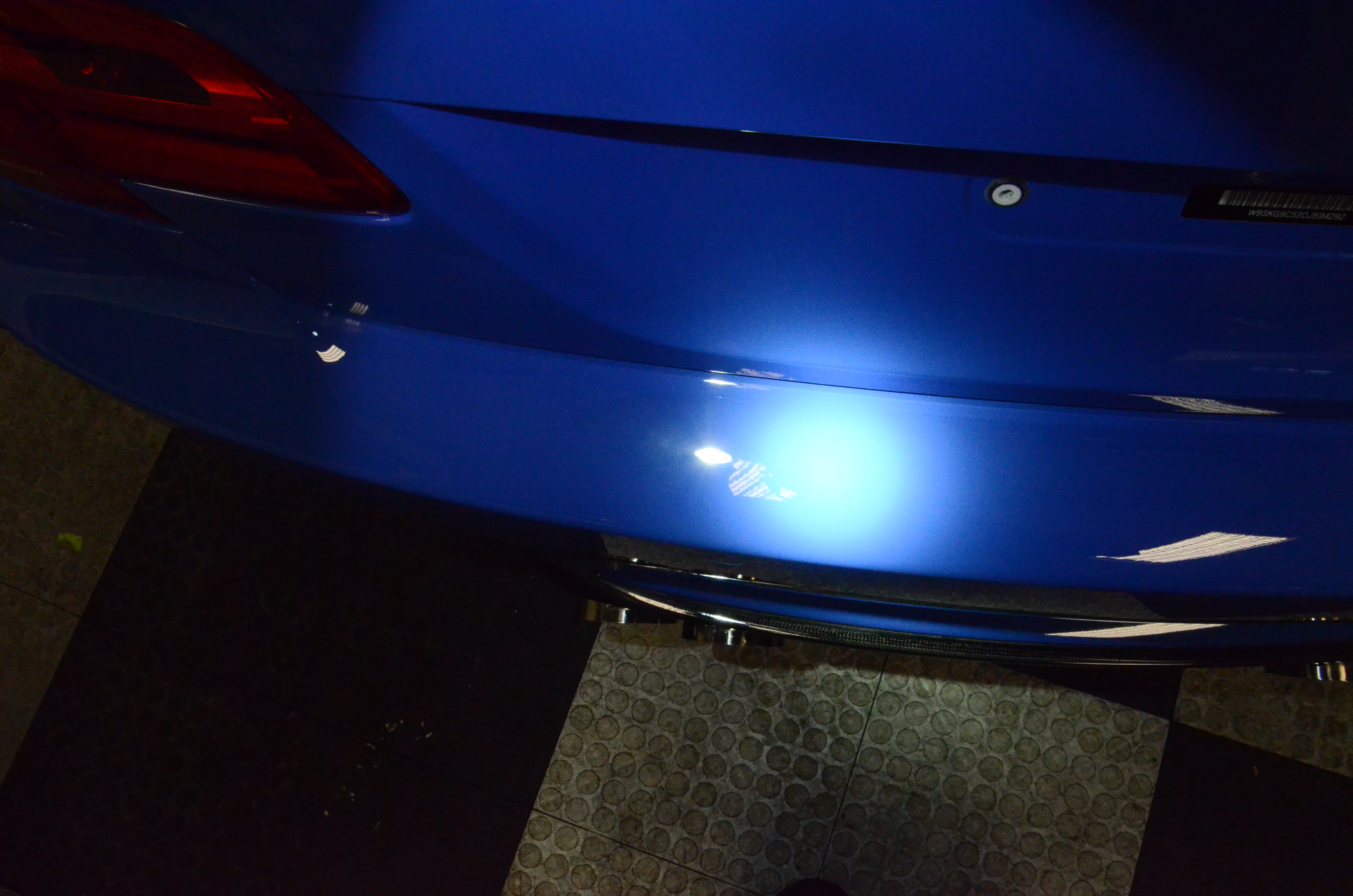

Before rear bumper

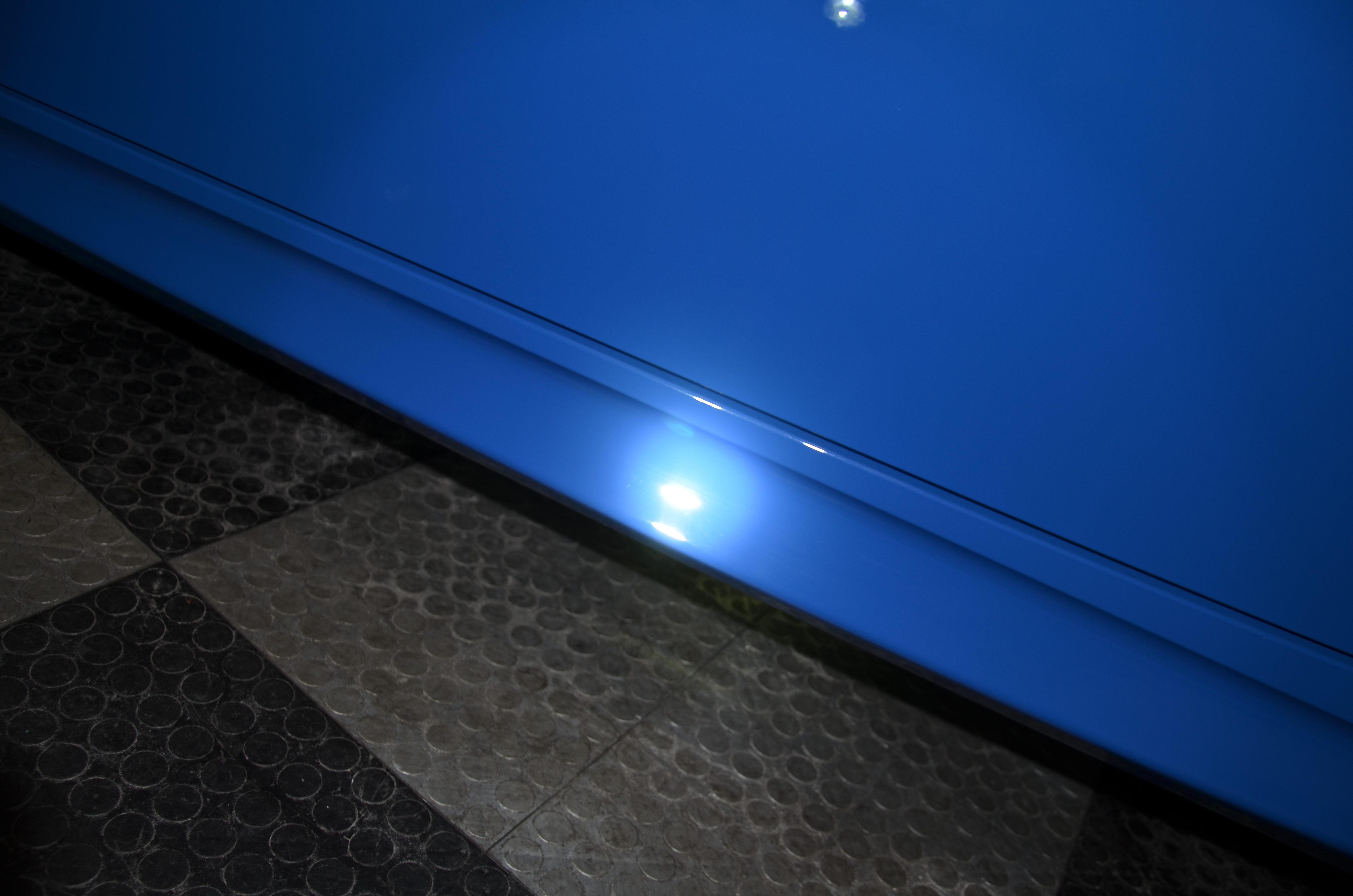

Before side skirt

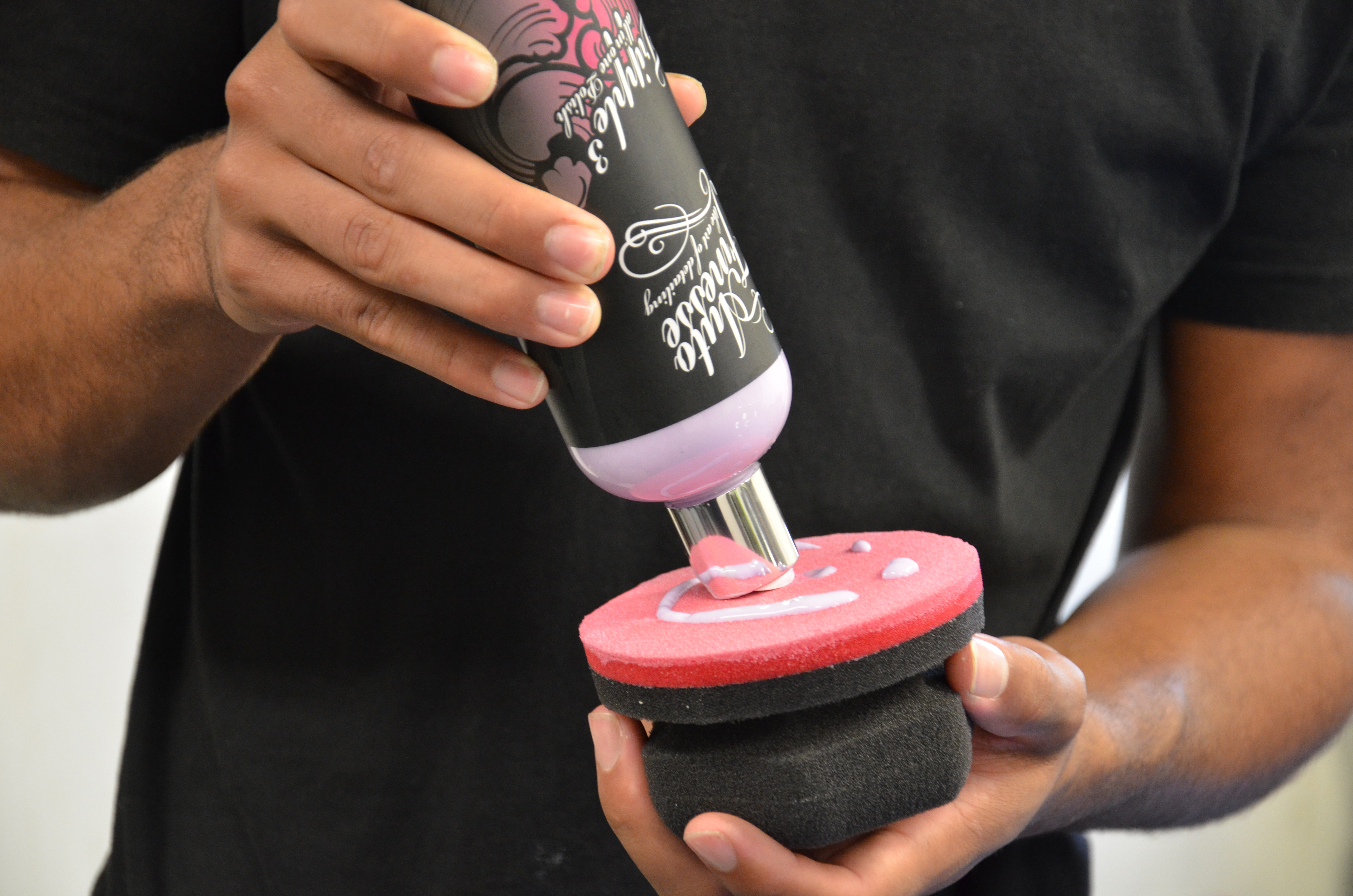

Auto Finesse Tripple followed by Auto Finesse Illusion for that show car shine
