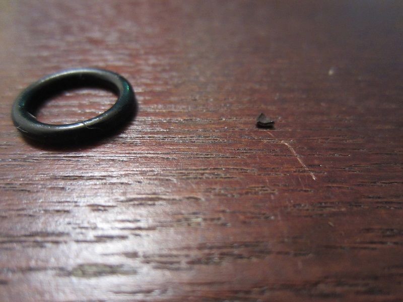

This guy came off as I was wiping down my drain plug - not sure what it is - i.e., bearing material, paint chip from the drain plug, whatever - just not totally sure. It's not magnetic, so I'm not sure if that rules out bearing material or not, if it is bearing material.
side question - has ANYONE ever had something come out of their oil when doing a change, new or old?

I may just be being paranoid. Car has 650 miles on it now. Unfortunately, I don't have the rest of the oil to look, but there was nothing noticeable in it, and it was break in oil, so I didn't collect any to send to a UOA.... I should have.

For an overabundance of caution, you could drain a little oil, take a Blackstone sample, and put the contaminant it in the sample bottle. That's what we used to do on aircraft (I didn't see your lower caption(whoops!))

Are you sure it wasn't on your rag already?
Not an expert by any means but I'd think bearing material would react to a magnet. Plastic could be a guide (timing chain). Alloy would point me to a cast part.
A trip to the dealer to let them have a look could give you some answers....or not.

yeah it wasn't a rag, just a new paper towel. but yea it wasn't magnetic and it didn't stick to the drain plug, just came off the side or something as I was wiping it down. I'm not overly worried. I did a moderate break in, with some WOT to 4k to let the rings seat, only when the car's fully warmed up, etc., let it warm up properly, so I can't imagine that actual damage could have been done. Just strange. I'll def do a UOA when the next change comes

Well i can tell you its not part of your timing chain guides because the guides are white new and can be kinda red. Its possible that its a piece of gasket material from the valve cover or oil pan......it could also be a tab from the oil pump cover. My suggestion would be to bring the piece to your dealer and tell them it was in the oil. ask them to drain the oil and have a look at the bottom end through the oil plug hole and top from the filler cap. I guarantee you they wont actually look but if you have catastrophic failure down the road its good to have a record that you brought it to the dealers attention .

someone else on bitog speculated this:
New engine assembly trash. Pretty typical, and I wouldn't worry about it. But stuff like this is why leaving factory-fill oil in for a full OCI makes my teeth itch. No new engine is perfectly clean, there are just too many places for assembly trash to hide.

There's a dcs bulletin about this. its an internal piece of the oil filter housing. Atleast the o ring is, never seen a piece of aluminum.

sorry the oring is just there for some size reference, it's not from the oil
