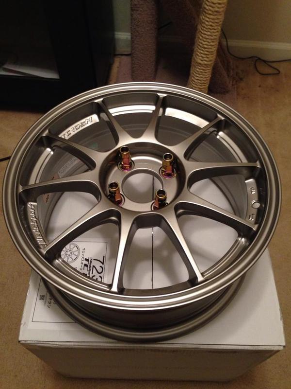

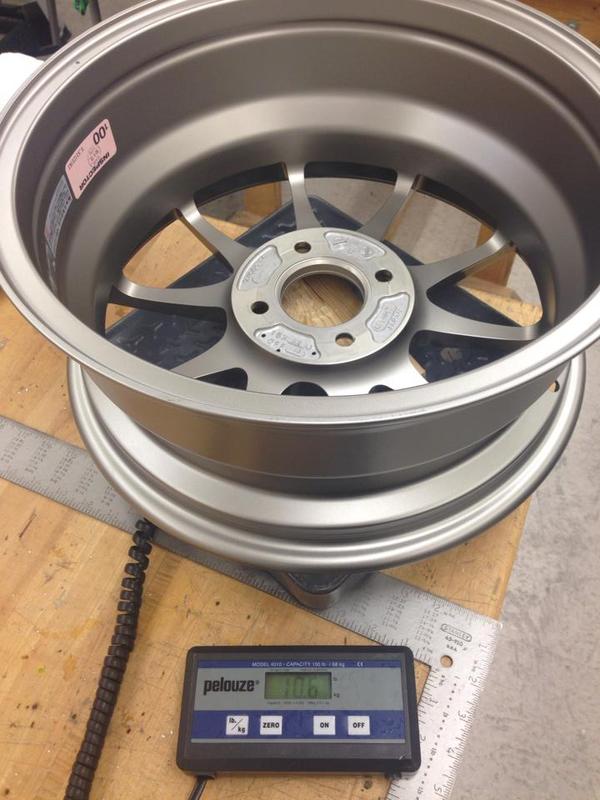

Not as light as the Volks, but also 1/2 the price.
Attached Thumbnails So, 15x6.5?-1622796_10100787336109165_1332120198_n.jpg   So, 15x6.5?-1609881_10100788909610855_132875742_n.jpg

That looks pretty good. What are they, and where did you get them?

+1, what are these? i'm still not 100% on my wheel/tire set up, this looks decent...
nvm - they're wedsport tc's - on the wheel, just hard to see
http://rhys-millen-racing.myshopify....ssport-tc-105n
