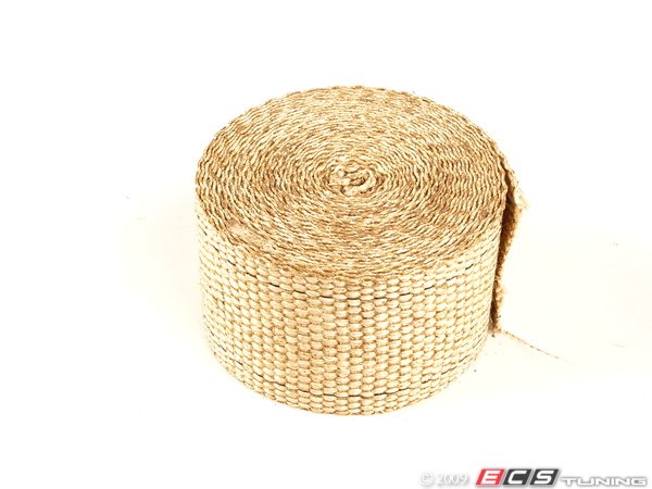

We carry the DEi Exhaust wrap. 2" and 50 ft should work fine. Some guys prefer the wider stuff to cover more length wise per wrap. The Tan or black should work good , just depends on the color. The titanium is just for a little higher heat.
