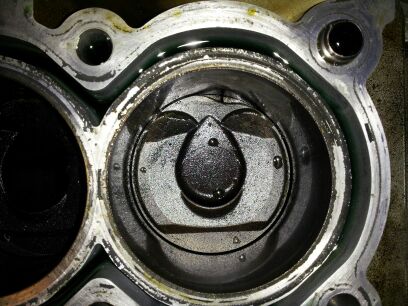

Update:
The most recent issue was caused by a piston failure. Somehow the piston in cylinder 4 developed a monstrous hole in it along the edge. Check it out:
I'm not sure exactly how this occurs, I've been very diligent about all the maintenance since I've owned the car. If anyone has a similar failure or has insight as to how this happens I'd love to know.
Fortunately Mini NA held up their end of the deal and replaced the entire engine under warranty. The car is back on the road and almost out of the break in period on the new motor.

I voiced concerns about where the missing chunk of valve went. The tech said that it "just burn up"
It is not a common problem but a known problem.
The exhaust valve in your engine has overheated and lost a chunk of metal, causing the cylinder to lose compression.
Anything that interferes with valve cooling or creates extra heat in the valve or head can lead to premature valve failure. A buildup of deposits on the valve face and seat can have an insulating effect that slows cooling and makes the valve run hot. So too can poor contact between the valve and seat if the seat is too narrow, nonconcentric or off-square. If deposits build up in one spot or flake off in another, it can allow leaks that create hot spots on the valve as seen in your picture.
So IMO there are other issues that caused this to happen.

Did your engine run hot? Because cooling problems in the engine itself can lead to valve sticking and burning if the operating temperature gets too high. Low coolant, a defective thermostat, a weak water pump, a radiator obstruction, a defective cooling fan or fan switch, etc. can all make an engine run hot. This, in turn, makes the valve stems swell which may cause them to gall or stick in their guides if there is not enough clearance. If the valve sticks open, it can burn or be destroyed if it smacks the piston.
Blockages caused by casting flash inside the head or a head gasket that does not have the correct coolant holes can allow hot spots to form that can cause valve and guide problems. So too can a buildup of scale inside the head the interferes with good heat transfer.
Valves can also run hot because of elevated combustion temperatures. Factors such as retarded ignition timing, lean fuel mixtures (often due to leaks), detonation (from too much compression or low octane fuel) or preignition (from hot spots caused by deposits in the combustion chamber or too hot a spark plug) can all play a role here.

Hot = Lean / Lean = Hot = burnt exhaust valves.
Money is on a lean condition... Due to carbon... HPFP failure/injector failure/carbon blockage.
That chunk missing from the piston is either also due to the lean condition or the chunk-o-valve breaking off the top of the position crown.
The tech should have seen the piston damage the 1st time they had the head off to fix the original valve issue.
If the piston damage happened later either it was a nick from the valve chunk - that grew due to the still-lean condition... Which points to the injector or carbon buildup on the intake valve..

That cylinder was running lean(fuel starved, maybe HPFP issue). No if, ands or buts about it. That piston head was melted and you can see as the indentations are smooth. The exhaust valve piece did not cause the damage to that piston. It sounds like that cyl was slowly melting from leaner AFR's thus dwindling the compression ring(top most ring) and crown, the exhaust valve can't take hot hot hot heat for very long so it chipped. they fix the valve but guess what, you still have low compression in that cyl so you're not gunna have all the power. The exhaust valve piece probably got injested through the system and blown out very quickly, doesn't typically cause a lot of damage on the way out.
what sucks is, in order to replace the valve the cyl head needs to come off, the fact that they didn't see that piston the way it was or correlate the two is mind boggling. this should be basic engine operation diagnosis to a mechanic.
I blew a 1" long piece of crown in my turbo subaru once, it destroyed the spark plug and got taken through the system, thankfully the turbine was fine. I leaned out in that cyl, needless to say i dropped forged pistons in and beat the **** out of it some more. I've seen, in person, a lot of turbo engine failures and yours is certainly not uncommon for an issue with fuel delivery. leaning out air fuel ratios will cause way too much heat for an engine to handle. it's only a matter of time till something goes, whether it's the piston compression ring or the exh valves. prolonged exh valve high heat exposure will certainly burn them(chip).
