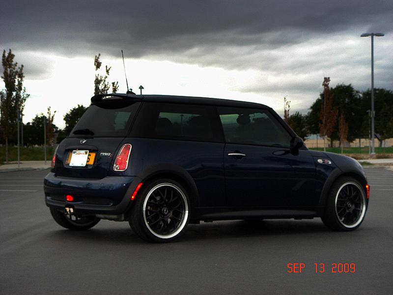

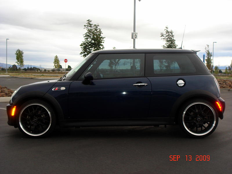

Yup did them myself..........went from silver to gold to black...

How is that lasting?
and what kind of paint did you use?

I used duplicolor wheel paint. A couple cans of black primer and couple cans of black wheel paint. About $25 for all for.

It all depends on how you prep. The duplicolor paint is made for wheels. You can even add a clear coat for more protection. Painting your Wheels

rossii... well done.. i might try it

rossii are those asa ar1 rims?

Yup they are 18's......
