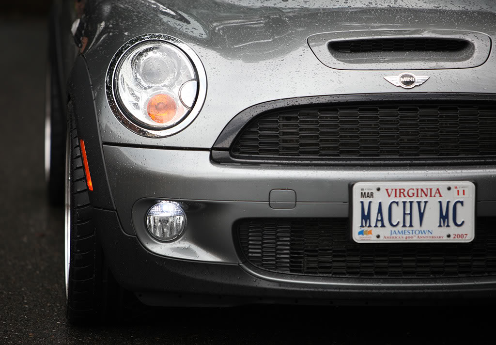

The R56 has larger plastic over-fender pieces than the R53, and seems to have a bit more tire room as a result. We've previously fitted 235/40R17 on 17x7.5 +45 wheels with no interference...

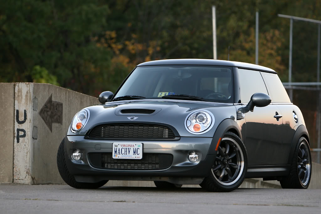

We also put 225/35R18 on 18x8 +45 wheels:

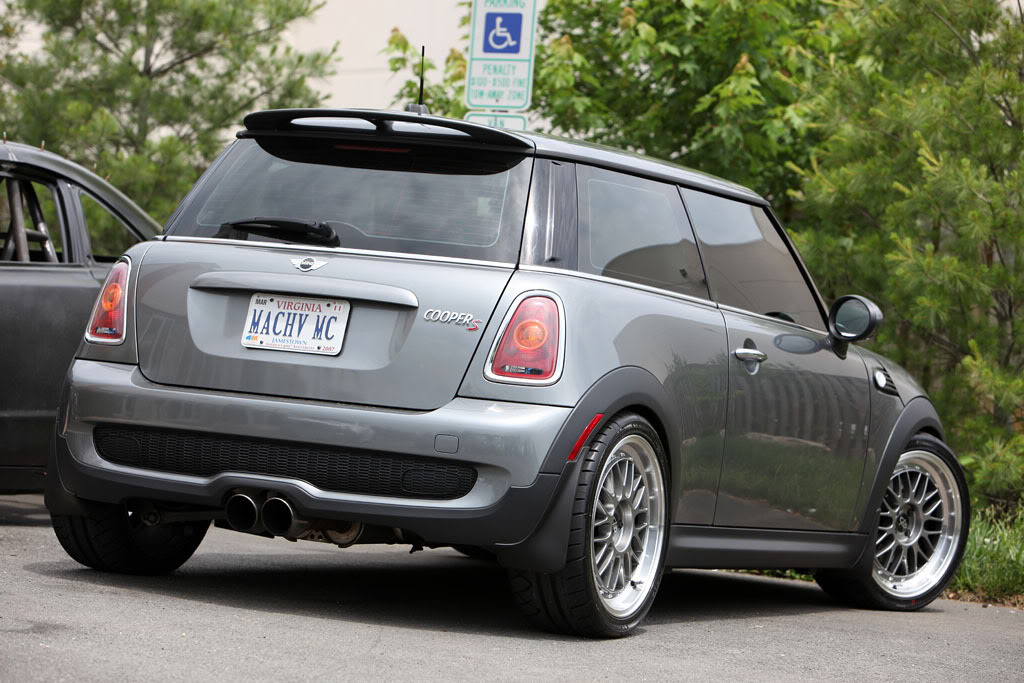

Those were all-seasons, and it was time to fit some summer tires. I had noticed some downsides to the 225/35R18s. They have very little sidewall -- 225 * .35 = 79mm = 3.1" of sidewall. Plus the 8" wheels were substantially larger than the tire, meaning the edge of the rims were taking a beating from road grit and pebbles, not to mention a curb.
Since the 235/40R17 fits fine, I knew the 235/35R18 would fit fine. But there are only about three offerings in that size, and the cheapest is almost $200 a tire. On the other hand, there was a 245/35R18 in the new Kumho XS, and it was about $30 less per tire. I had wanted to give the Kumho a try anyway -- it's their newest high-performance summer compound. I figured if they didn't work out I could sell the set to one of my Subaru customers.
So we ordered them and mounted them up.
The good news:
- They have a slightly taller sidewall, at 3.4", so potholes are a little less of a problem.
- They protect the wheel lip much better.
- The grip is ridiculous.
- People love the way the car looks. Strangers stop me and compliment me on it.
