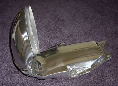

http://www.motoringunderground.com/f...t=12570&page=2

I'd have to agree. I have a bunch of buddies who run fully polished engines in their Vdubs with massive HP turbo engines without any problems. The difference is probably minimal at best.
I say polish them, it would look killer

Yeah ok, theoretically the wrong thing to do, but damn it sure does look awesome. And it does look faster, so that has got to be worth something.
Killer indeed

yes I would really like to get them polished....
I'm not running an 11 second quarter mile... so i think FOR ME, i would rather it look nice. and be maybe the slightest bit warmer.
looks awesome!

Polished it?
Hey so how did you polish this, I see the grinder you removed the texture with, but what did you use to get that final polished look?? I am looking to polish a set of wheels myself.

For a little bling , use a tooth brush and simichrome polish on the cast, scrub and scrub, then burnish with a clean cloth, it will give a nice polished cast look.

this isnt my work, I wish it was. It belongs to Nitromini on Motoringunderground, This might help
http://www.motoringalliance.com/foru...d-madness.html

Thanks gonna try this
Oh my bad, ok thanks for info.

We've been powdercoating them for customers. But I have to say that looks good. Alot of work to do that so hats off to you.

I bet the polished cast look does look cool. It would kind of look like an uber OEM dress-up upgrade.
