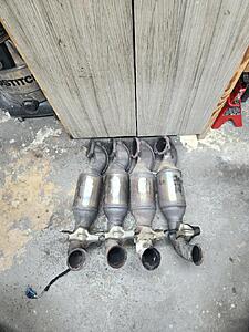

like in any other forum , you do you , do what you think its best for your vehicle , i'm telling you what ive found , i have 2 warehouses full of minis and parts , i also do recycling , and have built many performance cars ,
the 07 to 10 cars have a very restrictive donwpipe and every single one ive cut open its clogged or melted inside and that causes extreme heat , once you remove it , the car runs totally different , it also has a second cat right under your shifter , no need for so much restriction on a 1.6 liter ,
no need to get fancy and break the piggy bank , i buy the catless downpipes from CNT racing $150 , its an R56 doesn't need anything better than that , i use a new OEM gasket , the ones they supply are garbage
on the 11 + cars with the N18 the factory downpipes are less restrictive and those dont get melted inside or clogged or at least i haven't seen one , if you have to run a catted downpipe because you have emissions in your state i would switch to the N18 one , which is plug and play

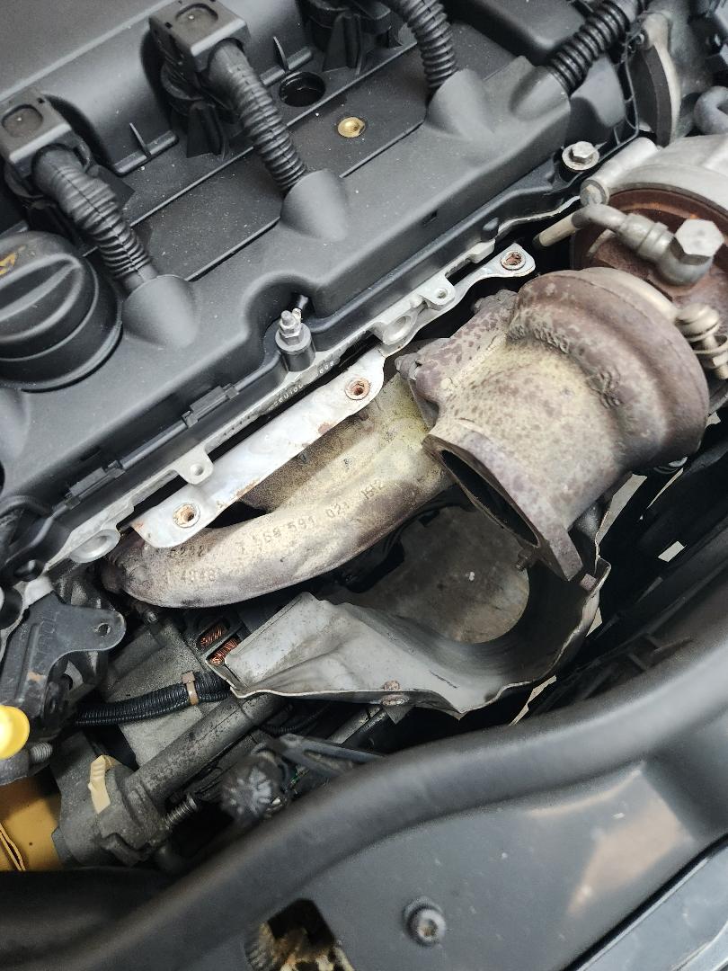

wanted to show you some thing , this car i just did this morning , you see all that white yellowish on the manifold thats extreme heat , this car was started for a few seconds just to drive it inside the shop , 30 minutes later it was still to hot that you couldn't touch the manifold and will burn you trying to remove the down pipe
