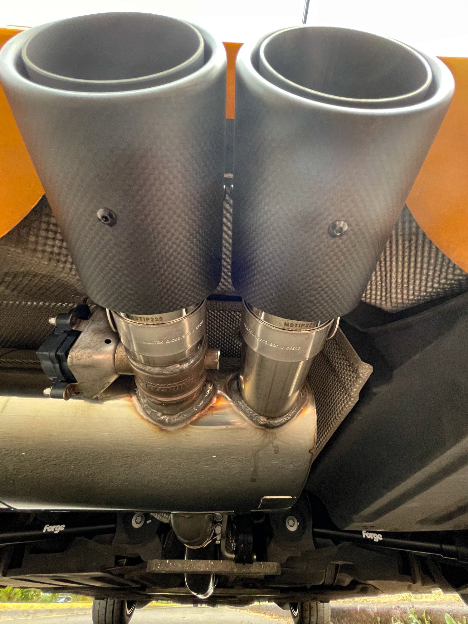

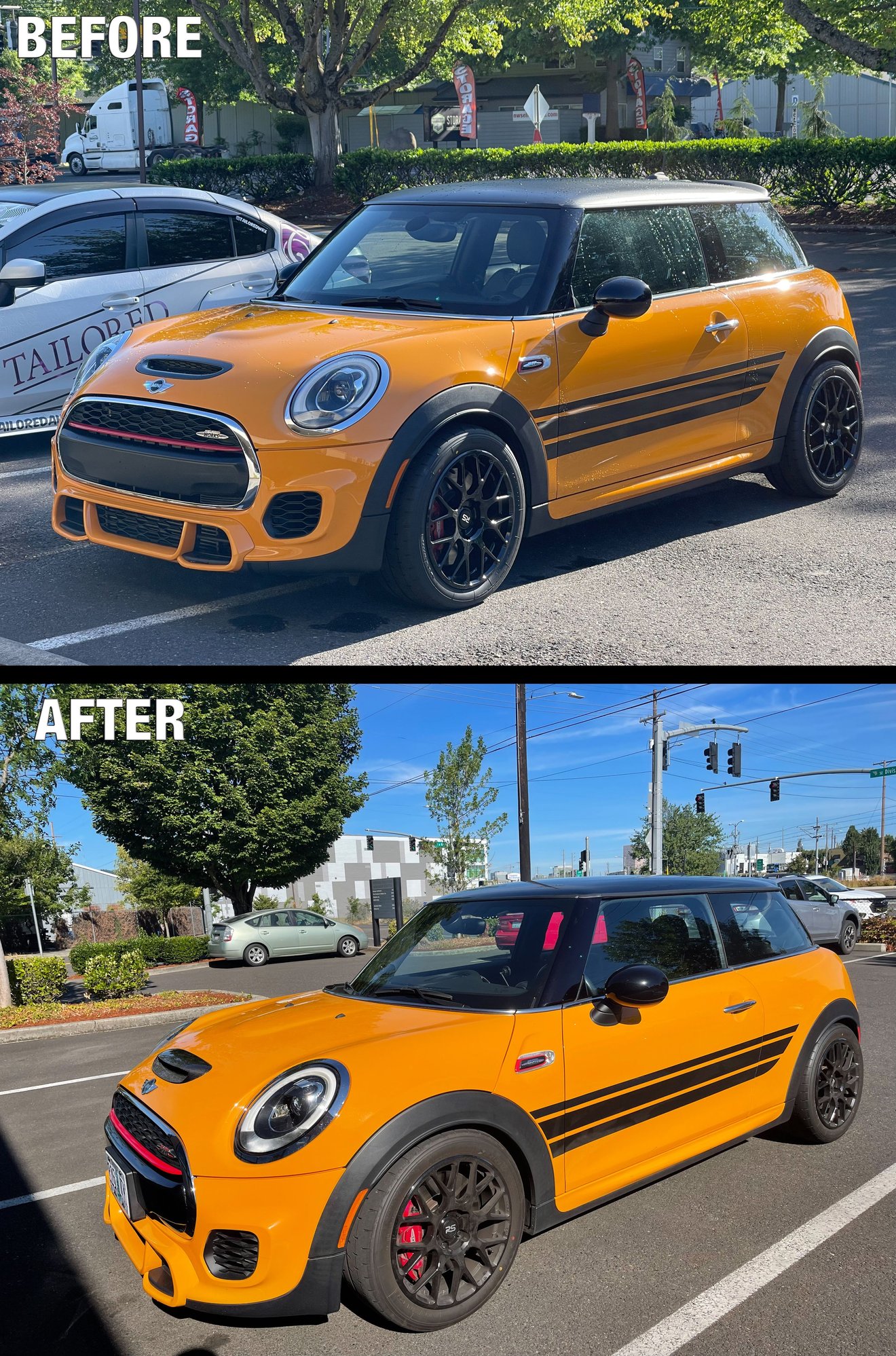

OK, the project is finally done. In the end I upgraded nearly everything on the car... Wheels, Tires, ECU Flash, Downpipe, Clutch, Diff, Intercooler, Intake, Brakes, Shifter, Bushings, Suspension, Camber Plates, Tie Bars, Exhaust, and even the Instrument Panel and Headunit. I also wrapped the roof in a carbon fiber PPF.
Here are some pics. The Milltek Valved Exhaust sounds *fantastic*.

As far as the suspension goes I installed a JCW Pro Suspension kit, based on the KW v1. I dropped the car by 15mm in front and 11mm in back, and shot for -2.1° of camber at all wheels. Thanks to @cmt52663 and @Eddie07S for the guidance. Here’s the alignment report and a sample of what the car looked like before and after:

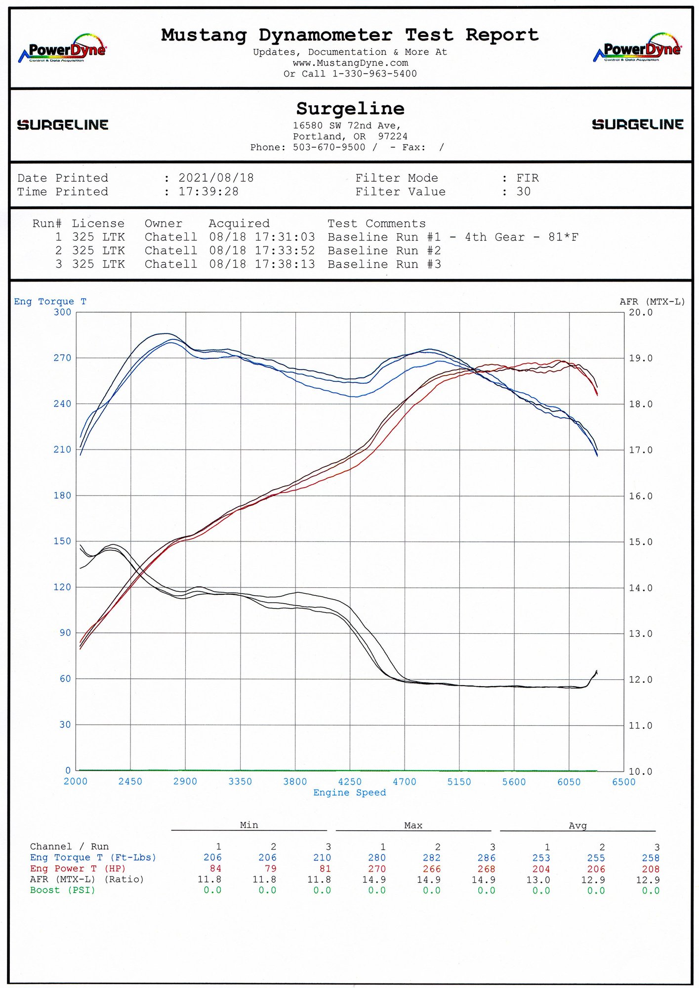

I put the car on a Mustang Dyno the other day and she’s putting out 270whp. My best guess is that’s around 310bhp or an 80hp gain above stock. I’m pretty happy with that for not having touched the motor (yet… hmmm). Here’s the report:

ECU FLASH / DOWNPIPE / EXHAUST: The State 2 RPM tune provided by @MarioKart produced a huge change in the feel of the car. It went from being quick and refined to raw and ferocious. It’s definitely a bit of a handful to drive and I love it. It torque steers like my R56 JCW used to, or even a bit more, but I’m the type of guy who can appreciate a bit of “active driving”. I wish I had gone for the Cold Start option on the tune, it’s conspicuously loud when I fire it up at home, and it makes me a bit self-conscious with the neighbors. I used Bimmer Code to set the car to be in Sport Mode all the time, because, why not? I would even put the car in Sport Mode to move it out of the driveway. The Milltek Valved Exhaust is probably the most fun single component of the whole install. I didn’t think I wanted a loud car generally, but with the valves closed it’s very controlled, and muffles all pops and burbles really really well, especially when driving through my neighborhood. When the valves are open the car becomes over-the-top aggro and the pops and burbles are glorious.
