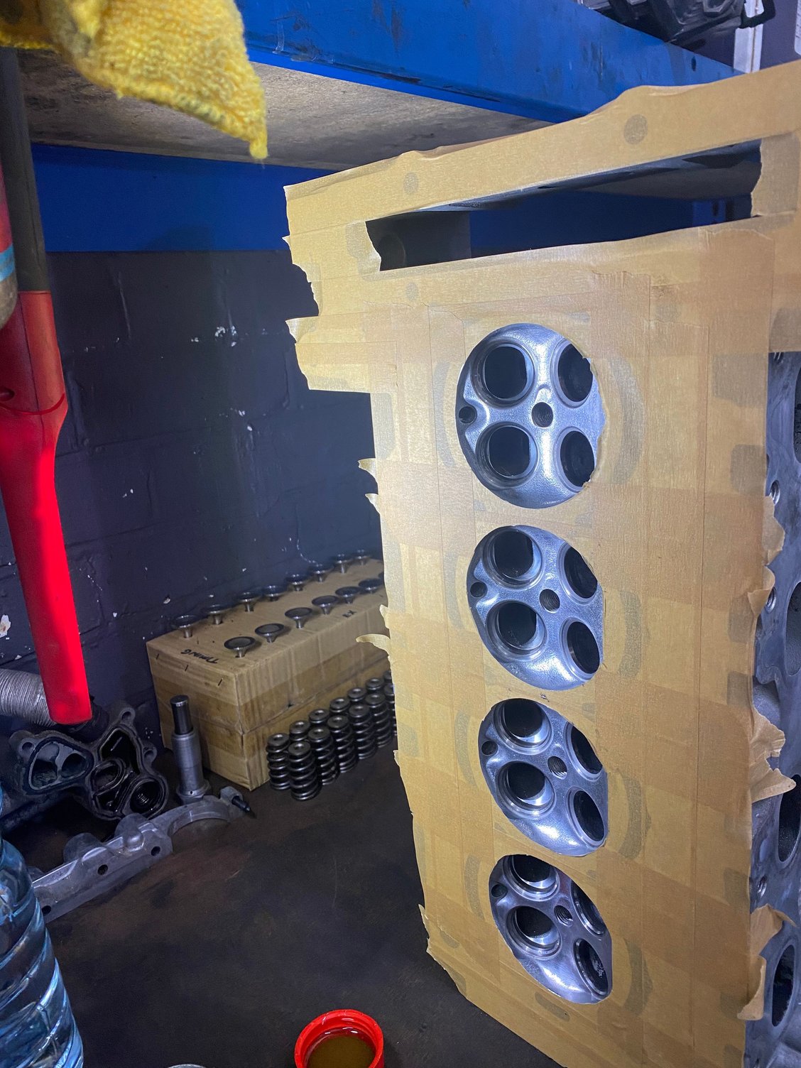

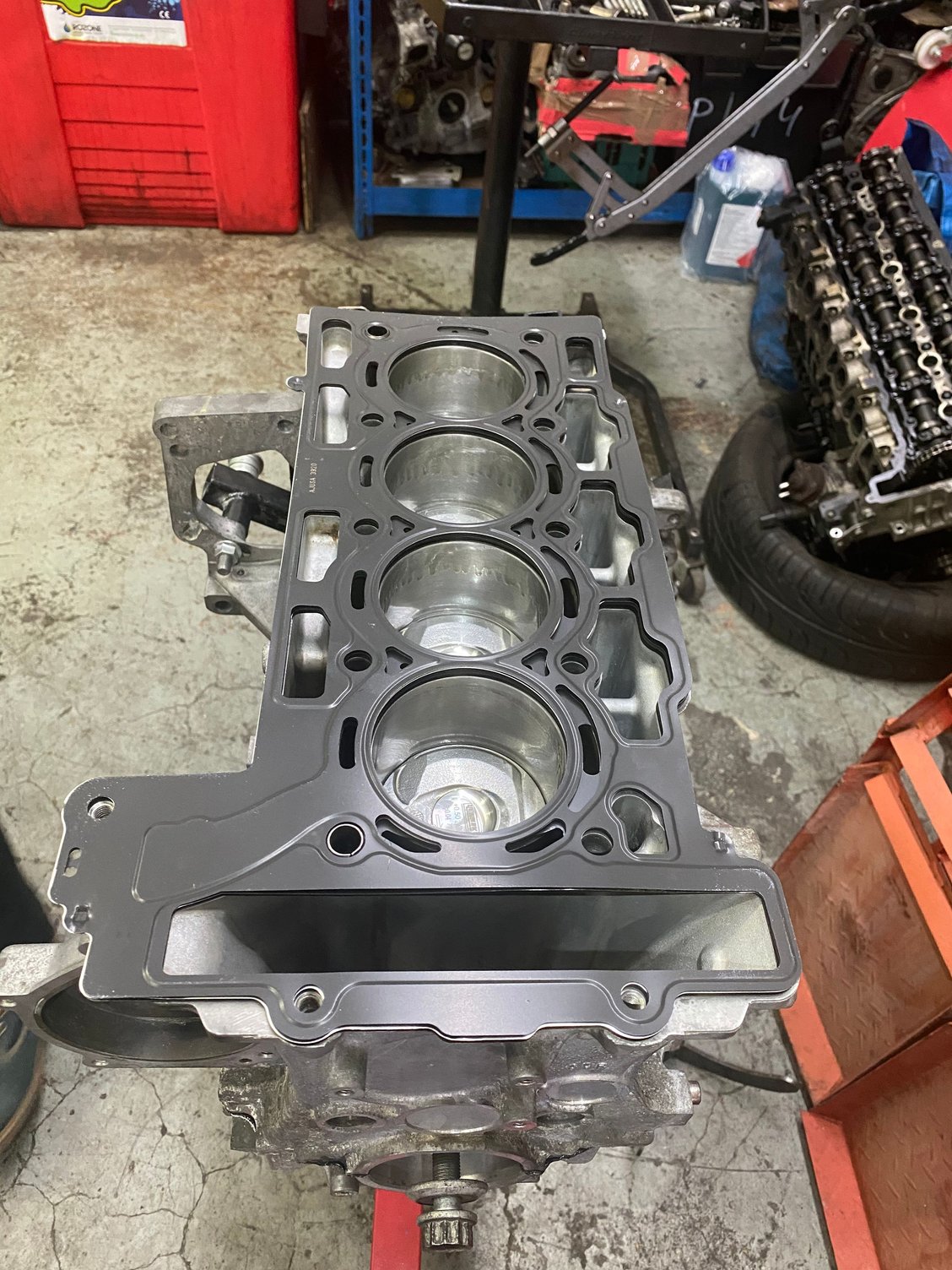

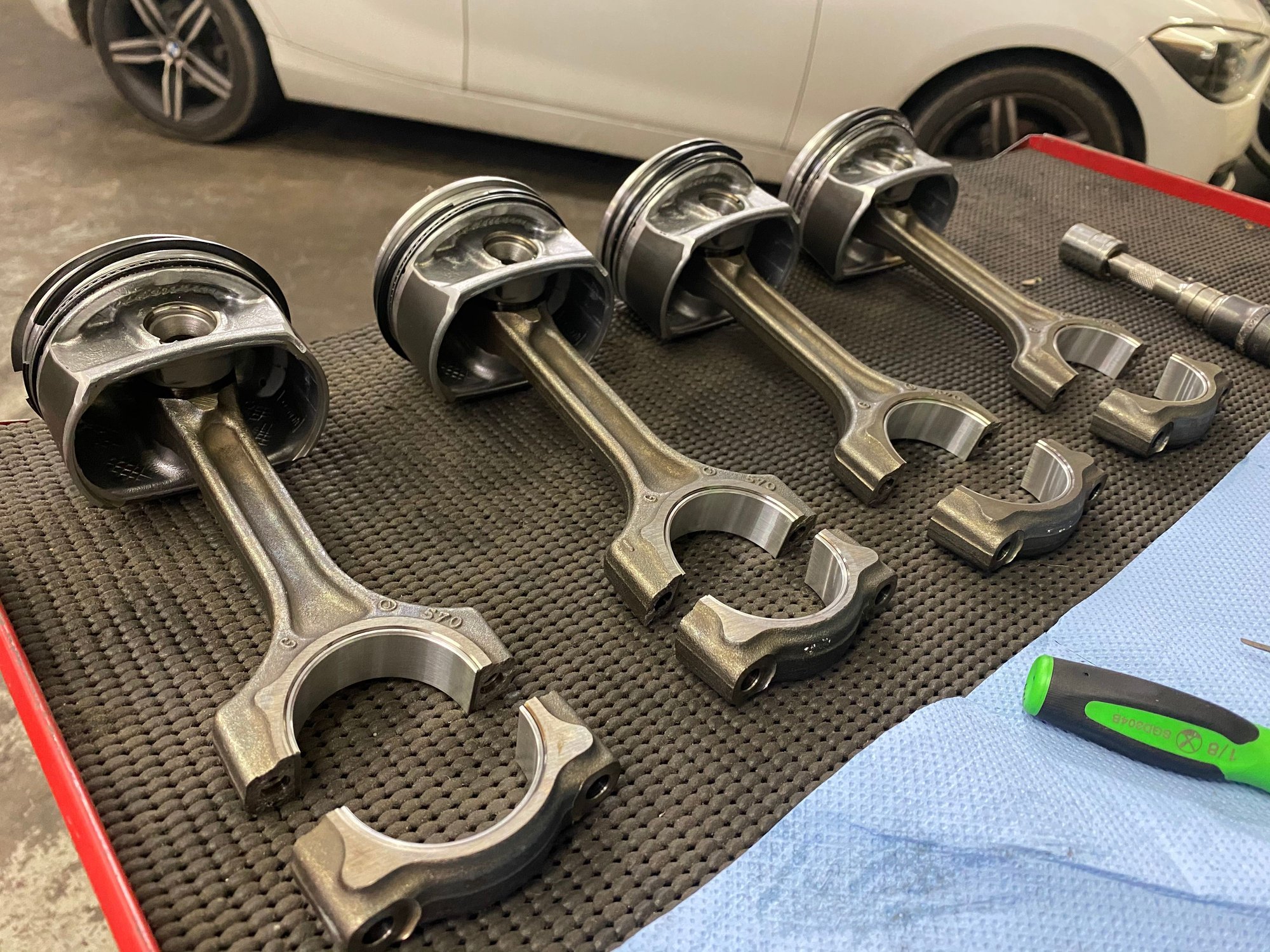

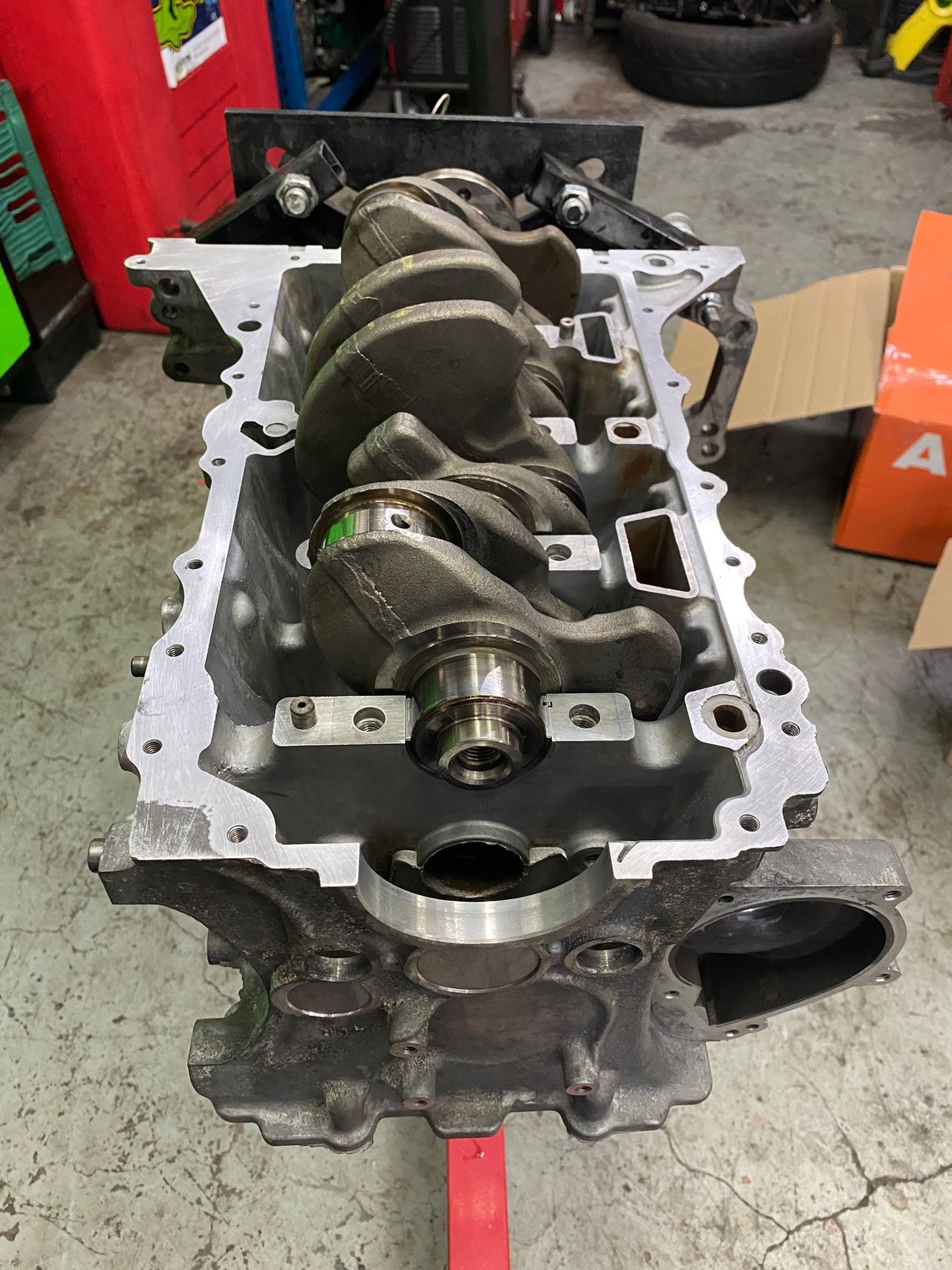

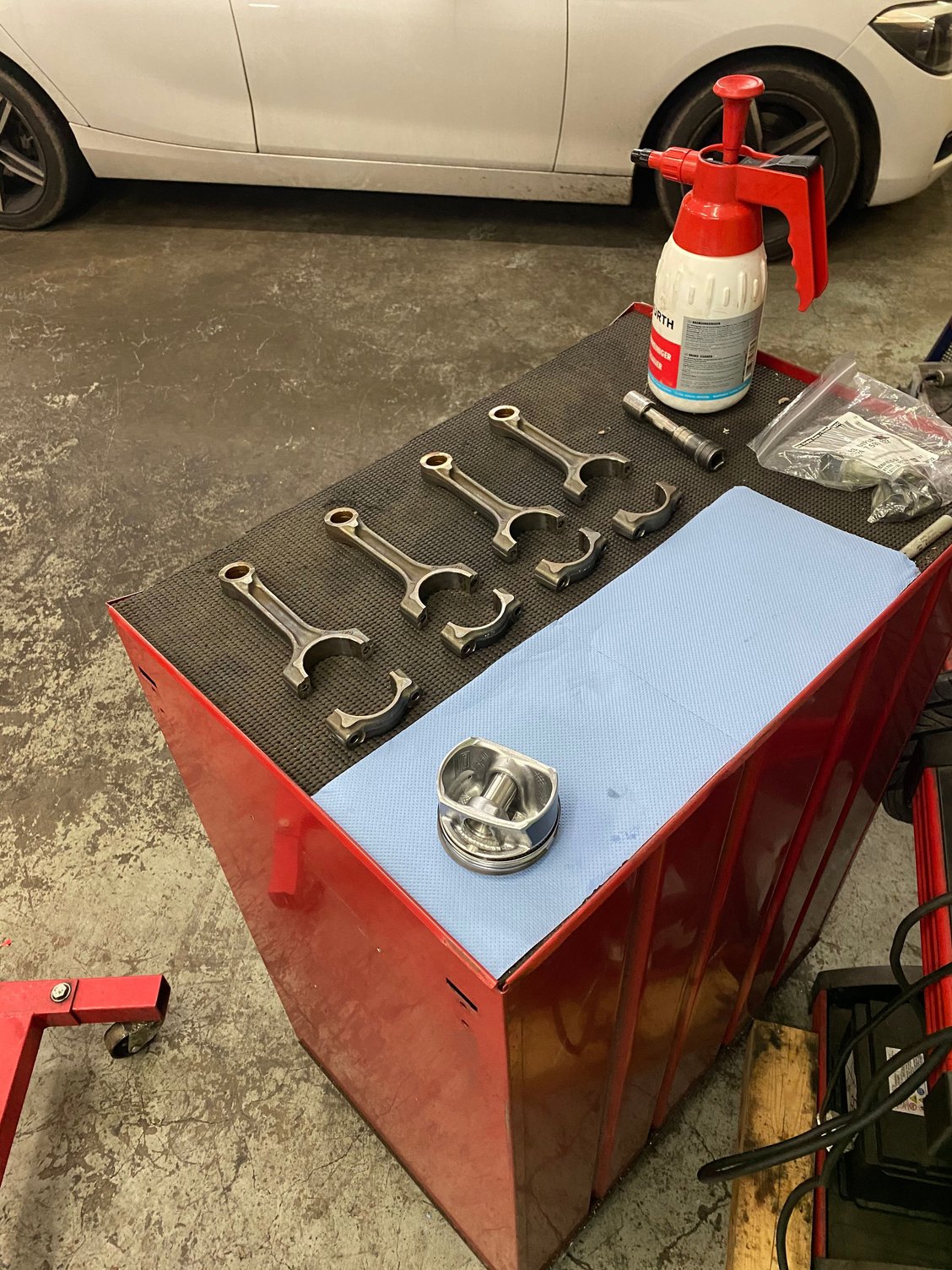

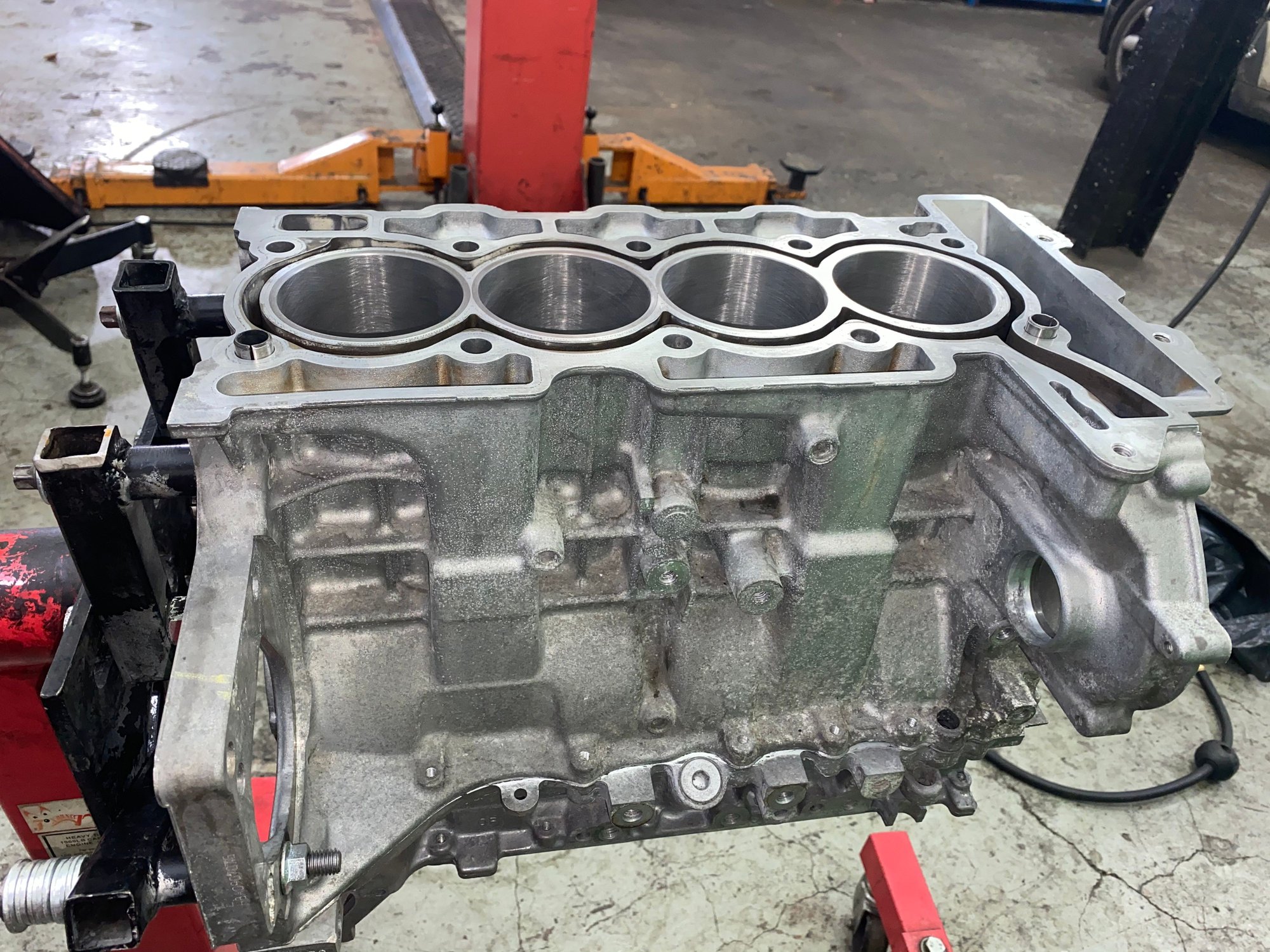

Hi guys,

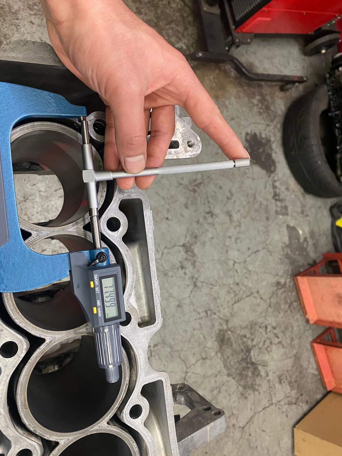

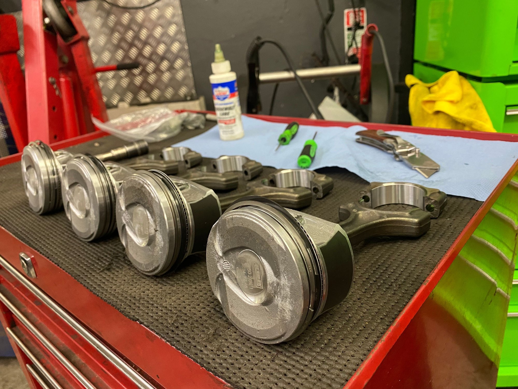

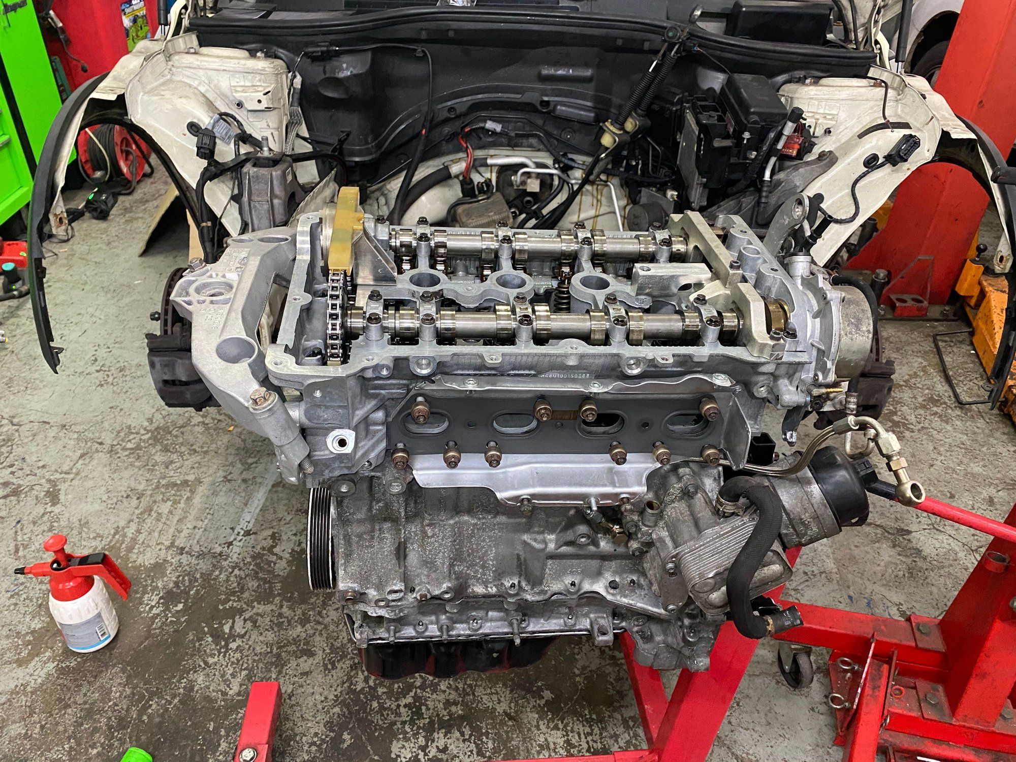

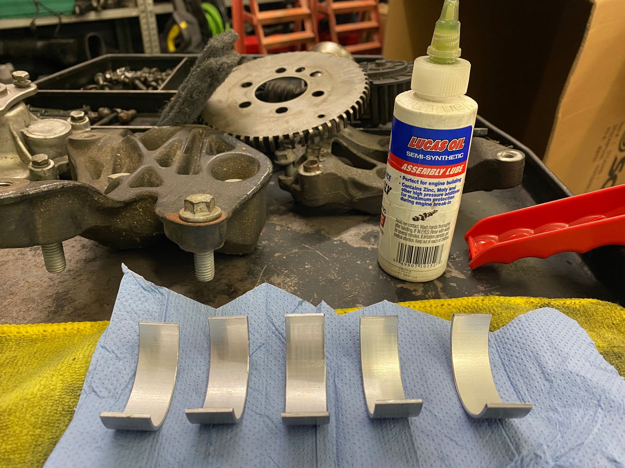

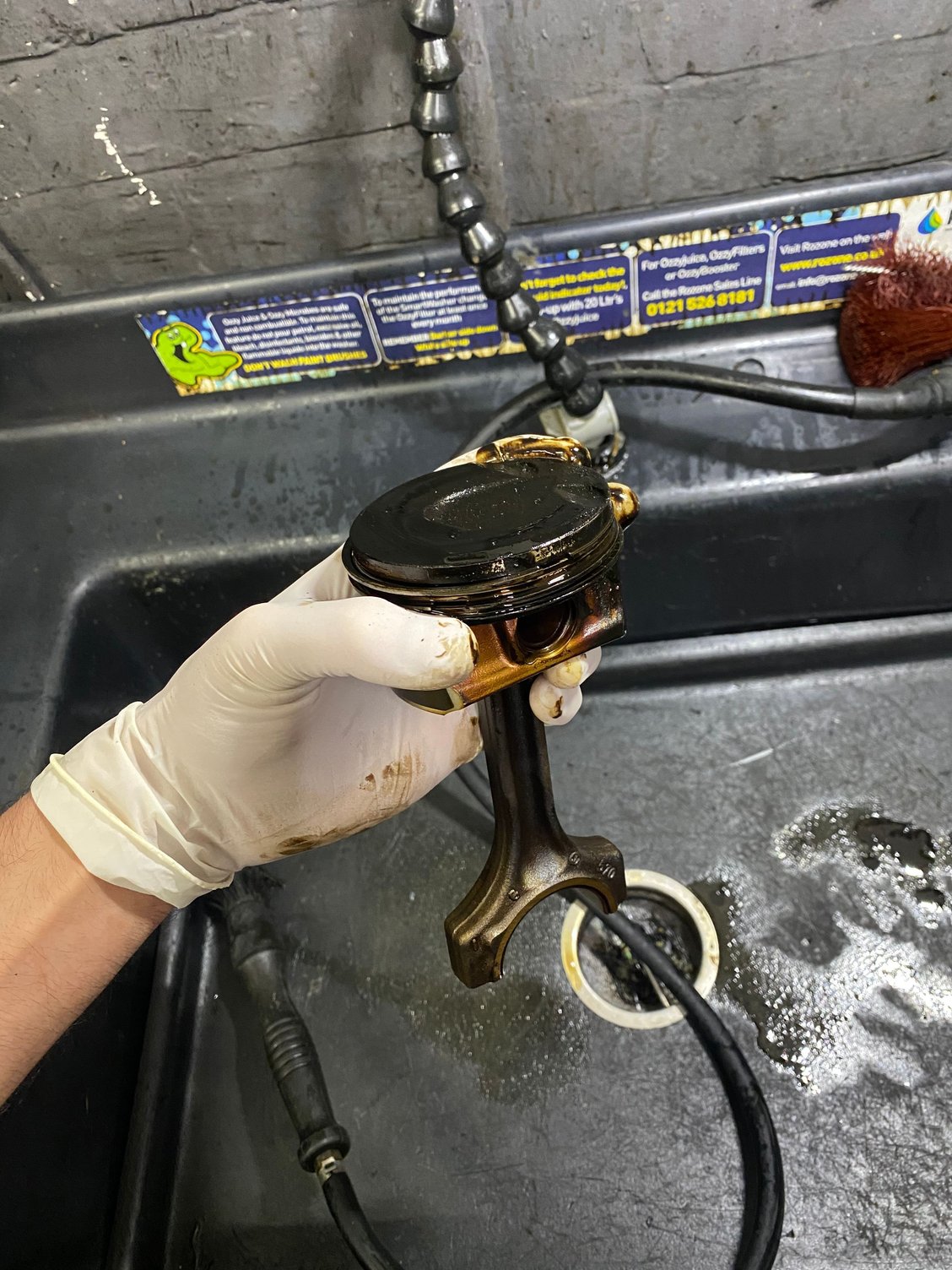

As the title states, I’ve got an issue here on a 2007 MCS, tried absolutely everything, replaced almost every single part, new JCW turbo following a recent full engine build undertaken by myself. I’m yet to install the JCW map sensors as the car hasn’t had its remap yet and once installed simply throw an EML for the sensors plausibility, but I’ve read on other forums that the JCW turbo should run fine on the stock MCS ECU file with stock sensors?? (Until remapped ofc)
Keep getting 2884 thrown but only at continuous boost at WOT which puts it into limp mode (power returns a after ignition is cycled). I can floor it from standstill and I’ll have full power and won’t trigger the EML for 2884. Done all of the usual checks for the wastegate even though it’s brand new. I’ve replaced the pressure converter, all vacuum hoses, smoke tested the whole system. Has a new airtec intercooler and forge charge pipes. New ilkr8e6 plugs correctly gapped with new NGK ignition coils. Almost everything has been replaced. I’m getting getting rather fed up with it now and don’t want to keep throwing money at it!
Could my fault be due to the JCW map sensors not yet being installed/car not being remapped yet?
Any help/advice would be greatly appreciated!!
Regards,
Zak
