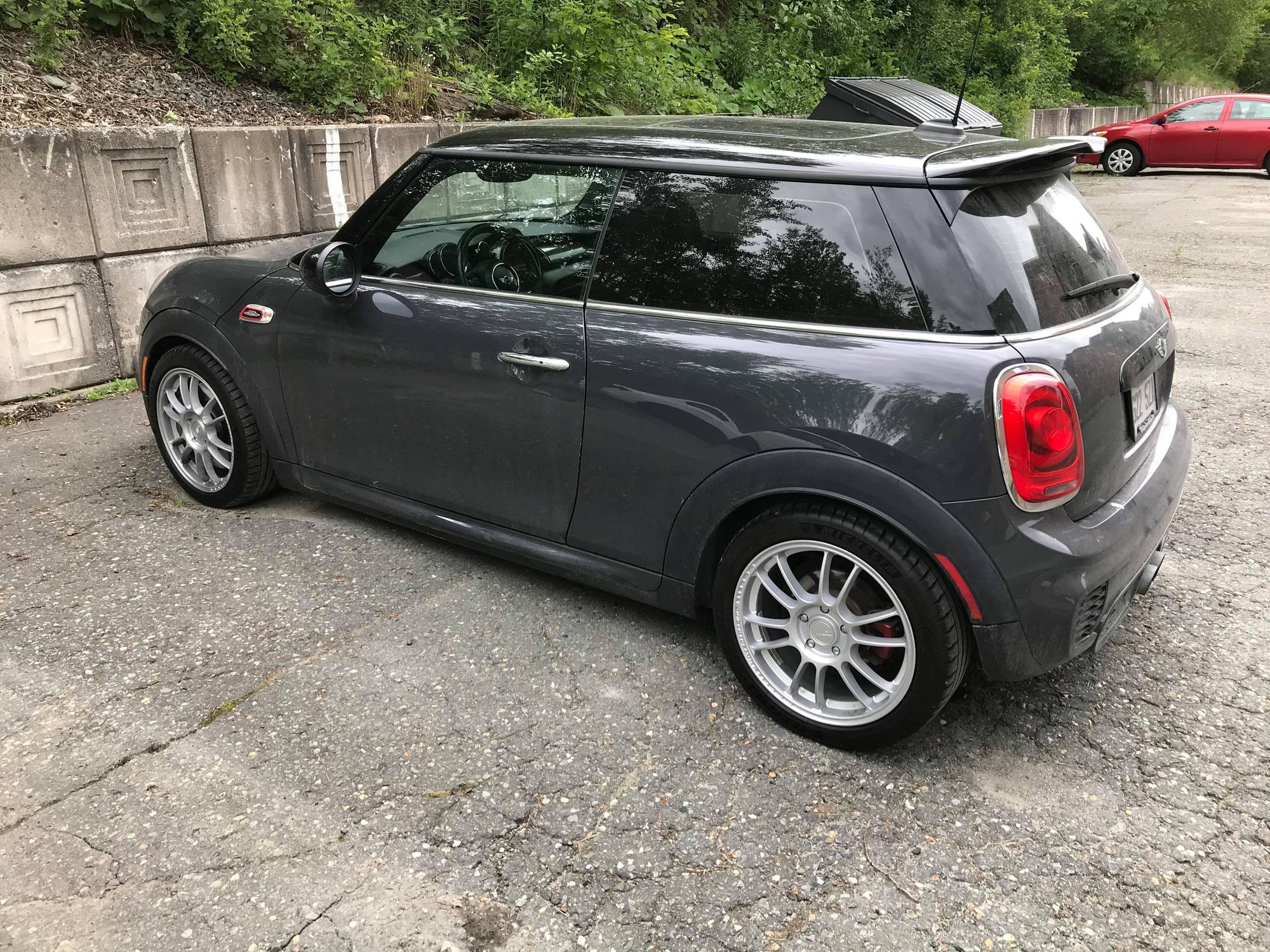

Finally installed some new wheels (Motegi - MR146 SS6 - Hyper Silver) 17" at 160$ CND each versus the ones I initially wanted (einki RPF1 at 360$ CND per wheel ) I dont regret my choice tbh ...even though the website said they would fit ..they do not lol..needed 5mm spacers (without collar) in front..which gives me 1 -2 mm clearance from the brembos ...The mechanic said that 1 mm was enough...as the brembos are fixed and wont move (according to him). Plus put some michelin pilot sport 4 215/45/R17... I have to admit this changes the driving experience in a VERY good way...the tires grip like crazy..the steering wheel feels more connected to the road.....this brings me closer to a mini like experience.
My warranty runs out in november 2020... I wont be doing mods until then ...but I have to admit that the NM power module + good light wheels and tires do make a significant change for the F56 jcw ( without modding the suspension). After that, I'll see whether I go RSB plus springs (from NM) or maybe go all the way with the Eibach front + rear SB + springs...
ps: the car is a little dirty hehe...just wanted to show the wheels because 1) most of the info posted on this site is about kinda expensive/custom wheels...So I was glad to find cheap/decent wheels that would "fit" and 2) I wasnt sure what color to choose for the wheels, given the dark grey color of the car...didnt want to go with black wheels for summer time.. At the end, quite happy with the wheels (price, color, quality, effects on driving experience) and the fact that I didnt have to spend too much to achieve a decent look
Wheel specs:
SKU: MR14677057442
Dimensions: 17x7 / 5x112.00
Center Bore: 66.56
Offset: 42
Reply 0
