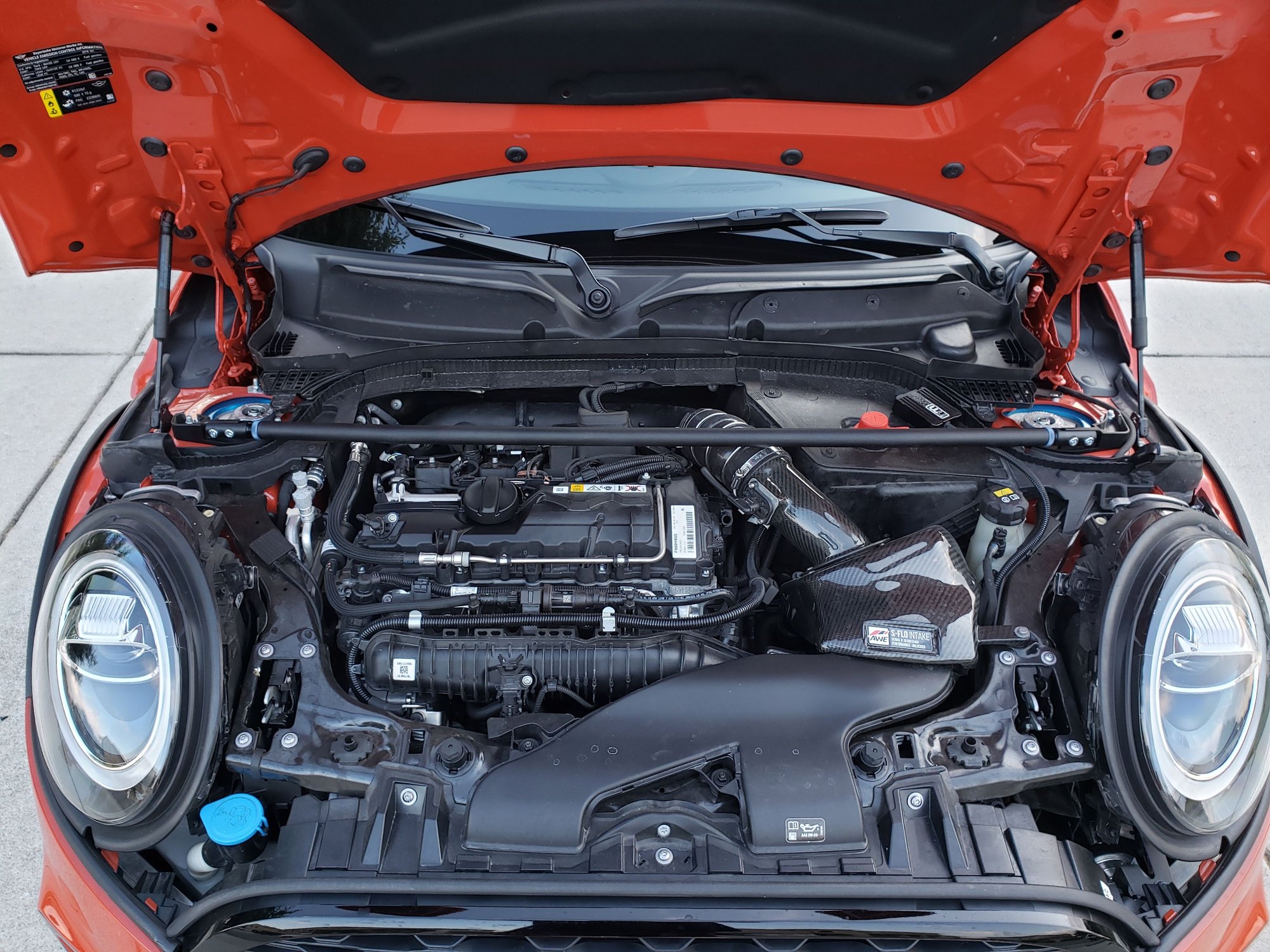

Mini Ready for AutoX this Sunday at COTA
245/45/17s on NM RSe05 17.7.5 Wheels...NM Exhaust...AWE S-Flo Intake and NM Power Module...Whole Engine Compartment where One Forge Hard Pipe can be seen...NM Black Front Strut Brace and K-Mac Camber/Caster Plates with Bilstein B14/16 PSS Adjustable Perches...Tires Clearance with 1.6 Front Degrees of Camber (1.7 degrees in rear).
