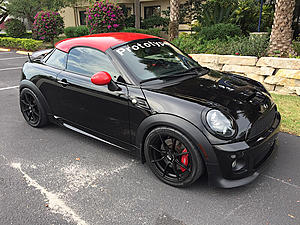

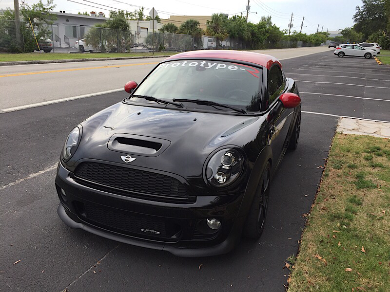

H&R's are 1.4" drop IIRC. I went with Swift springs 1.1" in the front and 1.0" rear. Wheels are 7.5" wide with a 42mm offset and 235/40's. No spacers and clearance is not a problem. I did add lower cambers arms in the rear though so I could take some of the excess negative camber out.

Looks awesome! Those are 235's? That is rad. I run 215/40on an 18 inch wheel. I have all the suspension in my signature that I am putting on Monday. I will see if I need Big spacers so I can run flash. There are some 5 mm spacers on it just because I had them laying around. But with a 75 mm stud bolt I have plenty of threads to push the wheels out. . I can't remember what the offset was of my wheel. My tires are new, but you have inspired me to look at a wider tires when I wear these ones out. Thanks again for sending the pic!
