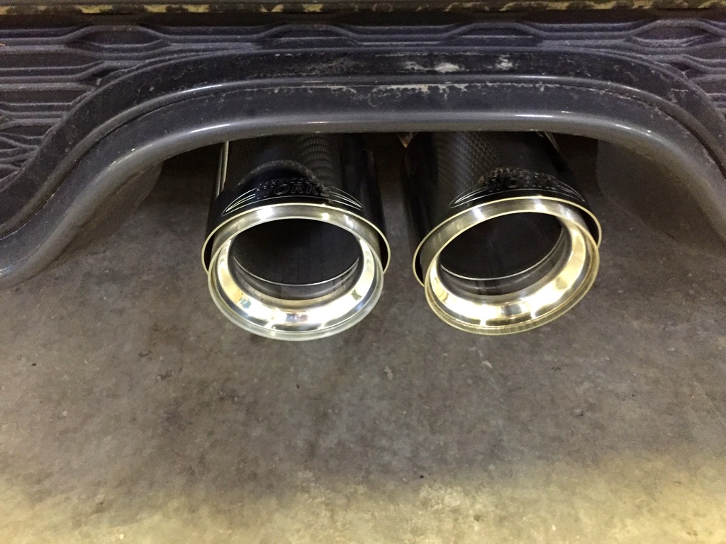

Do the tips look like this?
If so, look under the rear and see if it looks like this.
If all the above is yes, then you have the JCW Pro Exhaust System. Then all you need is to order the FOB controller and have it programmed. ~$280-$300 for the controller.
If it doesn't look like that then you're outa luck with the controller part.

Ok took a look at it and it's definitely like the one pictured. I will try contacting dealer tomorrow but I doubt they even know about it as they barely knew much about the mini in general.

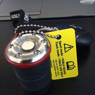

In case you haven't seen one this is what it looks like. It's about the size of your thumb.
I found it for $217 on line. Part # 18302413298. You'll still need your dealer to sync it with the car.
