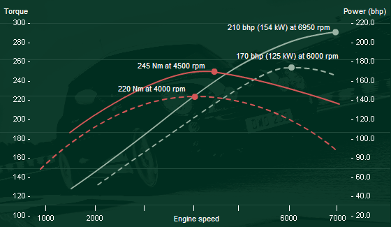

I would be really curious to see a dyno map of a 17% reduction pulley on a GP or factory JCW (or dealer install JCW for that matter). I am guessing a meaty increase in power up to about 6000, then a taper off to 7000.....since I am assuming a 17% reduction pulley isn't efficient at 7000 RPM (too much heat produced).
http://vignette2.wikia.nocookie.net/...20111202181919
